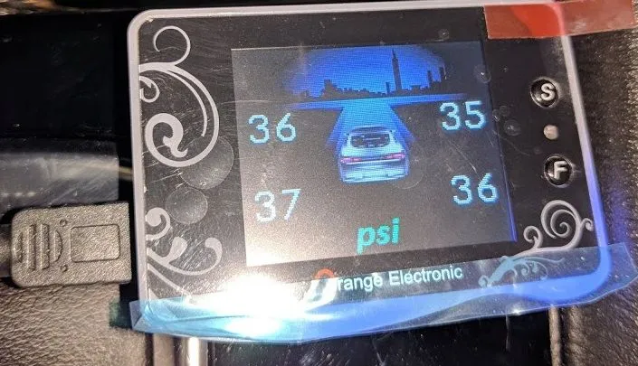

Here's a pic of it in operation:
attachment.php

Can you take a pic farther away?
NVM. Watched the video.

Thanks for the great replies. Before I pull the trigger on the receiver, how do I make sure that there is a TPMS sending unit on my 17-18 CX-5? Can the TS also post pictures of the tire valves?
