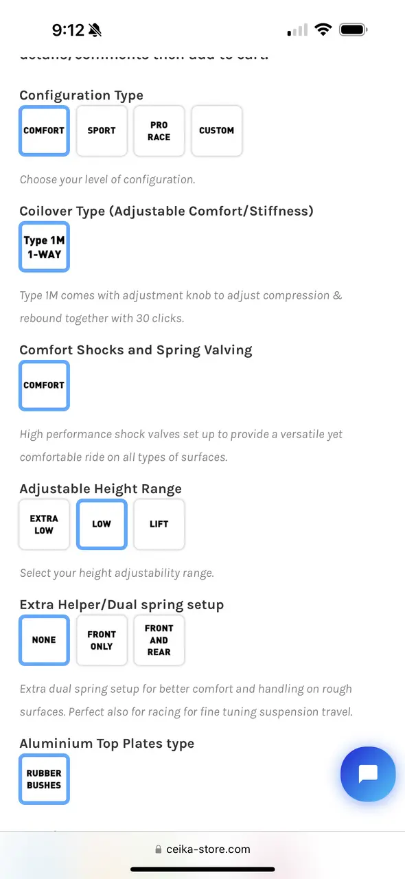

Speaking of coilovers, I’m currently trying to decide between BC racing vs Ceika M1. I’m dealing with some pothole ridden streets and lots of speed bumps which is making me consider Ceika M1 with a Comfort build (rennlist review). It sounds like BC and Ceika may use the same underlying parts and that Ceika are just more customizable.
Currently considering this setup - with comfort dampers dialed on the firmer side. Need to figure out spring rates and if I should get helper springs. Will have Hardrace front/rear ASB likely set to soft on both.
Any suggestions on spring rates and if helper springs are worth it?
I spoke with them the about the helper springs. The way they describe them is nothing like any other company. Normally "helper springs" just keep load on the main spring so it never comes loose at max extension. So idk if they are fos or if there's something different about them.
For spring rates, I'm eyeing 4K front, 6K rear. If you're doing sway bars, you probably don't want to go stiffer than that if this is a daily on city streets. Their default will be 6K/6K.
The only unknown to me about the rates is making sure it's enough to prevent bottoming out with a 2" drop.

I'm using Ceika's comfort coilovers. Id recommend those but with 5k springs on the front instead of the 6k they recommend and with adjustable end links. 6k backs are fine. It's no luxury cruiser but more comfortable than stock while still being stiff. It got rid of the highway front hopping and feeling every crack in the road. If that's not enough, I switched the 19s to 18s that can run thicker tires at a slightly lower psi.
Agree I feel the 6k f/r is a default of sorts. But in emailing Ceika and giving them info they are still stuck on trying to recommend those rates.
Emailing BC now to see what they say as they list their default rates at 6k/6k as well. Seem to be basically the same as Ceika. But Ceika offers a helper spring option for the fronts and BC offers supposedly better Swift springs at a +$320 premium.
