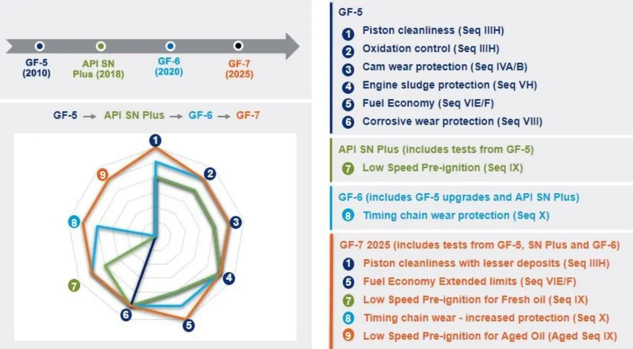

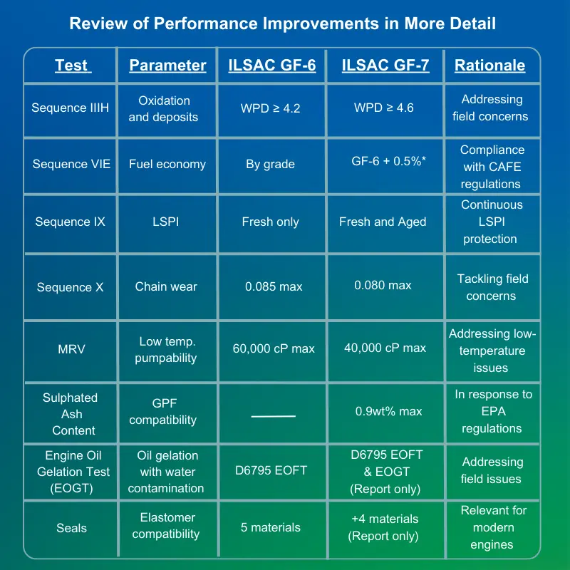

Sorry, I don't think you understood my post—use GF-6 oil, not GF-5. That is an old spec.
And as @dunhillmc noted, GF-7 spec oil is coming out this year. I'll use up the last of my current jug then look for the updated version next time.
Edit: found this:
