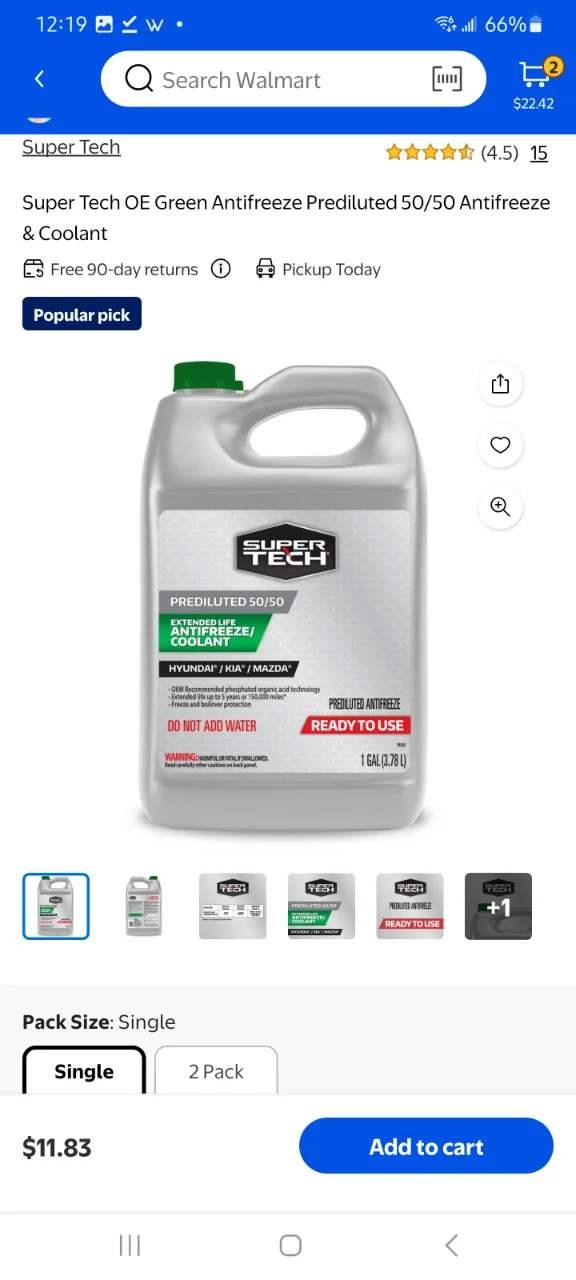

Then also now Walmart carry the Mazda Р-НОАТ ones too. $11 50/50.
I'm going with Walmart, I live life in the edge. Zoom zoom

But if this is true, it shouldn't be 50/50:
Mazda changed to the 55/45 mix a few years ago because of an issue with heater cores rusting
Ya, due th all the engine issue. I'm going to use "PEAK Original Equipment Technology Asian Vehicles Green Antifreeze and Coolant Concentrate", to make my own 55/45 mix. A bit more of an hassle. But whatever it take for my baby to be happy.
55/45 and 50/50 really ain't that big of a difference. But if you want to mix yours a little strong, meh. You still come out cheaper than buying pre-mix.

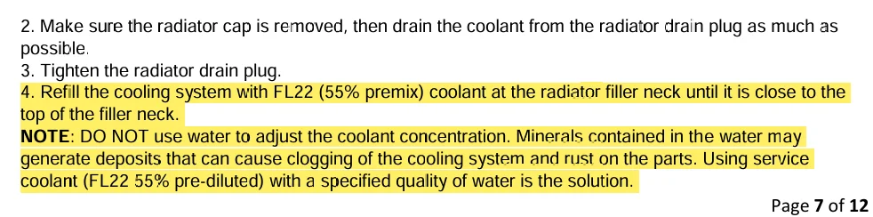

"To solve this concern, two mass production changes have been implemented.
a) The concentration of the coolant has been increased so that the amount of the contained anti-rust additive is higher.
b) The composition of the coolant has been changed (the ratio of the anti-rust additive has increased)"

TSB says all CX-5's. And on your older model, I would definitely make sure to use 55/45 since it is more likely problems will show up over time compared to a new model.
Also, not only did they change the recommendation to 55/45, they also increased the anti-rust additive. We have no way of knowing how much of this additive Zerex or Super Tech are using.

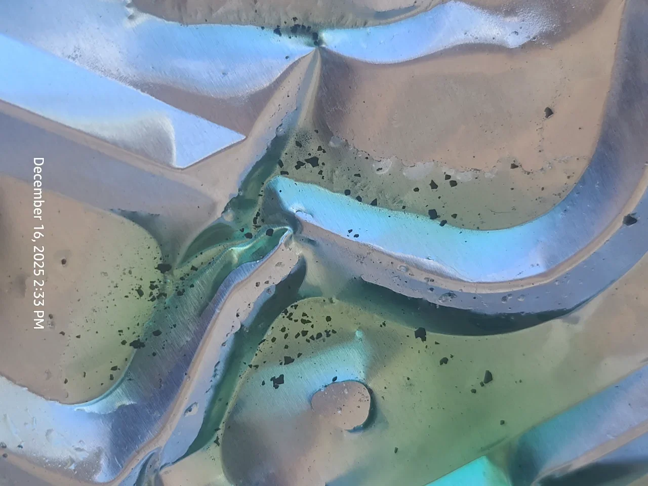

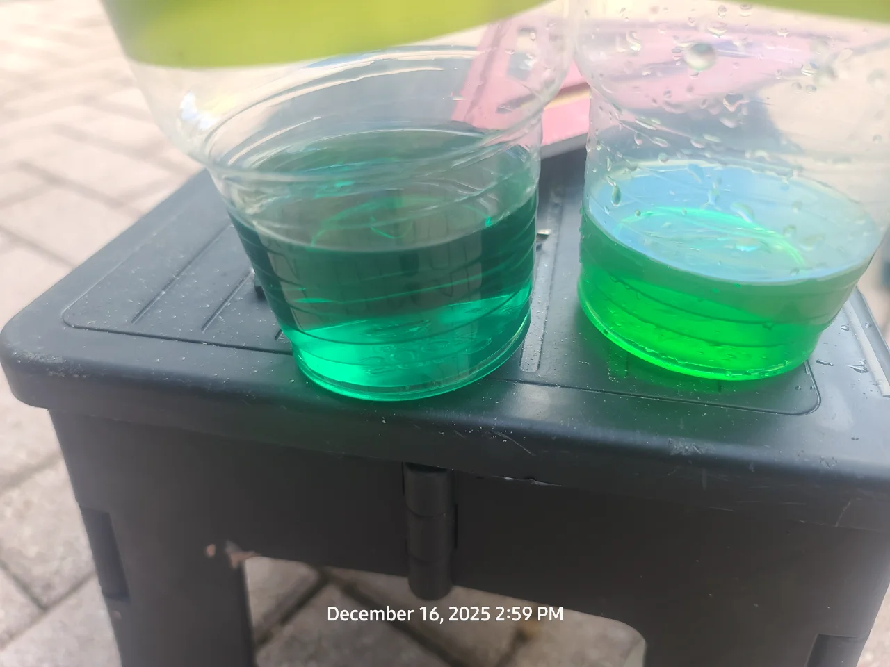

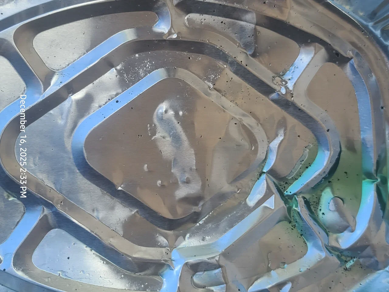

Hi, so I went with Peak Green. Was an easy job, it's a sky active 2016 cx 9. I did oem fluids one for wife's cx5 a few years back. The Cx9 was easier. I attached the photo of Mazda at 126k ( darker one) with my new Peak Green. I also attach photo of what's came out of the flush. I didn't bother flushing with distilled water. Since it would have mess my ratio up that I wants to archive in long run. Probably do another drain and flush at 140k. Only cost me $25.

I used the OEM Mazda FL-22 in the newer 55/45 formulation when I replaced the thermostat in my 2018 CX-9. Given the existence of a TSB that specifically calls out the use of Mazda's FL-22 vs. a prediluted alternative or a mixed from concentrate solution, I decided that I wouldn't take that chance. For the difference in cost and how often the coolant would need to be replaced, it's just not worth it to me.
