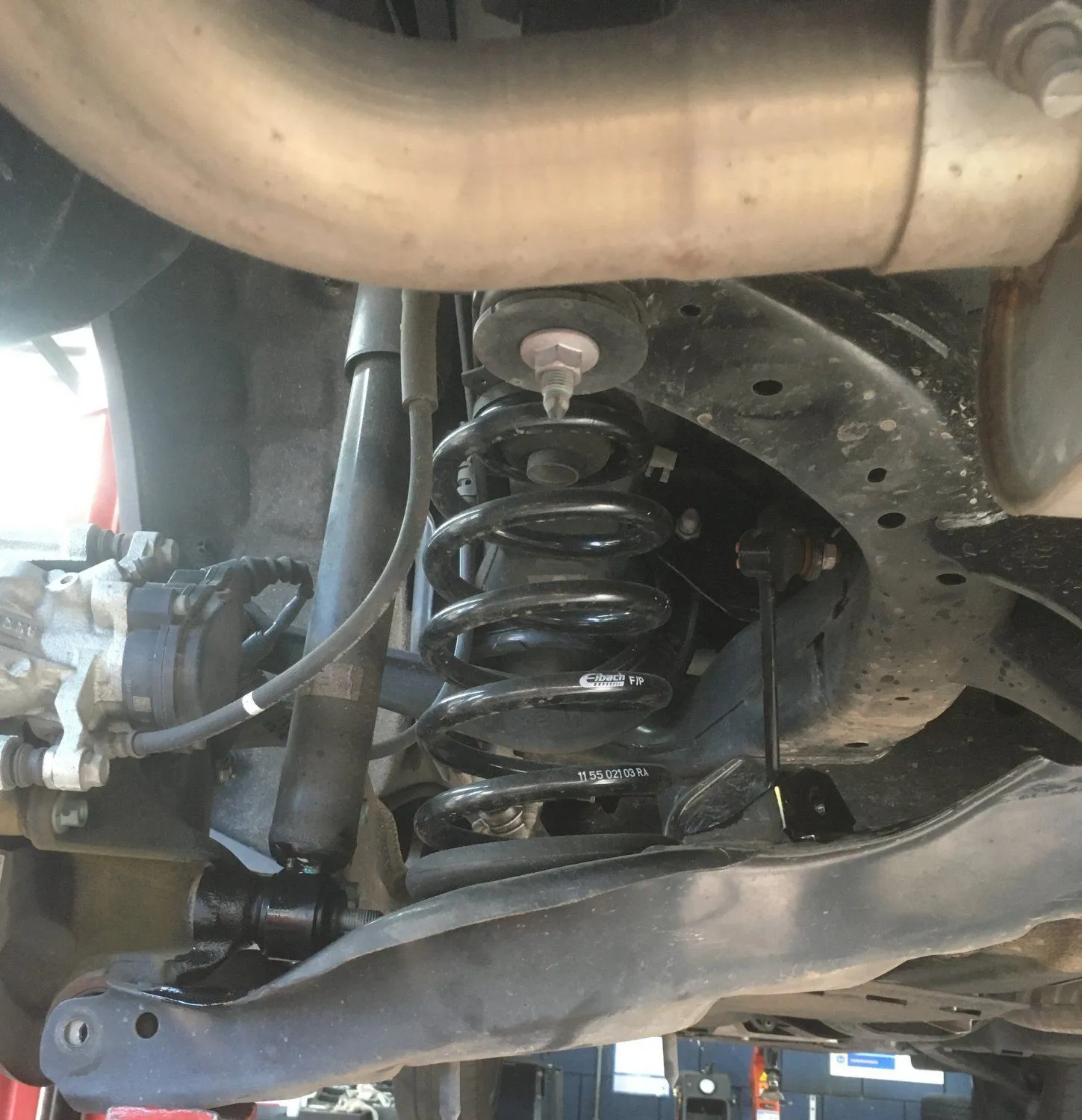

@shox75 I just did my installed. First time working on it by myself. I got the front down but the rear, how to you take the bump stop out to cut? I can get the shock absorber out then how do I pull it apart?
2017 Mazda CX-5 GT
The nut at the top, you loosen it. Impact gun helps with this. After you can pull off the top plate with bump stop.
