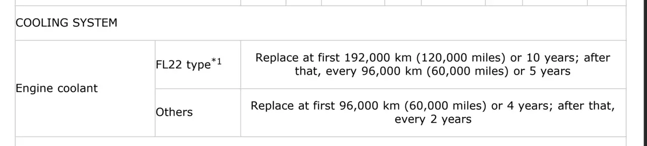

My coolant was drained by dealer back in 1/2019 @ 47,018 miles when my crankshaft bearing seal was replaced under warranty
So the 120k mile interval got thrown out the window.

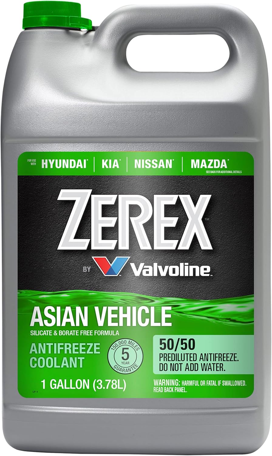

I did another roughly gallon drain and refill today. I just used some Zerex which was dark green like the stock fluid

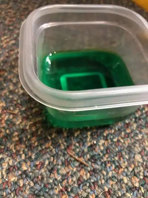

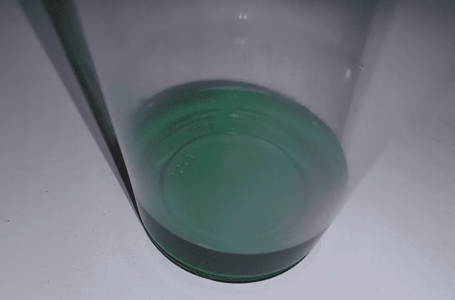

Is it possible one can no longer go off the color? This Zerex was a dark green replacement that looked like this color.. same as what was in recovery bottle.
Not my picture
This is where things go wrong. That coolant is light green, the same color as my factory fill. Dark green would be British racing green or darker:
images
It would appear then the dealer didn't replace with FL22 years back
This Zerex in picture was the same color as what was removed from vehicle

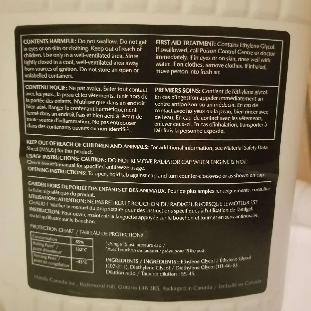

Here's the back of my Mazda FL22 coolant jug....
