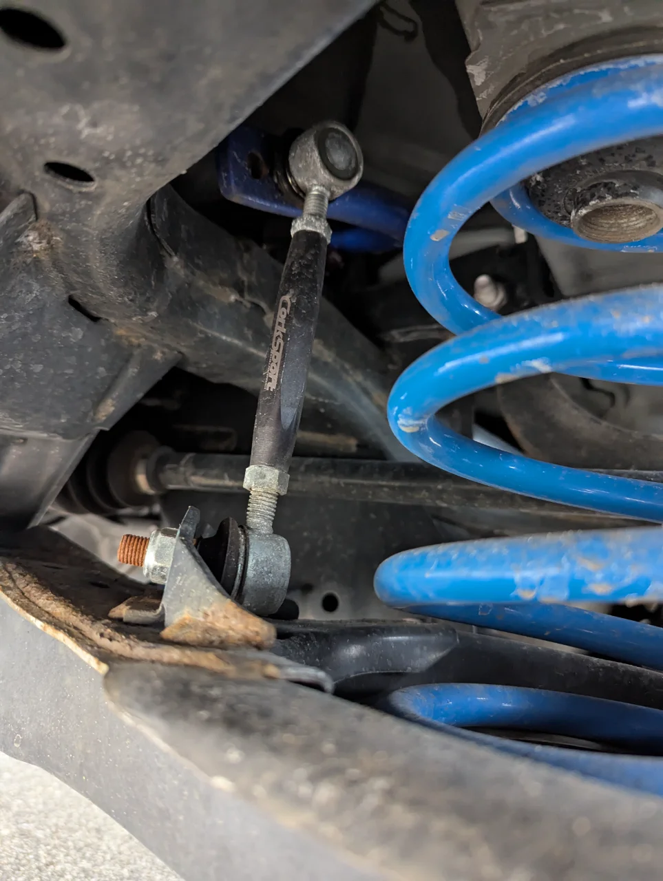

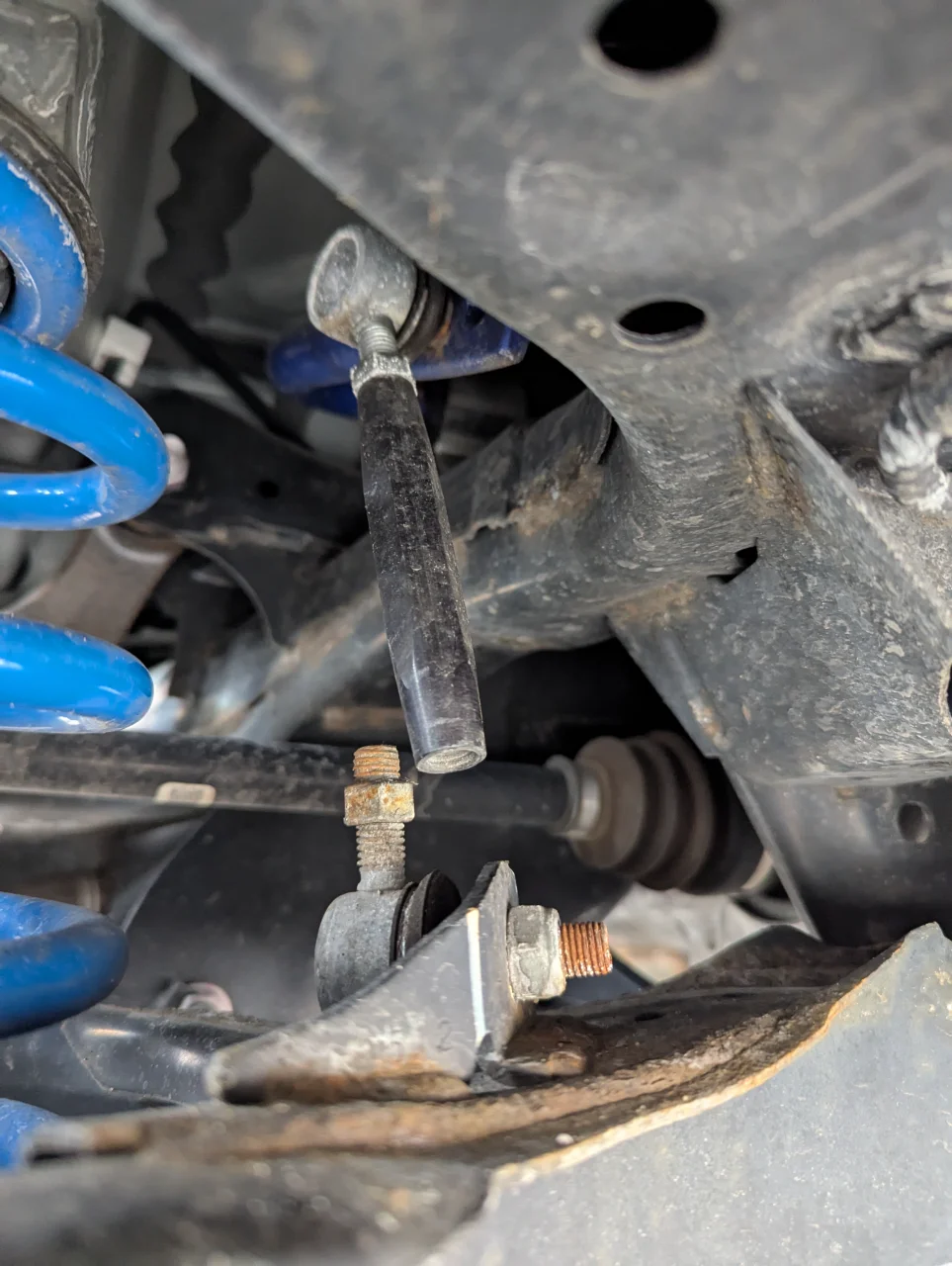

Just took a look under mine as winter has subsided for a bit. Apparently one of my corksport adjustable end links pulled out at some point!!!
Didn't think I drove THAT hard. But I do get a bit spirited on occasion.
Crazy.
Upon further investigation, we may not have tightened them enough threads. I only count 4 in the picture, and the instructions show 6 turns minimum. ...ugh...
