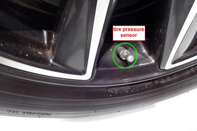

Thanks for the great replies. Before I pull the trigger on the receiver, how do I make sure that there is a TPMS sending unit on my 17-18 CX-5? Can the TS also post pictures of the tire valves?
Do you have TPMS on your car? If so, the 17 18 have direct so you will have a transmitter in each wheel. TPMS is required in the USA, is it required in your region?
One indicator is usually the valve stems. Often they are metal and have a nut holding them onto the tire. Mine has a visible nut on the valve stem. You may not see any threads, but the post by 7 earlier has a link to the whole module inside the tire with valve stem.

Here is a post from tomcat1446 showing the metal valve stem with built-in TPMS pressure sensor. If you see black rubber stem, you don't have TPMS pressure sensor in there.
Reducing air pressure on one tire won't work if you have cheaper indirect-read TPMS system. Do you see a TPMS button on the control panel next to the TCS and i-stop buttons?

just noticed, tire pressure sensors!! on the tire valve, ughhhh, hate these, had these on my old car, I much prefer the non-sensor type TPMS so can swap summer and winter wheels without worrying about initializing stupid sensors for each wheel.....2016 and previous don't use tire pressure sensors, I think it's based on rotational speed or the ABS system, not sure, but I know the stems are rubber with black caps for 2016 and previous years. The 2017 are stiff solid metal shafts with a grey cap which means tire sensor.

Can you see the picture of metal valve stem in tomcat1446's post I attached?
Just now. Yeah it's metal. Mine is rubber. [emoji22]
