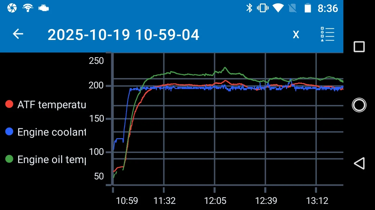

The plan is to switch to 5w30 and oem filter next. The oil temp is typically 210 for an hour-long drive and over 220 on long drives. ATF temp stays below 200 unless on steep inclines. Coolant temp can be as high as 214 in stop and go traffic. Did you mean using the app to log some data?
I've heard the oil temperature can continue to rise for several hours, but after 4-5 hours it should stabilize.

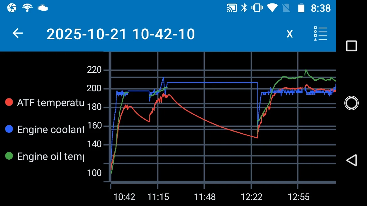

This is for my weekly 150 mile drive that takes 2.5 to 3 hours. The point where the ATF and oil temp peaked was one hour in and at the steep incline over 152 West.
This is from yesterday with the car parked for about half an hour (usps) and then two hours (labwork) in between. Engine oil temp is not read when the ignition is off.
