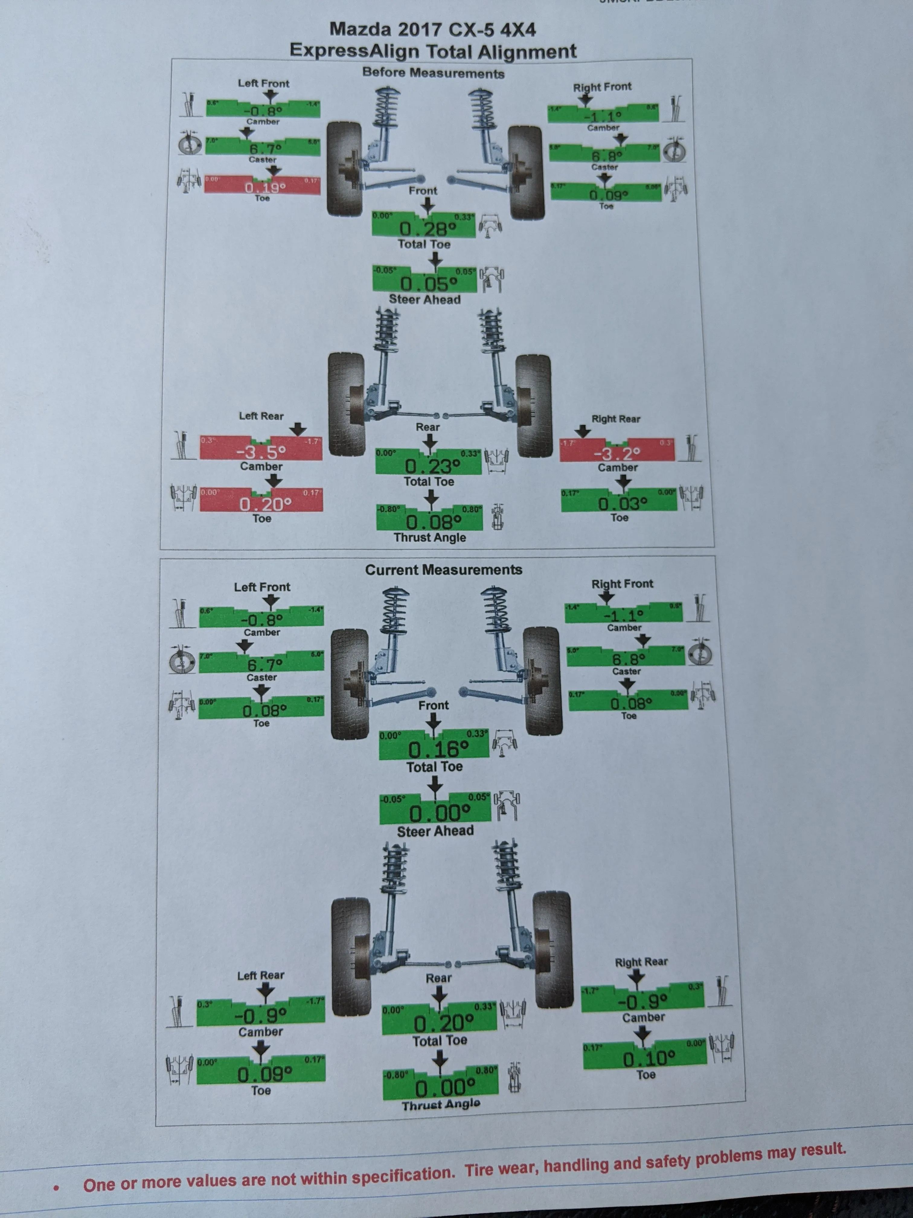

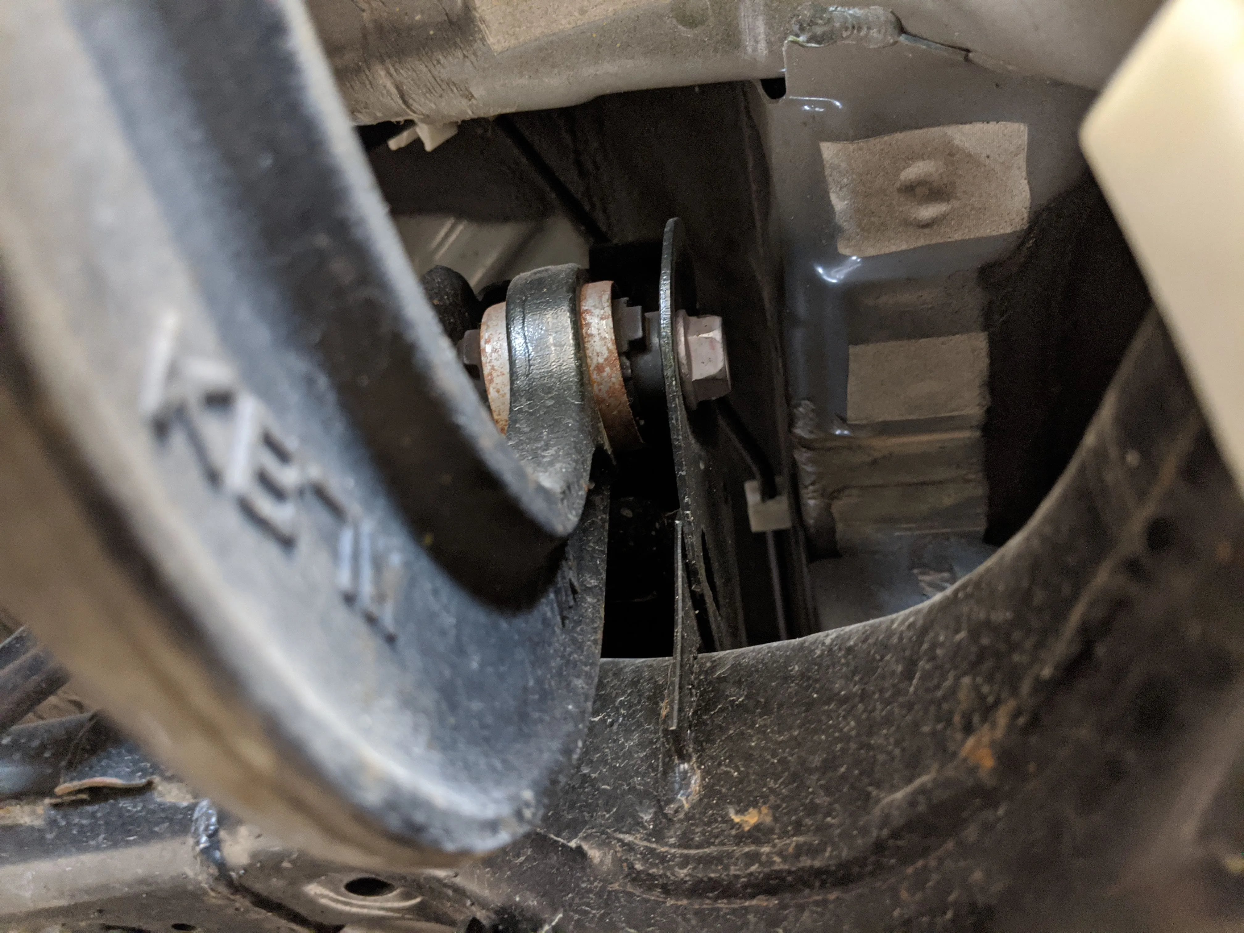

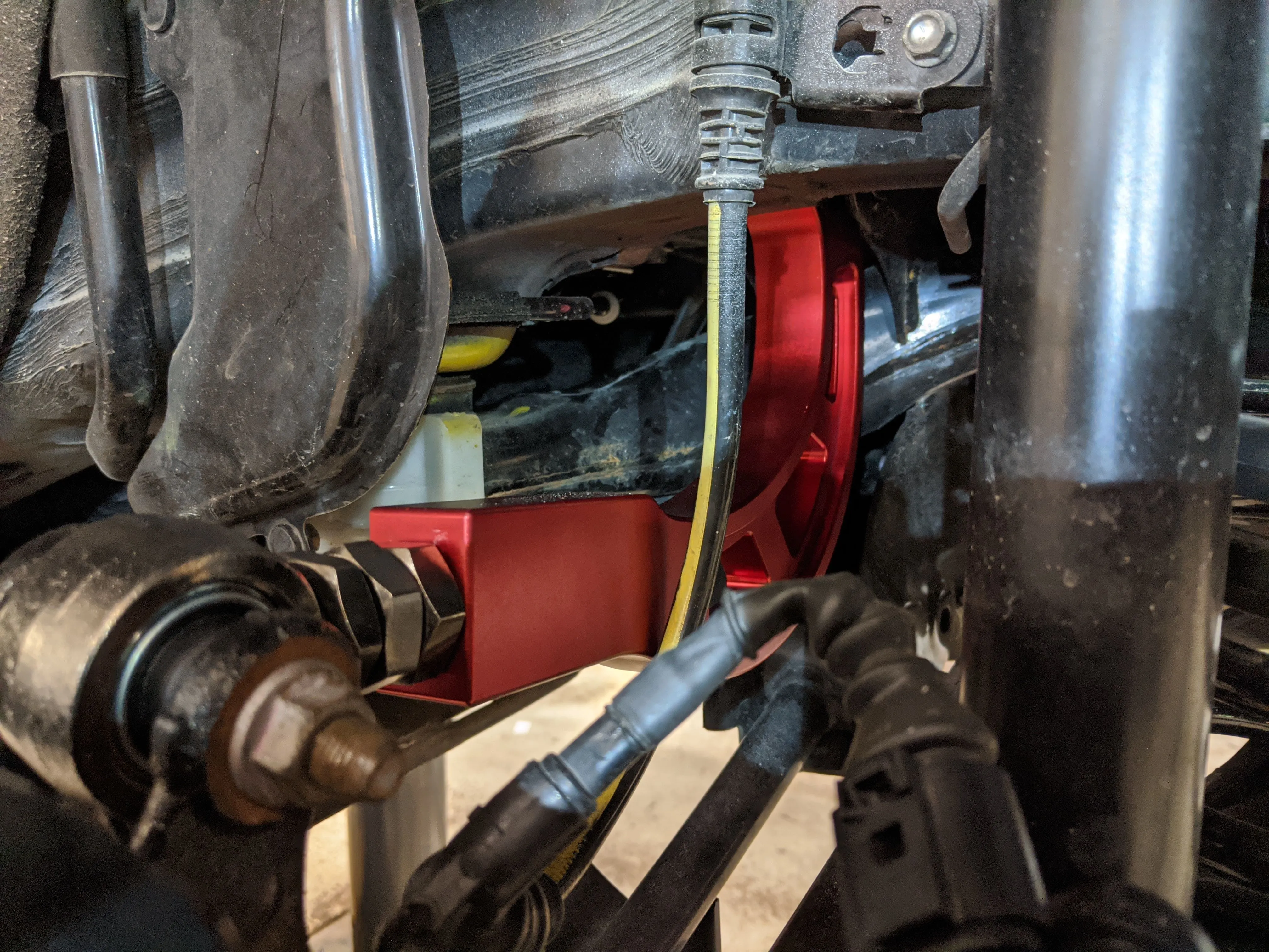

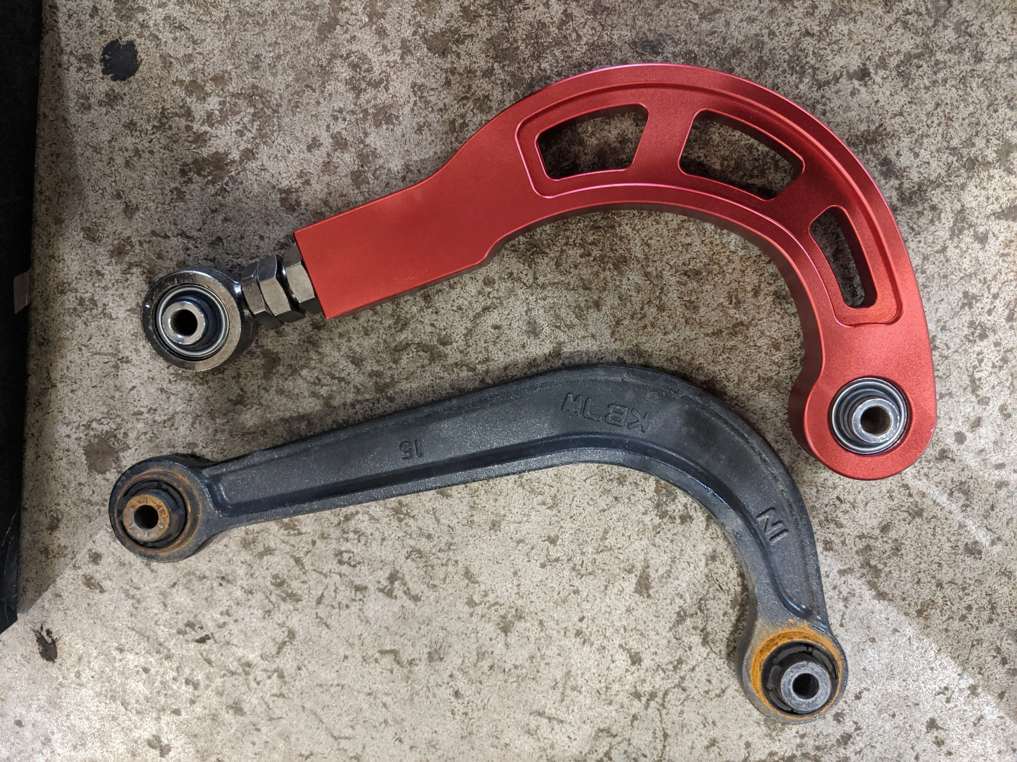

Here's an update. I installed the rear camber arms. 2nd pic shows the inside bolt clearance with the subframe lowered about 2". The alignment is now perfect!

And make sure you get an alignment afterwards as your toe will be out both front and rear. Also expect to need rear camber arms as in previous discussions to bring rear camber within spec.

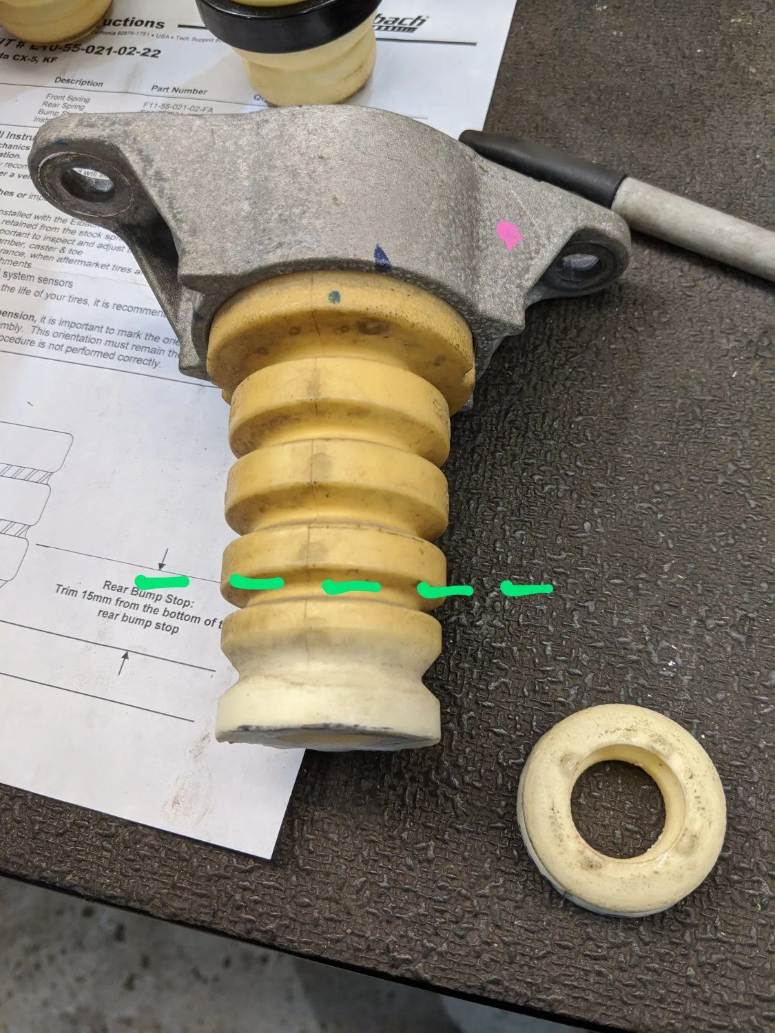

Can anyone comment on the ride quality after lowering there cx5? After a few months of driving, I'm not very satisfied with the ride quality. More specifically the rear. It is way more stiff then it needs to be, and the rear makes an annoying knocking sound over every bump.
Does anyone have a similar experience? More specifically with Eibach, but also H&R

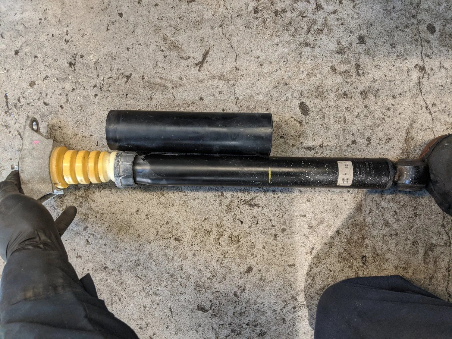

I figured out what the knocking noise was. The rear shocks were bottoming out on the bump stops! Actually, they were resting right on the bump stops, hence the harsh ride that was annoying me. I had to cut another 30mm more then the 15mm I had previously cut following the Eibach instructions to give the suspension some travel. No one else come across this???
The yellow marked line in the pic is where the dust shield sat before cutting trimming the bump stop.
@shox75 so trim 45mm instead? Does it make the appearance dropped more or is it simply for ride quality?
The ride height didn't change, it's the same. But the ride quality is now even front to rear. Before it was too stiff in the rear (bouncy) because the suspension had no travel. 15mm was not enough to trim. I basically cut 2 more rings off the bump stop after the initial 15mm. So yes approx. 45mm total.
