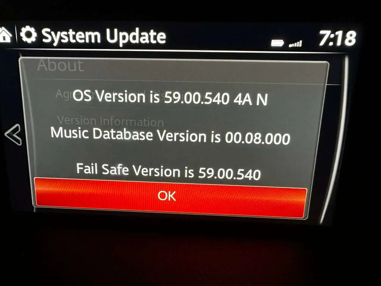

Hi all,
I have a 2018 CX5 KF series with firmware OS version 59.00.540 4A N / Fail safe 59.00.540. I read the guide by ASH8 and it looks I need to update it to 70.00.100 first, and then to "4A N_70.00.367A".
Now my question is, does this 70.00.100 need to match my region? I am based in Australia. If yes, what is the complete firmware name?

Much appreciated. Thanks.

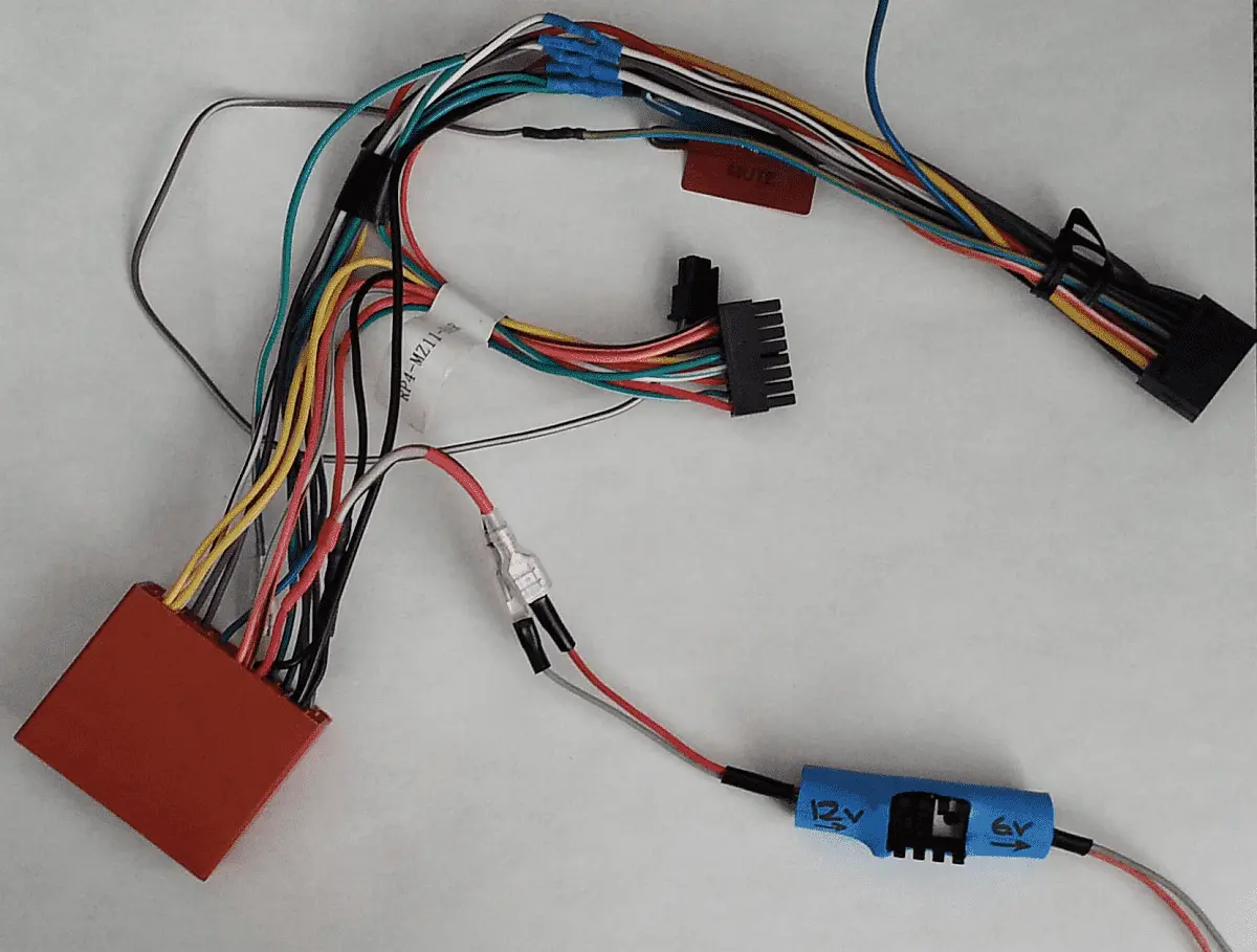

I replaced my 2014's with a Kenwood system myself. Not too difficult, you just need to get the correct interface module to keep the steering wheel buttons, etc. ONE THING YOU SHOULD NOTE: when you replace the factory head unit, you will lose the ability to configure things through the head unit (like press door unlock once or twice to open doors, etc). So make sure you have everything set up exactly the way you want it to stay (forever), before you bring it in for the swap.
Well, I cannot guess what your Mazda dealer would use, but if the dealer has "not been able to describe what the upgrade system will have or look like", I would stay away!
I am probably an average DIYer these days. It looks like the biggest part of the install is being patient while you detach the car dash parts. What level DIY skill do you think is neccessary
Well, it was many years ago, but I didn't think anything was that complicated. A lot of the dash just unclips (see first couple of pages of attached pdf - included since photos have gone from that original thread.).
However, after I started looking back at my saved links and pics, I remembered about a lot more complexity with the wiring (for reusing Mazda microphone, usb port and factory rearview camera, etc) so may have been looking through rose-tinted glasses :)
This may dissuade you, but remember, the car installers will probably not do a lot of this stuff, and simply not reuse the mic/USB/camera.
Tips threads here:
...and lastly, my "plug and play" radio harness:
