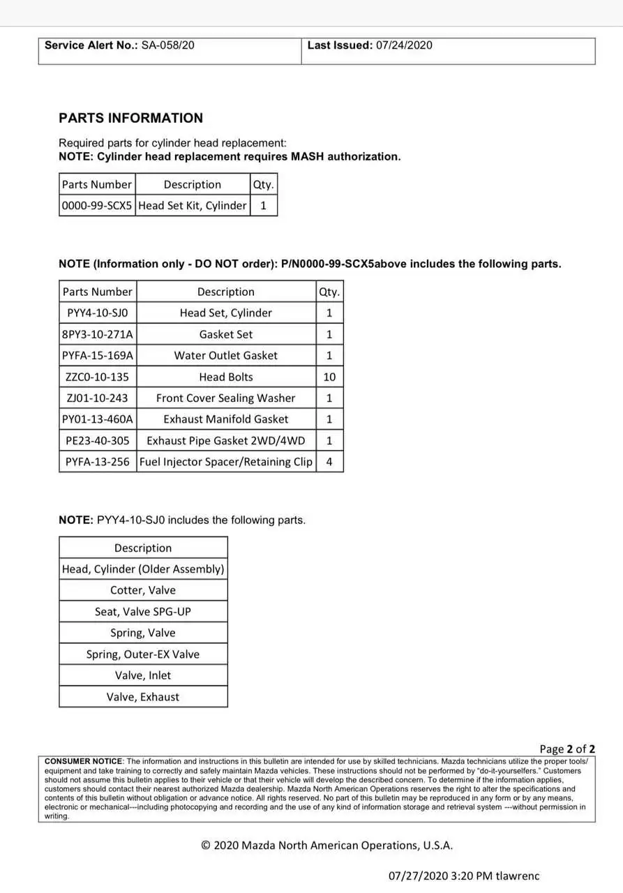

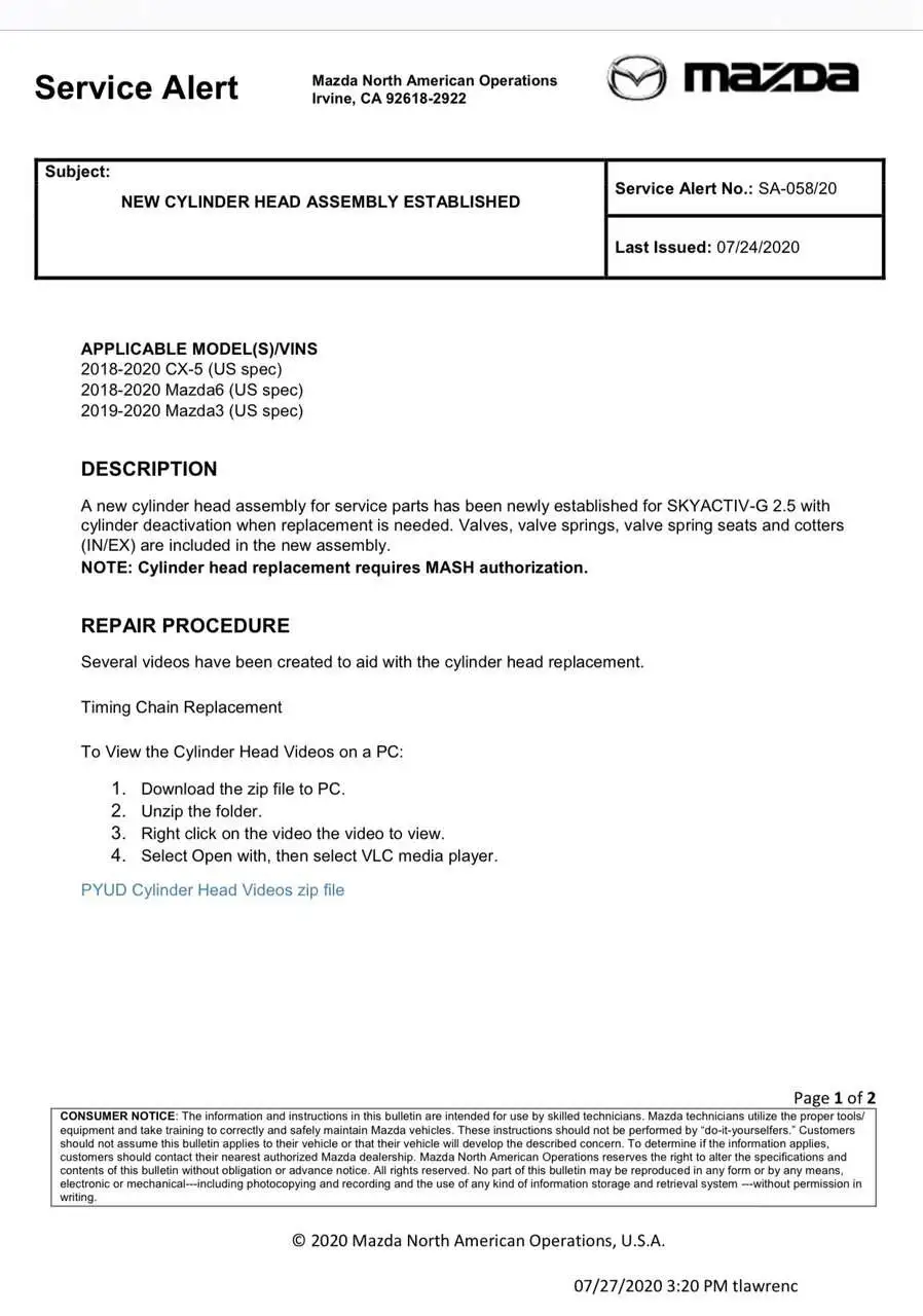

Based on the first Service Alert, SA-058/20, the PYY4-10-SJ0 is the new cylinder head set which includes cylinder head, (previous head assembly, PYFA-10-100F)、valve cotter、valve SPG-UP seat、valve spring、outer-EX valve spring、inlet valve、exhaust valve. P/N 0000-99-SCX5 then includes PYY4-10-SJ0 cylinder head set and many other parts including gaskets and head bolts. In the latest SA-037/23 the head bolts are no longer in the parts list for head replacement, hence P/N 0000-99-SCX5 which includes head bolts may no longer been used.
NA CX-5 with Cylinder Deactivation Engine Repairs - Report In
If you read the original Service Alert, SA-058/20, it explained it very clearly that PYY4-10-SJ0 is the new cylinder head set which includes cylinder head, (older assembly, should be PYFA-10-100F)、valve cotter、valve SPG-UP seat、valve spring、outer-EX valve spring、inlet valve、exhaust valve. P/N 0000-99-SCX5 then includes PYY4-10-SJ0 cylinder head set and many other parts including gaskets and head bolts. In the latest SA SA-037/23 the head bolts are no longer in the parts list for head replacement, hence P/N 0000-99-SCX5 which includes head bolts may no longer been used.

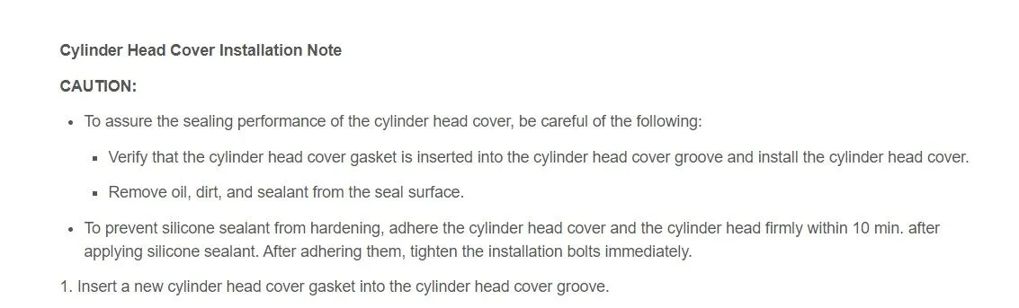

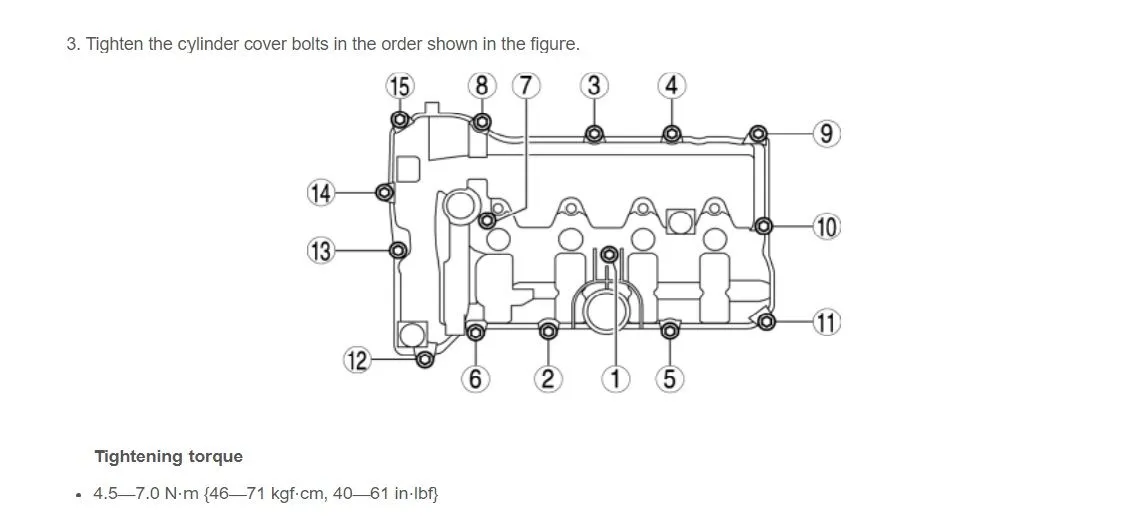

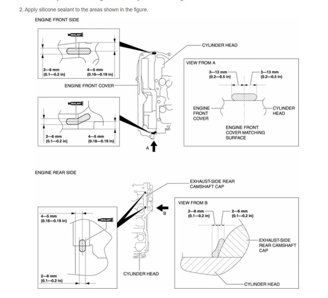

The leak is from the valve cover gasket.
They added extra 250 miles! Of course, the tank was filled and had a loaner for the full time.
Yes high temperature silicone sealant needs to be applied at several joint locations during valve cover gasket installation. I bet the tech didn’t apply the sealant properly at first which caused the oil leak.
Somewhere upthread I though I saw a comment that the cylinder head being used for replacement on my 2018 head that cracked in February have not been revised with a better improved casting. I seem to remember from either Mazda USA or the dealer service writer stated that the head had been updated to a newer design. Can somebody clarify my the head is a newer part?
No, the cylinder head itself has airways been the same on the 2.5L NA with cylinder deactivation since 2018. MNAO did create a new part number for a complete cylinder head set with valves and other things pre-installed to shorten the labor time of head replacement. See post #588 above.
