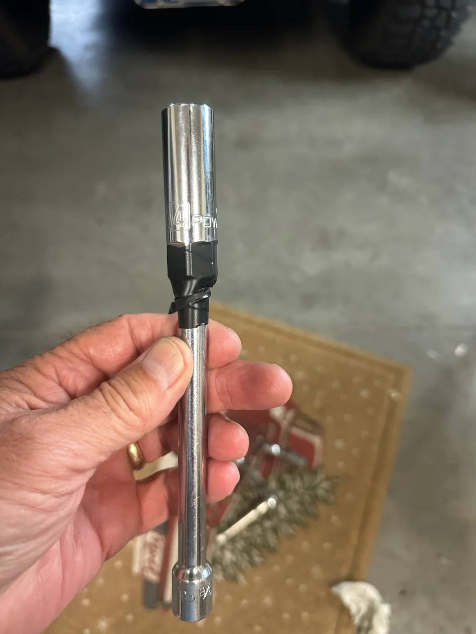

with cheap sockets/extensions, taping them doesn't sound like a bad idea... if you like to invest in tools, a one piece spark plug socket integrated with extension or locking extensions works way better

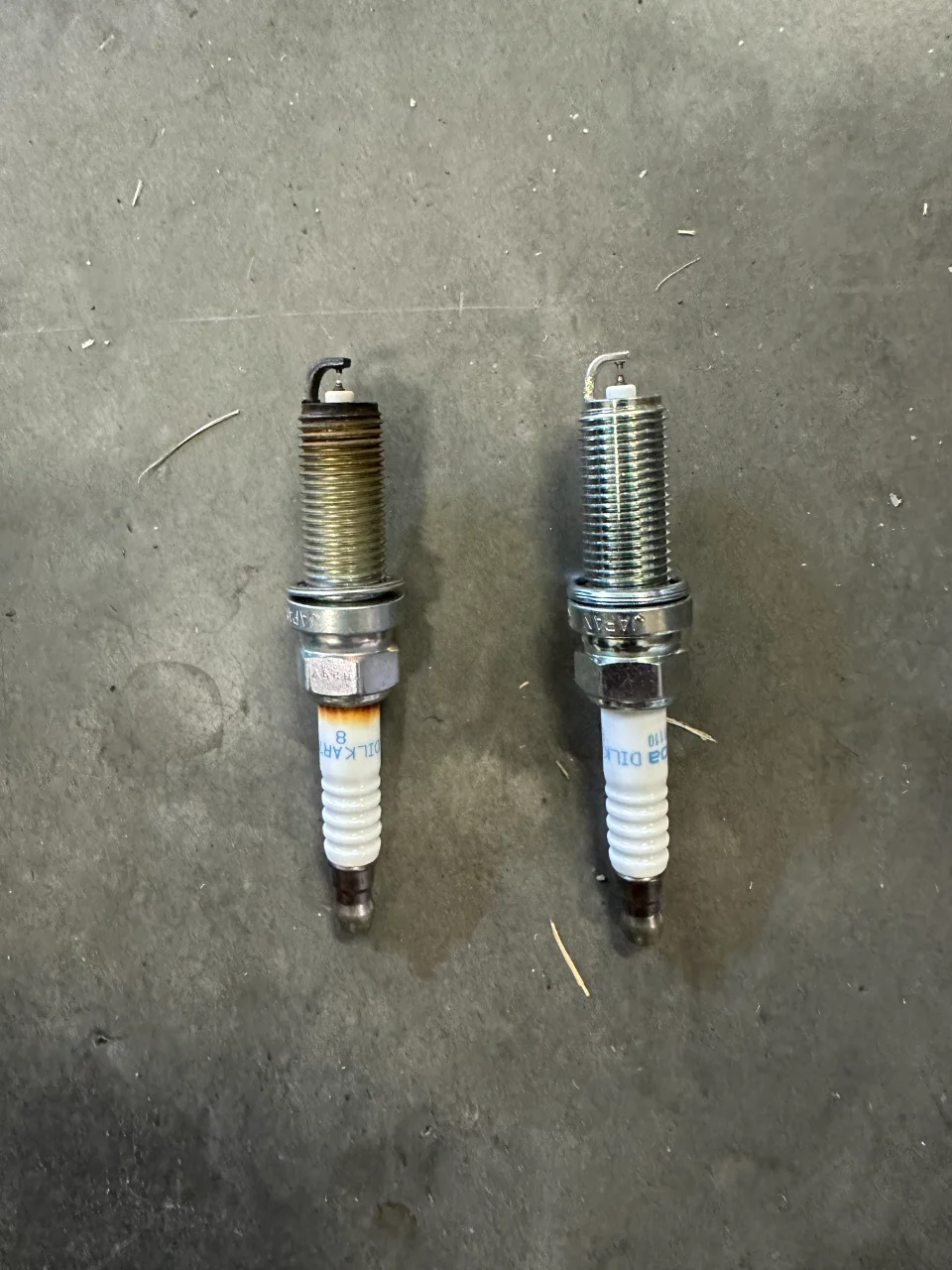

These came out of my 2017 CX-3 recently. They tell a story about the car which claims 40+ mpg. The burn ring is normal, I was told by strangers on the Internet, as the factory set came out the same way. Notice that only one of them has clean threads? I hand-tightened them and failed to apply force evenly. The threads seem wet/oily? It's another issue that I need to address. 🤦 The NGK plugs were from O'Reilly's. While I prefer shopping at Amazon, their generous return policy means that sometimes USED items re-enter the inventory. I have received an used oil filter that was wiped clean, and ignition coils with seals broken on the boxes, both sold as new, not from Amazon Resale.
I'm not sure you can judge whether they were properly torqued by how clean the threads look. They seal on the captured crush washers, not the threads.
Some vehicles can be quite a pain because you have to remove the intake. This is not one of those vehicles.
The only thing I'd say to watch out for is that new spark plugs feel kinda weird when you first torque them down as they usually have a crush washer. They get kinda tight but then don't immediately go tight right away like a normal clean bolt does.

I just took about 45 minutes and changed my plugs...they looked really good at 39,000 miles...I could have probably left them in for another 10,000 or longer but once I pulled them I just went ahead and changed them. I ordered my plugs from Mazda swag so it ended up costing me $108 and 45 minutes...super easy to do and no rubber hose needed :). just a 14mm spark plug socket and an extension....

I think one of the reasons plugs need to be changed is that the metal electrodes erode to the point that the gap is too large to make the electrons jump it, so no spark. Can you tell any difference in the size of the gap between the two plugs?
no difference..both would pass a .028 wire feeler gauge and neither would pass a .030 wire feeler gauge..I am guessing both would pass a .029 but don't have one of those.
