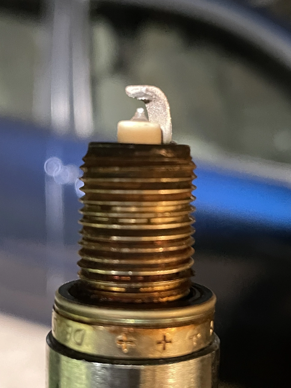

Again - I have no drop in gas mileage, and my engine is running smoothly. By all indications, neither electrode has started to erode, as I would expect from a platinum/iridium alloy.
What’s the purpose of replacing a “wear item” that is giving no indication of having worn?

that factory original denso iridium plug came out of our corolla at 105k miles... toyota recommendation is 120k miles... car ran fine with "no drop in gas mileage"... no check engine light, no codes, no rough idle, no out of ordinary issues... you want to bet 20 bucks that yours looks worse than that?
