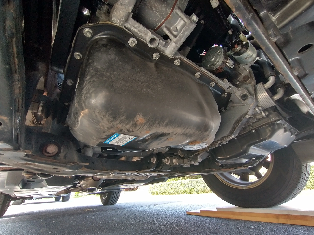

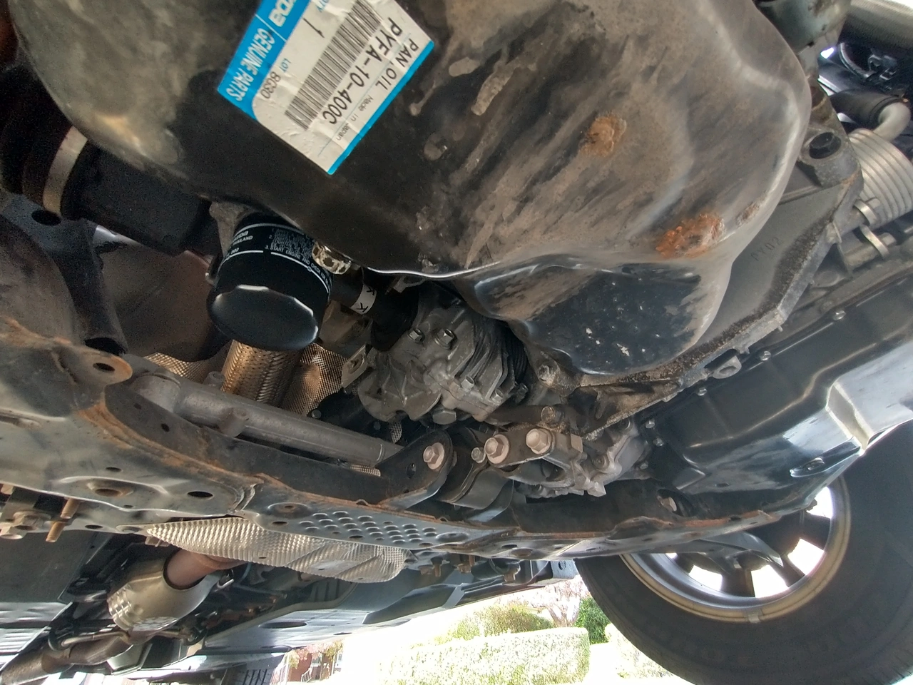

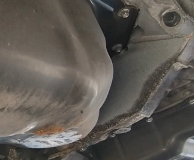

Aww man, I got ripped off. Don't have one of those spiffy stickers on my oil pan.Just hit 91,000 miles, seems like relatively low miles compared to some others on this post. Just did a trans fluid drain and fill and changed engine oil (5w-30). Was impressed with how dry underneath looked. Looks like I'm going the distance with this one.
View attachment 331460View attachment 331461

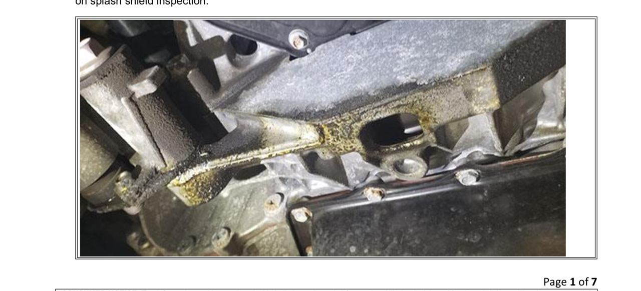

It's not residue, dry as a bone there except for the corrosion. Been like that for years.Madar: You have that oil residue on this area that required a rear main seal replacement on mine
It was never enough to cause noticeable oil drop on dipstick though
I’d clean up and see if it comes back. Mine would reappear until RMS was replaced
Looks like I will paying the dealer a visit. I noticed some of this residue when I changed my front diff and cleaned it up as well. I thought somehow it was leftover from oil change. Apparently not. Nothing big enough to accumulate on the floor but you won't see it unless you drop the front under-shield. Not hard but just a lot of screws and fasteners. Sorry for big pics... may not be easy to see on phone.
