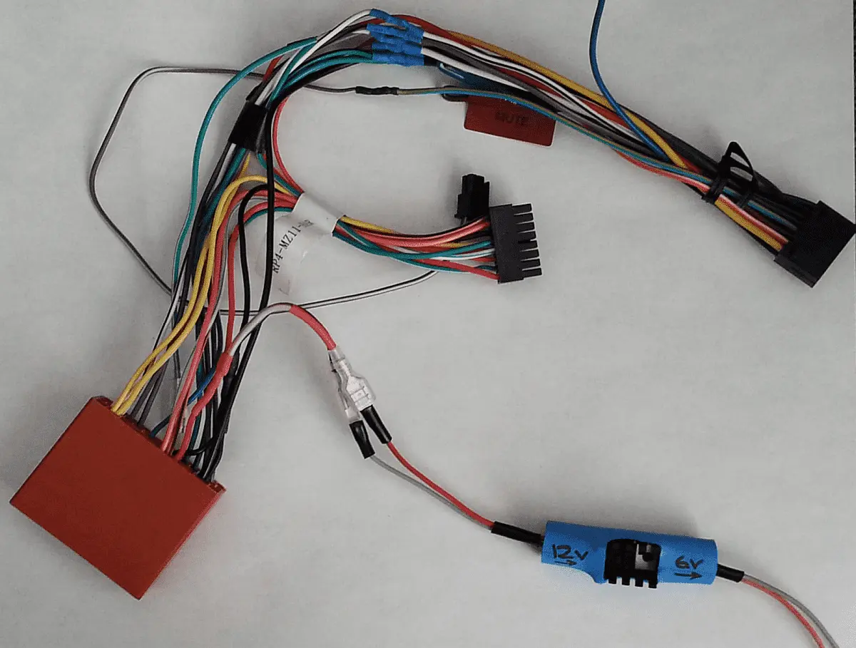

However, after I started looking back at my saved links and pics, I remembered about a lot more complexity with the wiring (for reusing Mazda microphone, usb port and factory rearview camera, etc) so may have been looking through rose-tinted glasses :)

...and lastly, my "plug and play" radio harness:
