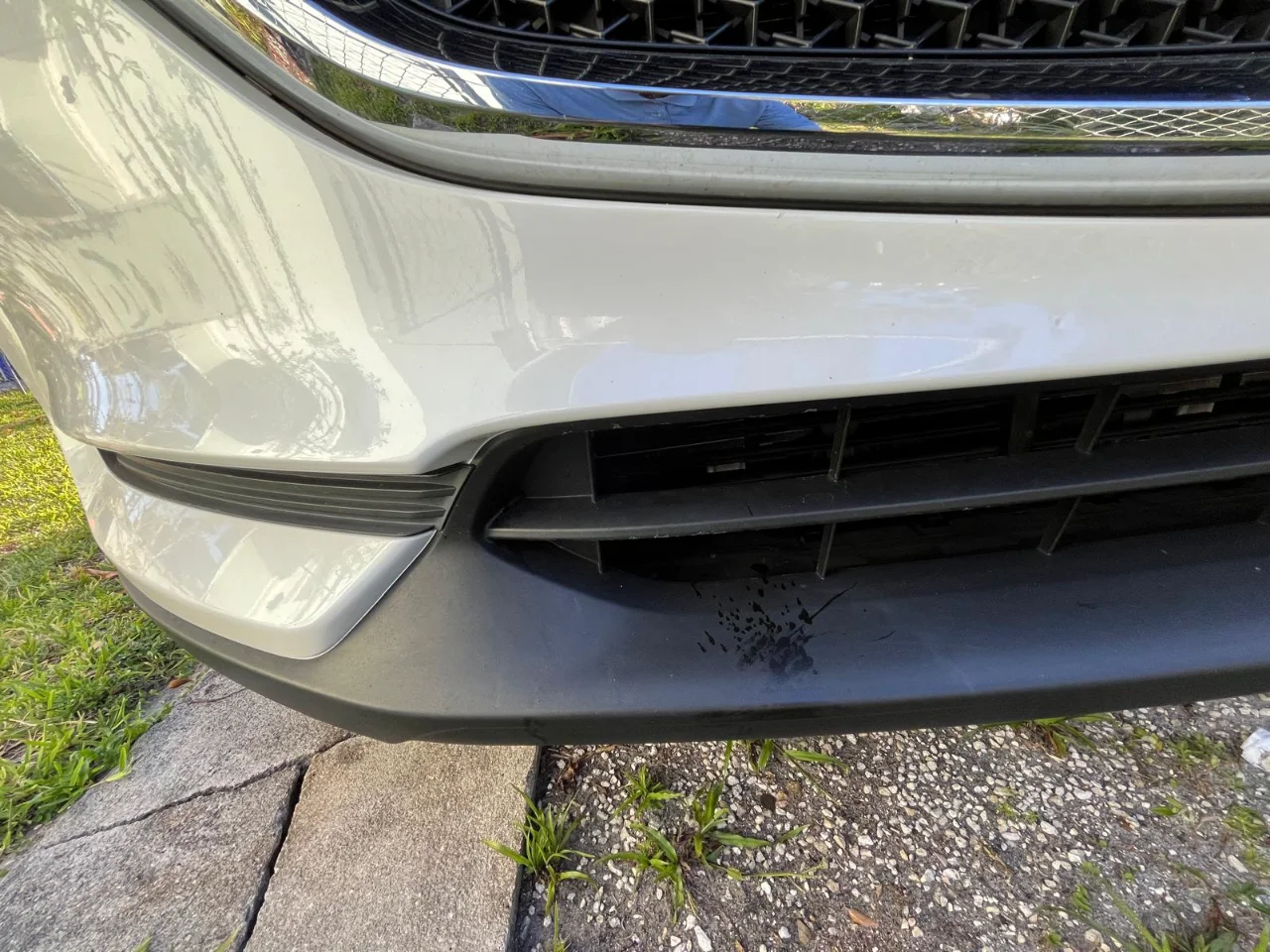

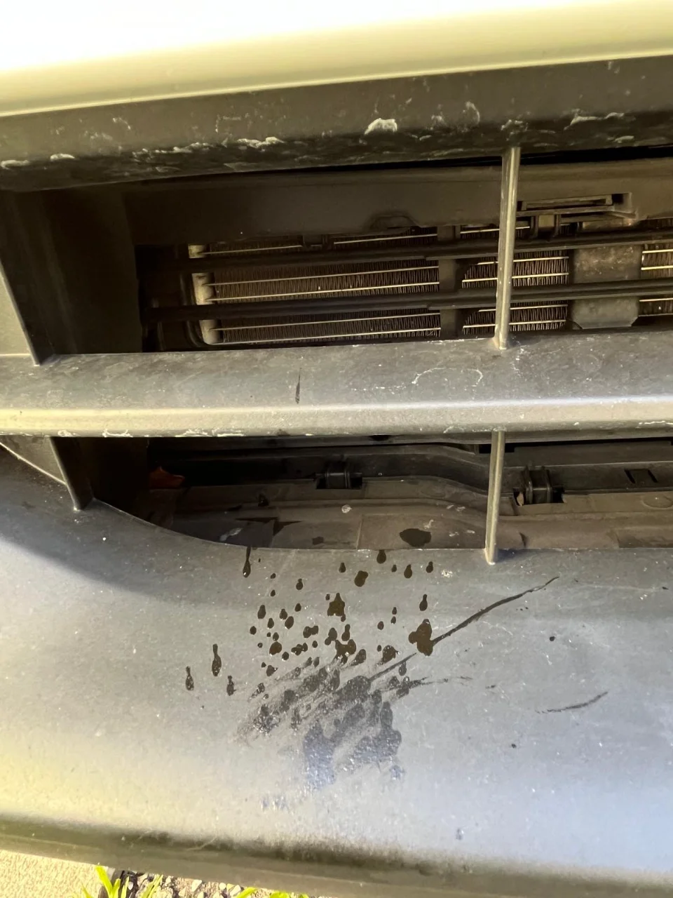

My brother's 2021 CX-5 Sport with 2.5 NA engine was showing some leak in the left front bumper area (black part). The car only has 22,000 miles on it and had a oil change done in January at the dealership. He noticed some and spots appearing recently and he wiped it off with a paper towel and it looks like oil.
Took it to the dealership this morning and they spent almost two hours looking for the source of the leak and they could not find it. So, they cleaned it up underneath and said everything seems ok with it.
Here are some pictures. I am sure he will have to now start monitoring this. Could these be symptoms of the cracked head issue?

I thought I posted a follow up but apparently I didn’t. The dealership spent a day trying to find the issue. Pressure tested the cooling system and found no leaks. Checked the coolant for exhaust gases and found none. Did some sort of chemical test on the oil and found none coolant. Turns out, there was an air pocket in the cooling system causing my overflow tank to drain, and what I was seeing on the dipstick was the dye they added to the oil after the cylinder head was replaced to check for any oil leaks. They purged and topped off the coolant and went ahead and changed the oil.
Watch it closely. Dont trust them. My experience is when they have a certain amount of hours in it and no one is getting paid they will push it out the door till next time it comes back. I'm not out of line in saying this cause I've had it happen to me more than once. In your case basically they, the trained techs, did not purge the system as trained.
Not trying to worry you but we just gotta be our own advocate with these dealers.
My brother will keep monitoring if this leak turns up again. He has one year left on the power train warranty. Should he show the dealer the service alert if he sees the oil leak again?
According to the carfax the car was manufactured on 4/8/2021 and first purchased on 6/4/2021.
