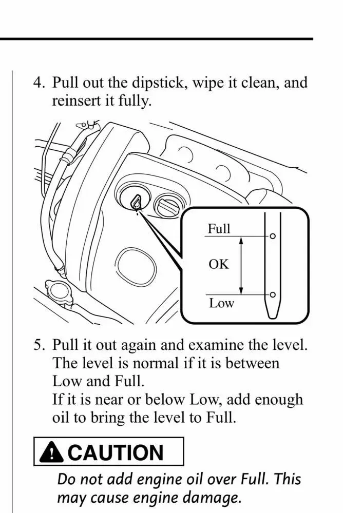

My 2016 CX-5 owner’s manual says:
And it also says “If it is near or below Low, add enough oil to bring the level to Full.”

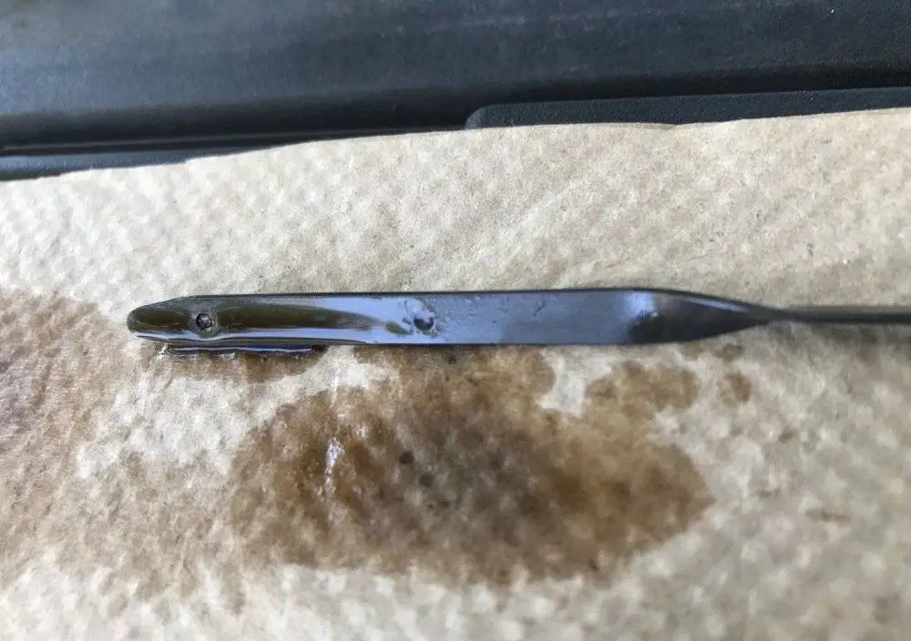

The idea of keeping the fluid level to Full is to have a better safety margin. My recent experience of leaky drain plug after an oil change by the Toyota dealer on my 2018 Yaris iA from Toyota’s free 2-year maintenance almost ruined the engine if the dealer didn’t overfill the oil a bit!
Oil has sight expansion when it comes to operating temperature so what you read cold will likely be different hot.
Yes warm oil expands a bit but more oil will be drained into the oil pan when oil is cold. These 2 factory basically offsets each other and the result is the readouts beteeen warm and cold oil are about the same on the oil level:
Warm:
Cold:
And taking the oil level cold is a lot easier to see the oil on the dipstick.
I should mention I have read that the oil quantities were established on a complete new and dry engine.
If the 4.8 quarts stated in Mazda’s manual were established on a complete new and dry 2.5L engine, the oil level would be even below the mid point of Full and Add marks if we use specified 4.8 quarts for the oil change.

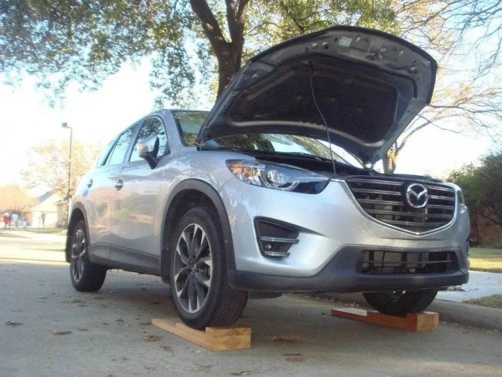

Your guesses unfortunately are mostly wrong. I use a very low self-made 2X10 “ramp” just to raise the CX-5 front a bit:
I usually wait the oil draining for about 20 minutes on a warm engine until the drip isn’t in a constant stream but still dripping.
And I put in ~5.25 quarts of fresh oil right after I put the new oil filter and drain plug back, as I’m certain from my experience the oil level will be at the Full mark hole on the dipstick when I check the oil level cold the next morning.
And I always believe checking the oil level the first thing in the morning is the easiest and proper way based on my experience. And the oil level checked will be very similar between cold and warm as evidenced by my pictures showed. Yes, oil will expand a bit when warm (but not that much like the ATF), but so as more oil will be drained back to the oil pan when oil is cold.

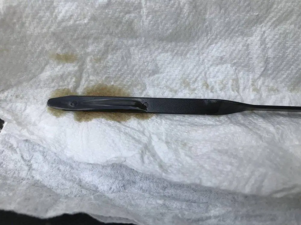

Mine shows about 1/2 quart low after 4.8 quart change. I changed on ramps and let it drain for over an hour.
It basically took 5.3 quarts to get get it exactly at the top dot. I must have really drained it out.

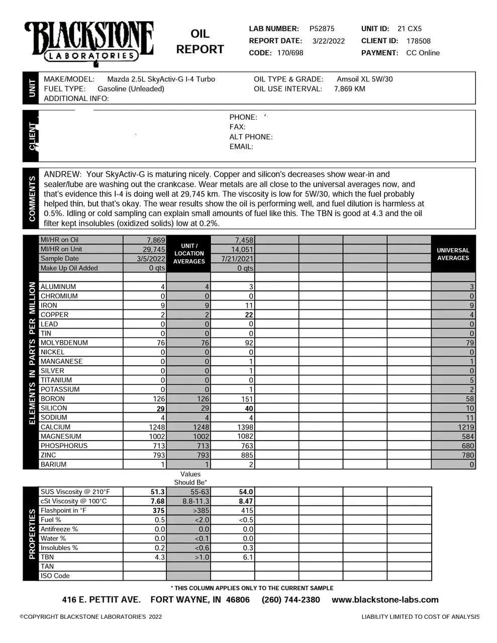

Latest UOA on my 2021 CX-5 Signature @ 30k. Did a fair bit of idling this winter with temps getting below -40°C on several occasions. Amsoil XL 5W-30 seems to handle the severe cold pretty well. I'm using the Made in Thailand Mazda OEM filters, which also seem to perform well.
