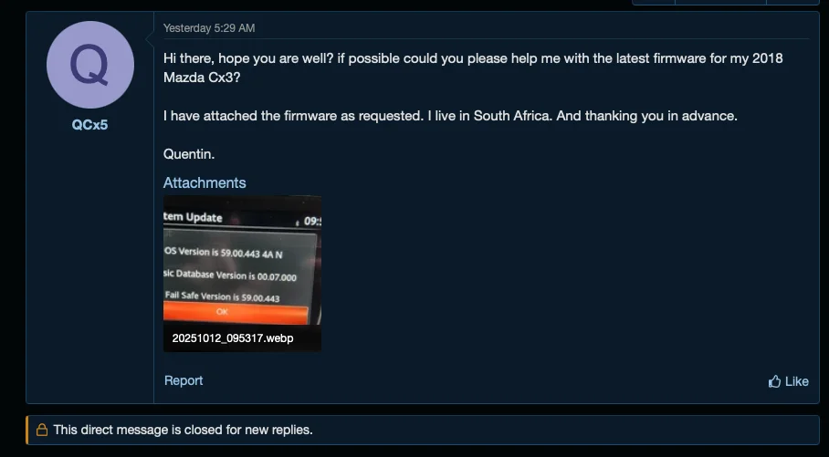

Hi I too, am gently asking not pushing to see if you received my dm's? Thanking you in advance.
I got your message, but you also locked the thread not allowing me to respond to you.
I sent the firmware in your second request from a half hour ago.
