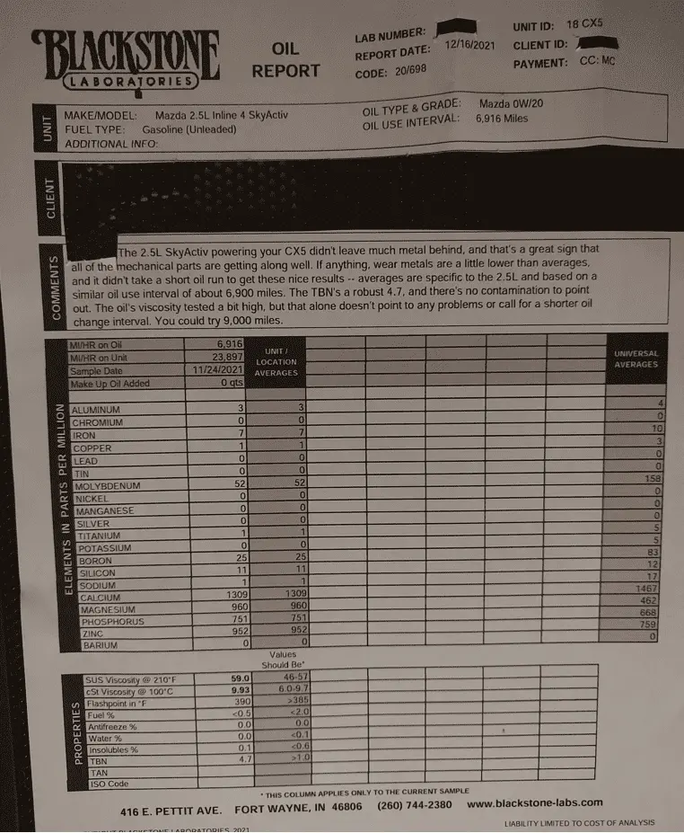

Here's the report showing the low Moly / high viscosity so the dealer definitely didn't use Mazda oil despite that showing on the invoice. Who knows what they put in there ? and they wonder why some people won't go back to the dealer for service? The Blackstone report identifies the oil as Mazda oil only because I provided that information as per the dealer invoicing.
The oil viscosity isn't a bad thing. Your engine seems to be in great shape. They suggest to drive 9K miles per change but personally I wouldn't drive that much between changes.

IMO, with current oil technology, 9,000-mile oil change interval suggested by BlackStone Lab is not exaggerating and has its base. Toyota has been using 10,000-mile / 12-month OCI with 0W-16 oil for several years. Even Mazda uses 10,000-mile / 12-month OCI on CX-30 and Mazda3.
Yes, for now, during power-train warranty, doing the 7500 recommended oci, but maybe switch to 9000 oci after warranty period.

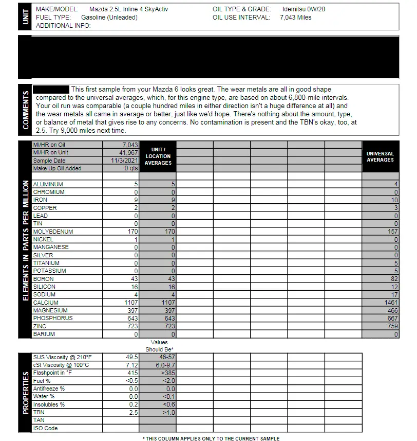

New report for my 2017 Mazda6. I was worried because I thought the oil smelled like gas, but turned out to not be an issue. Before this fill all I had ever used was the Mazda Moly 0W-20 GF5. I went to the Idemitsu when they didn't come out with a GF6 version of the Mazda branded oil. The current fill is with Idemitsu Ext Mileage GF6, which is supposed to have a higher moly content. I'll get it tested too
Appears that whatever you are doing, and however you are getting it done, STICK TO THE PLAN. With over 42,000 miles on the clock (at today’s date) I can’t help but think the engine’s longevity may outlast the rest of the vehicle. And at today’s automobile prices? What a blessing that would be.
Yes, dunhillmc’s 2.5L NA without cylinder deactivation in his 2017 Mazda6 should have much better chance that the engine would outlast the rest of the vehicle.
But for other Mazda engines, including newer 2.5L NA with CD、and the 2.5T, I’m not so sure with potential cracked cylinder head and other CD related (non-turbo 2.5L of course) issues.
