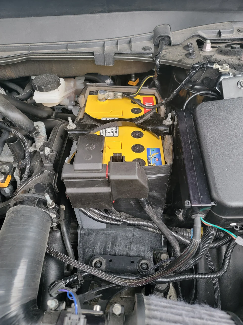

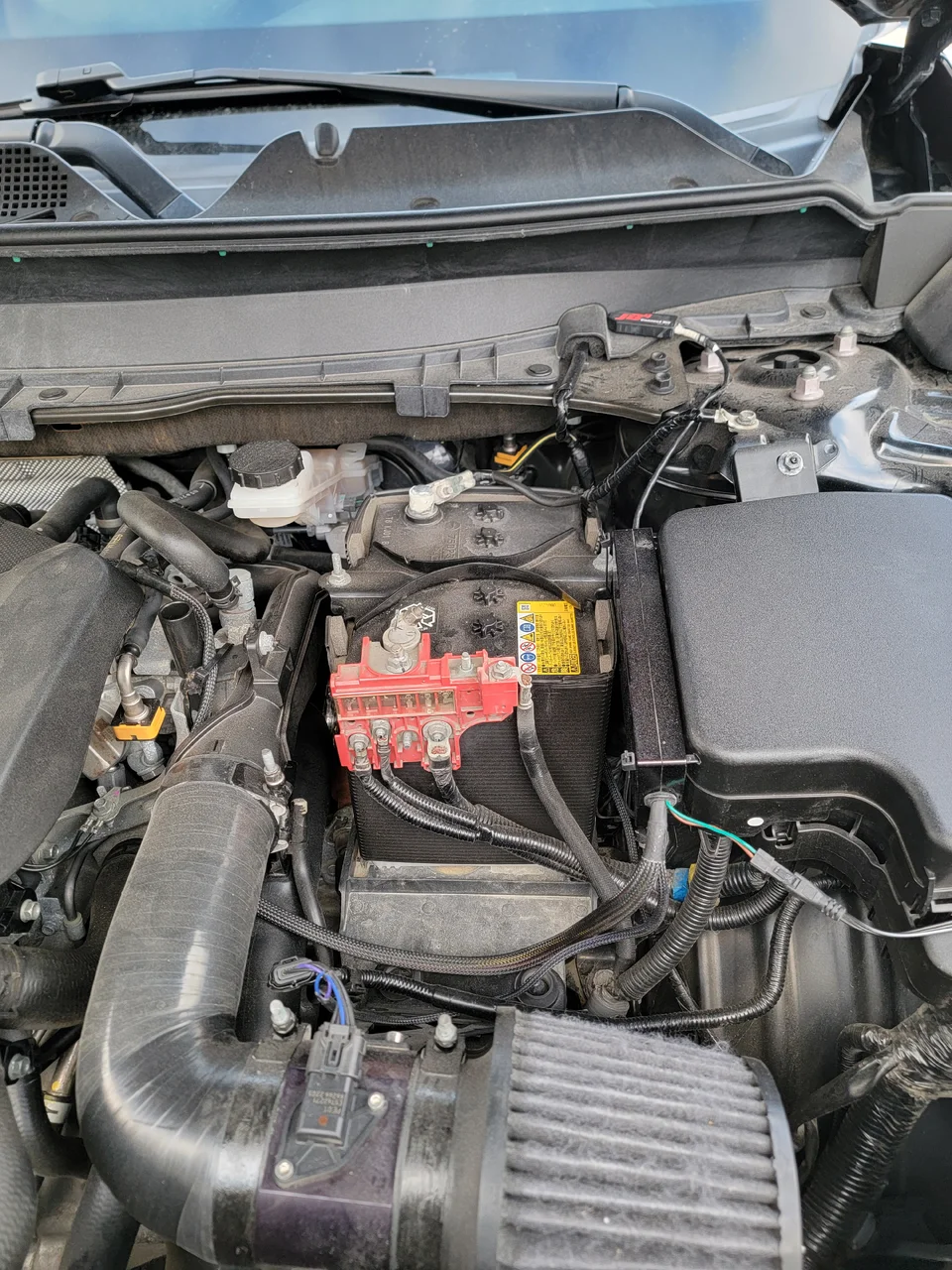

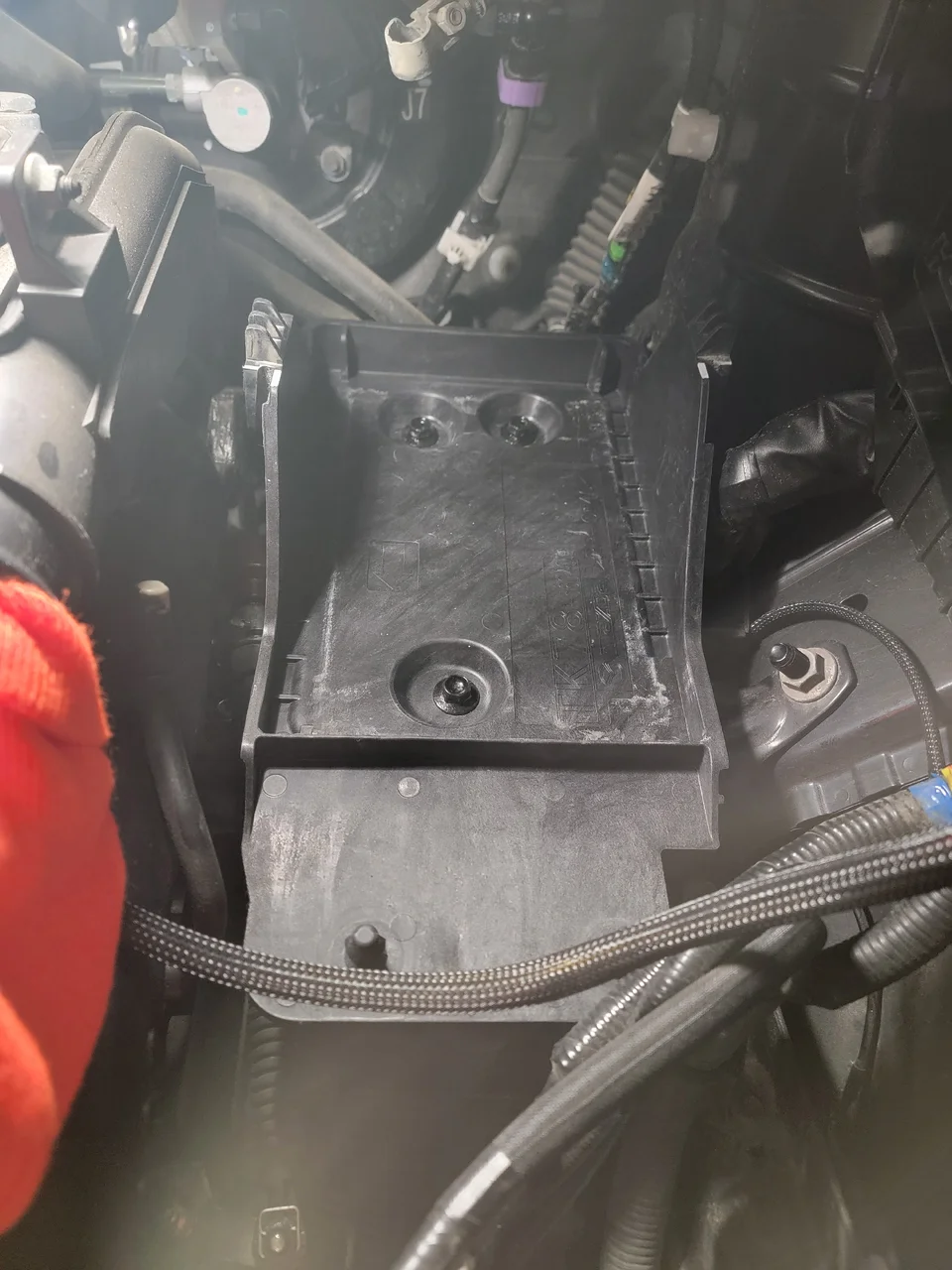

Picked up an AGM battery from a local distributor for a good price. Costco Canada's auto battery warranty is still king with 4 years free replacement and 100-months prorated, while the local place offers 3 years free replacement only. That said, Costco was $80 more expensive for an Energizer battery with the exact same specs. After charging the AGM battery fully, I swapped it in yesterday, adding some dielectric grease to the terminals after snugging them up tightly. All is well after reinitializing the power windows. Again, I went from the OEM Group 35 to a Group 24F, since it had slightly better specs for the same price. I clipped the front tabs on the battery tray for a perfect fit.
Here's the OEM battery.
Cleaned and modified battery tray:
New AGM battery installed.

Looks good! Funny thing is, I just replaced my battery yesterday! It was original from 2018. The other day, I started the car twice just to move it on my driveway, I didn't run it for any significant time for the alternator to recharge. On the next start up for work the following day, the vehicle hesitated with start up and threw a CIL. Figuring it was the two starts with no recharge, I just walked with my booster pack in case. Got to work an hour later. After work, it started without issue but the CIL was still present. (P2610)
A search on Google revealed it was likely a battery not pushing the correct voltage. Not wanting to swap the battery during -20 as well, I bought the Kirkland 35.
Cleared the CIL and no issues since.
As you stated, the warranty, performance and price! I've purchased three Kirkland car batteries so far for others vehicles, no issues at all.
Thought the timing was coincidentally as I read your post.
The brackets holding my battery is badly rusted compared to yours. Then I realized you updated. 😂
Also, your intake is still restricted by the stock plastic tubing making that tight left bend headed to the back, no?

Lol, the battery bracket on my 2018 also started to rust by the time I traded it in. I think it was due to the corrosion from the previous lead-acid batteries it used. Our climate can be hard on batteries - paired with all the newer tech, batteries just don't last quite as long.
The battery in my wife's 2006 Civic, for example, has only been changed 2 or 3 times in 19 years. The first time I changed it was in 2014 I think, I did it in -30c temps 🥶. Replaced it with a Kirkland battery.

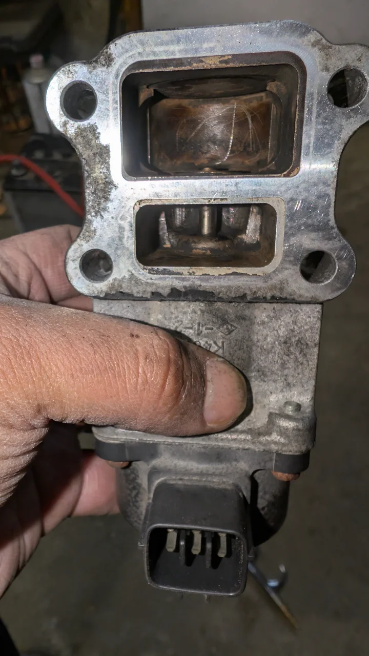

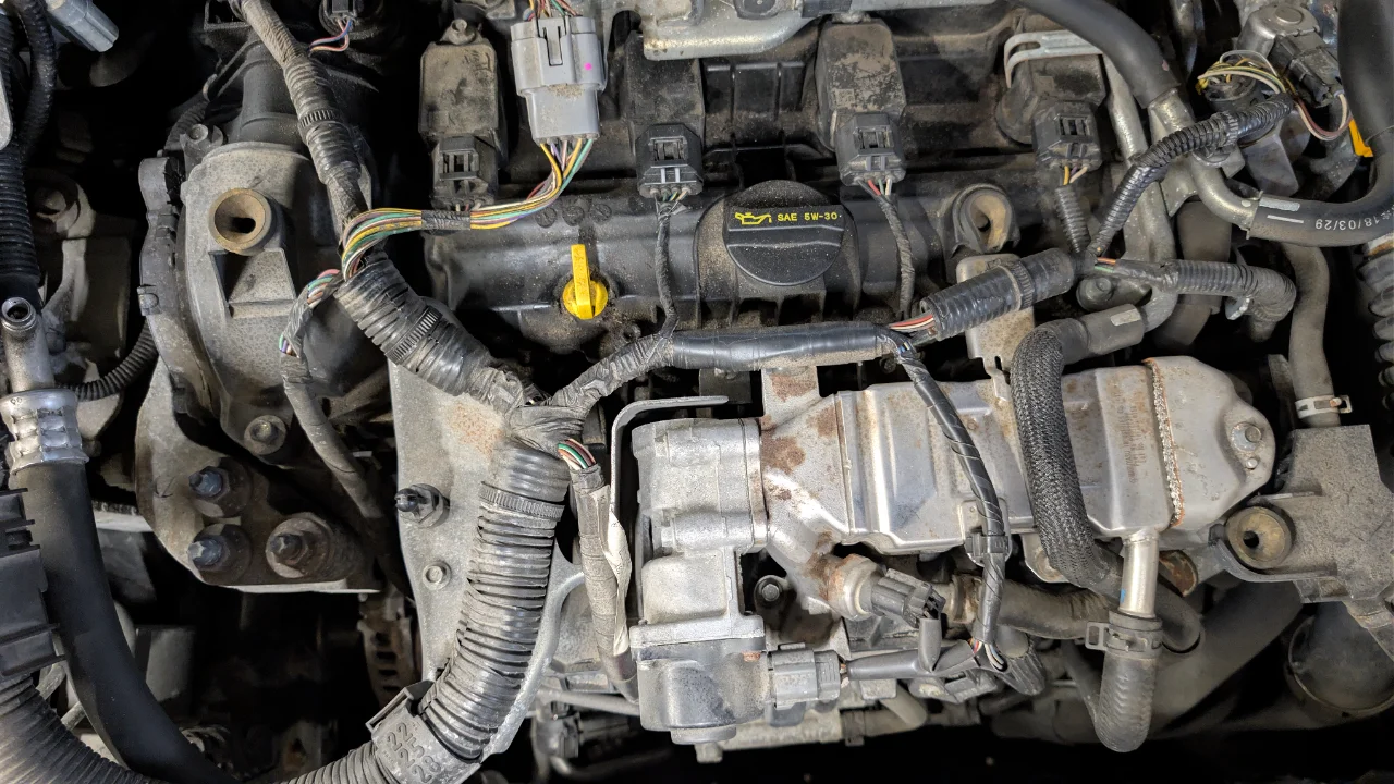

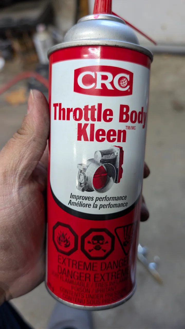

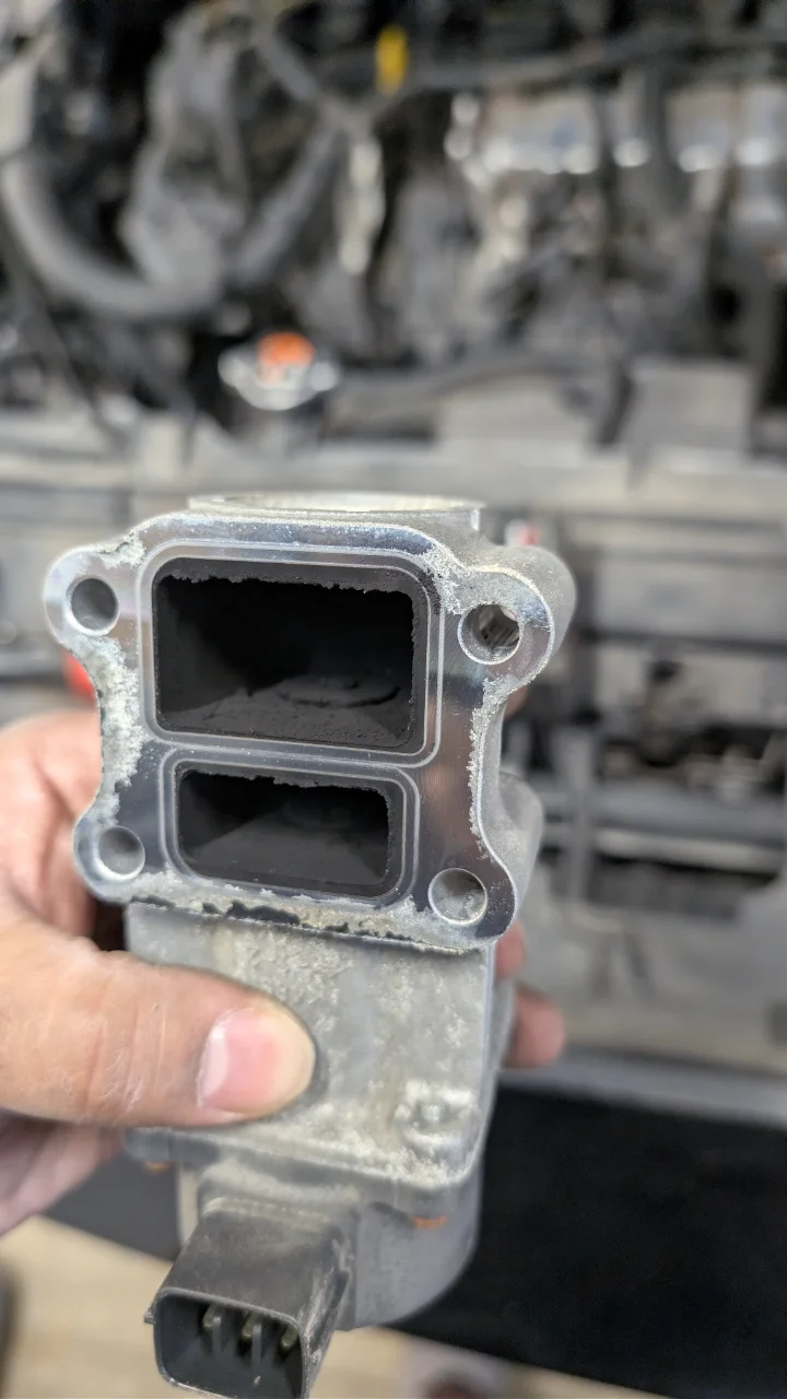

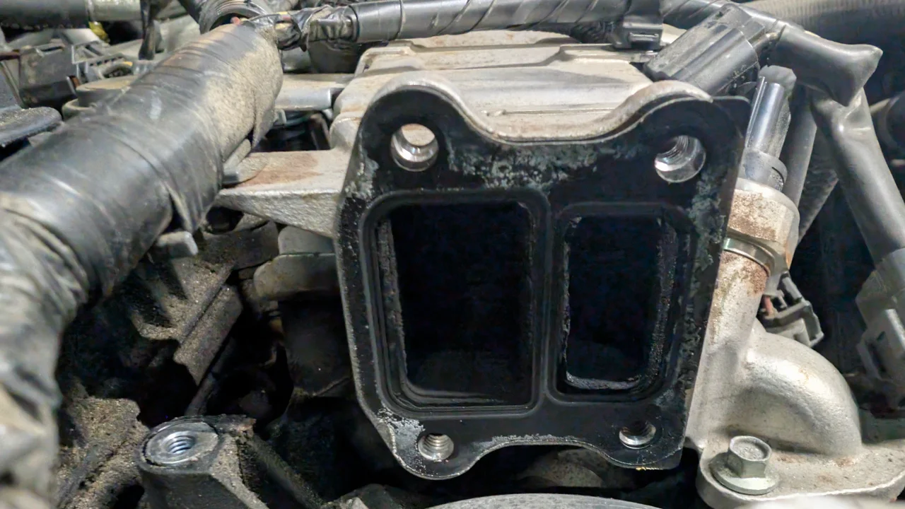

So with about 183k kms, had the CX9 GT since new and always used a good quality synthetic oil with regular oil change. Saw a video recently with this kid changing his EGR with less kms and boy was it gunked up! I decided to give it a try since it's really easily accessed compared to other EGRs on other vehicles I've worked on.
Just four bolts at the front, 8mm I think.
Took it out, cleaned it with throttle cleaner as it breaks down carbon deposits. I used a little brake cleaner but that didn't clean it any better. I then used my air compressor to fully dry the internals. Note, I didn't try cleaning anything beyond the EGR still attached to the engine.
I was surprised my EGR wasn't gunked up like the YT video I saw with a newer model CX9 with much less kms.
A few pictures for you to see. No error codes etc, I haven't driven it yet to notice any difference as I still need to do an oil change soon, but it couldn't hurt.
I figured this would be a good indicator to determine if carbon buildup on the valve is present. Seen a few videos with walnut being used with compressed air to clean the valve head etc. Anyone use that?
I've only ever used seafoam every so often before oil changes.

Nice! I've never cleaned the EGR on any of my vehicles, past or present. Good to see that it's so easy to access on the CX-9, thanks for posting. I'm definitely going to be doing this.
I think how dirty the EGR gets is related to driving habits. Shorter drives probably plays a big part in more clogged up EGRs.

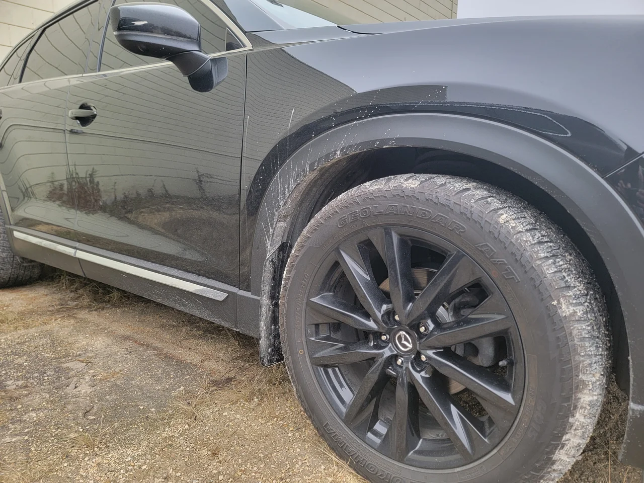

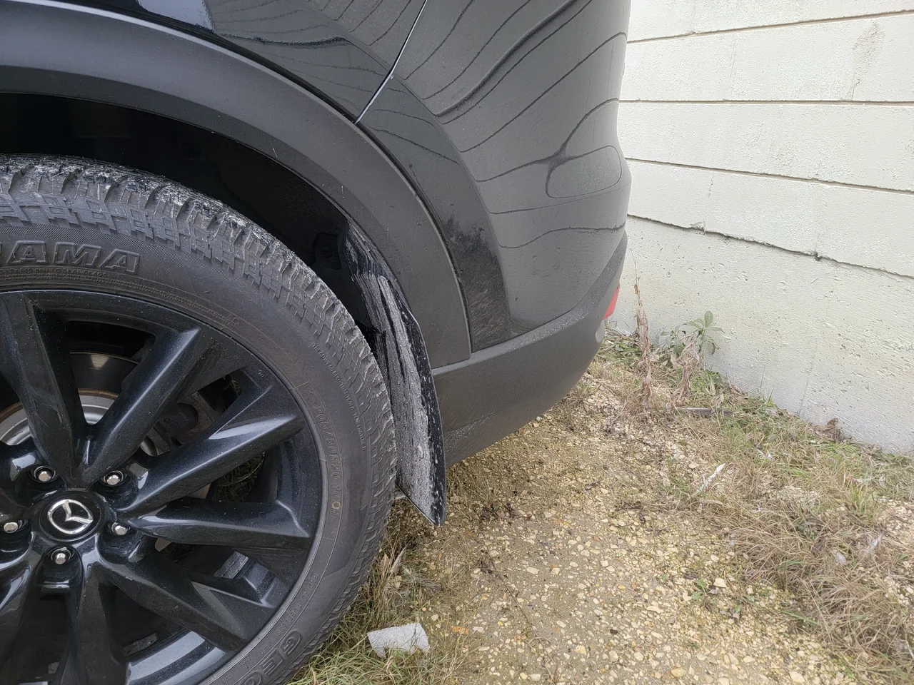

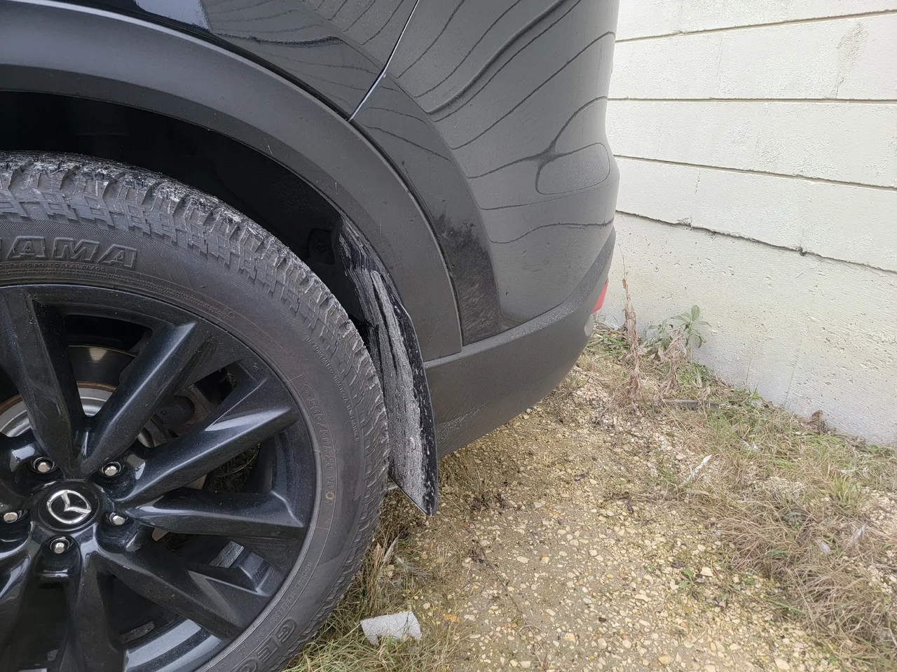

Installed wheel spacers and universal mudflaps. The wheels are just a few mms more aggressive than I'd want ideally, but I'm still happy with the look. We had a bit of rain last night, and after driving to work and through the tractor yard, it appears that the mudflaps are doing their job well enough.

Did you get 25mm spacers ?
Tires looks like few mm outside of fender line or is that use to wider tires a stock size ?
It's both actually, lol. Finding 5x114.3 spacers (not adapters) with 67.1mm hubs at an affordable price is harder than I thought it would be, even second-hand. I finally found a set of used Titan wheel spacers for a good price, so I decided to jump on them. They are 1.25" thick (31.75mm). Paired with the 265/50/20 tires, the result is the above. I think that 20-25 mm spacers with 255/50s is the sweet spot.
Also, in case anyone was wondering, the back of the OEM wheel has pockets about 10mm deep. This space is enough to accommodate the OEM wheel studs on spacers from about 20mm and up (when using the open-ended nuts). With 10-15mm spacers, you may have to grind down the OEM wheel studs.

Lol that was the original. This one isn't lowered.. yet.. We'll see what the future holds! Might do springs again, or I might try coilovers. There's a set of Ceikas in the Buy/Sell right now but I can't spend much until after an upcoming vacation.
Any difference driving performance with these spacers ?

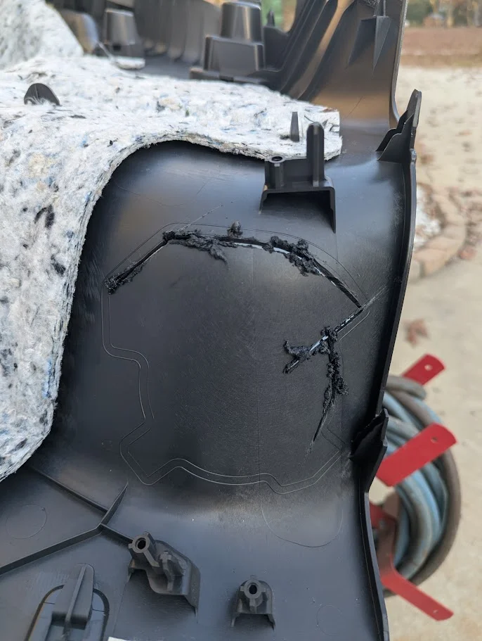

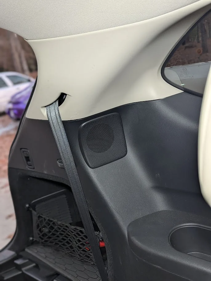

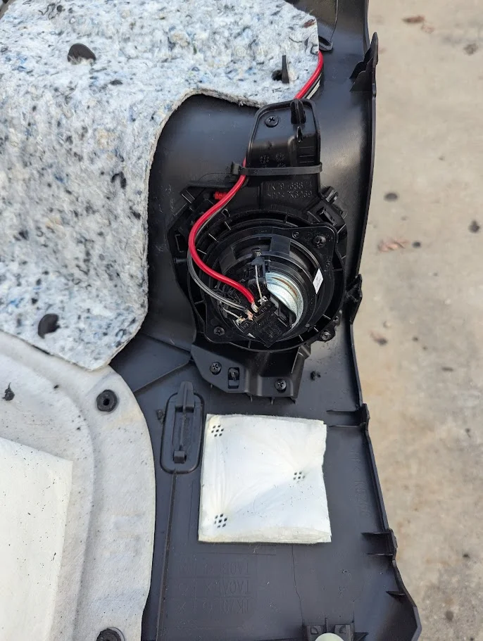

Let me preface this by saying I don't like rear speakers. I do Car Audio sound quality competitions in my car and I've found that rear speakers only detract from having a good image and staging. All they do is pull the image to the back. Think about it this way: when you go to a concert or pub to listen to a band, you don't sit with your back to them, do you? Of course not!
Now with that out of the way, this is our family car, and we do have people riding in the back seat all of the time. And, as my wife drives this car way more than I do, she was gently complaining about not having rear speakers. So what to do? Give her some rear speakers!

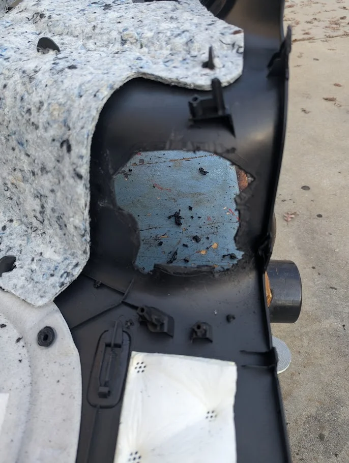

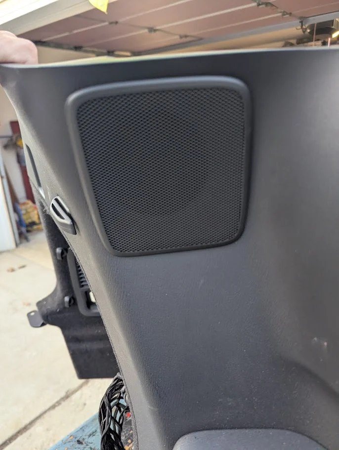

Our car is a 2021 Touring that came with the base (and horrible) stereo. There were no speakers in the C pillars at all. Only door speakers front and rear. It didn't even come with tweeters in the dash. Front dash now has Hertz Mille Pro 70.3 3" mids and 25.3 1" tweeters, and front doors have Linear Power LP8.0 8" midbasses. Rear doors have Skar Audio EVL8-D4 8" subwoofers.
I know that the optional Bose stereo has speakers all the way in the back of the car, near the hatch opening. So I figured there has to be a way to adapt them. I looked at some panels online, and lo and behold, everything is there! All you have to do is cut the holes and add the brackets and grilles!
Part numbers are:
TK79684H102 Right Speaker Cover
TK7968854 Radio Speaker Bracket (Right, Rear)
TK7968874 Radio Speaker Bracket (Left, Rear)
TK79684W102 Left Speaker Cover
Total cost including shipping for the brackets and grilles was under $40.
When you remove the side panels, the screw bosses are already there to mount the brackets. And there is a design built into the cover for where to cut the opening. I used a Dremel with a cutoff wheel. After you cut the opening, screw the bracket to the panel, then the speaker cover pops into the bracket. It couldn't be simpler!
For speakers, I used the 3" Bose speakers that I removed from my car. They screwed right into the Mazda brackets. Plus, they're 2 ohms, so they'll play nice with the amp I bought to drive them, a Taramps TL500 micro amplifier. That amp is unbelievably TINY. It'll work great!

In the home audio hobby we have something called upmixing. Specifically, the Auro 3D upmixer does the best job at mixing stereo sound into the surrounds, at a lower level and with a slight hall effect. Most of the time I prefer stereo for music but there are some types of music and content where this is the best way to go.
