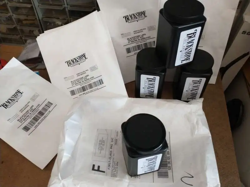

I have a car that has been garage kept and has not been started in 12 years. I am going to take a sample and send it into Black Labs. I will post the results.

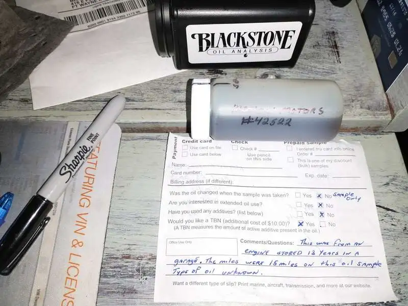

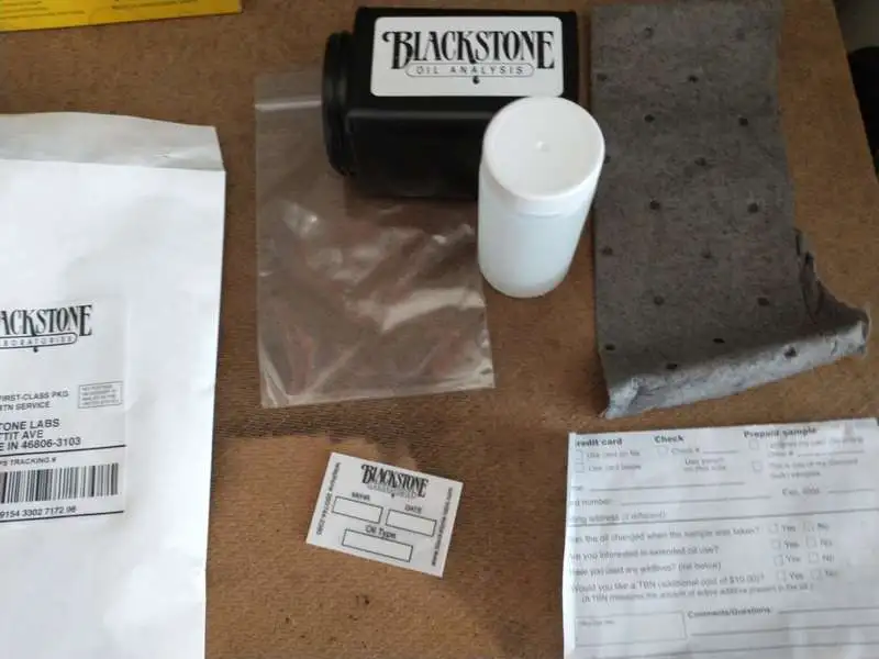

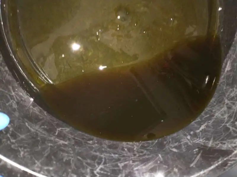

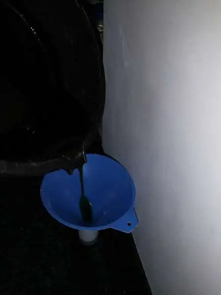

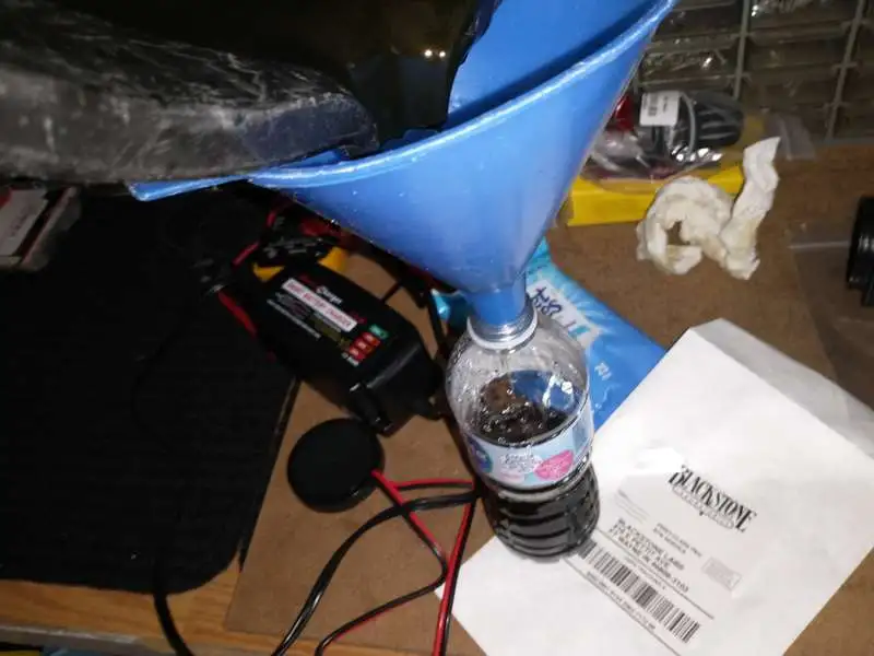

I took the sample today. What a mess just getting enough to fill that little bottle. Pull the drain plug get enough oil and then target the drain toil thread and reinstall the drain plug/ :ROFLMAO:
So as you can see I purposely left out some information on the order so that the results would be 100% accurate by the findings.
Will post result as soon as I get it.

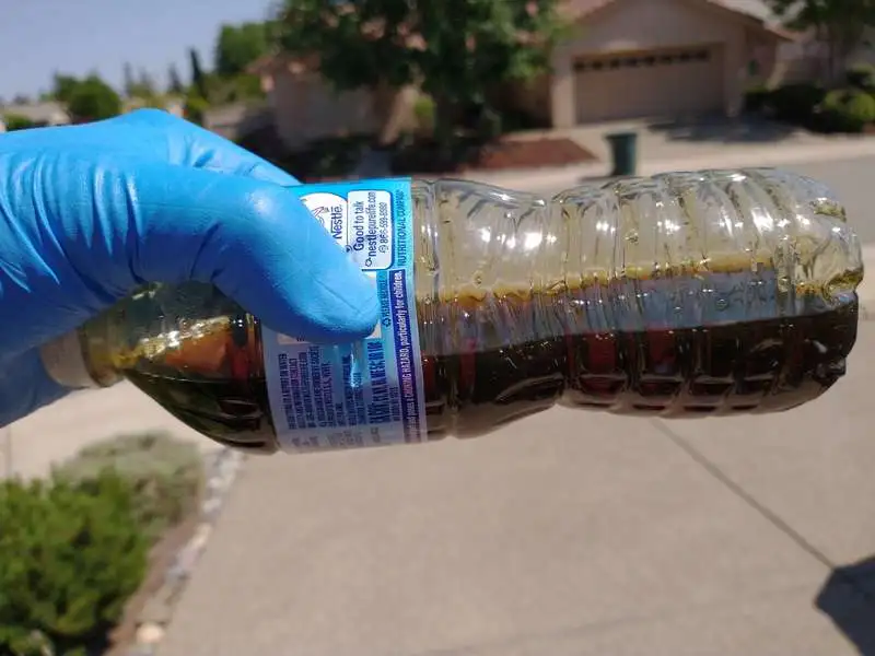

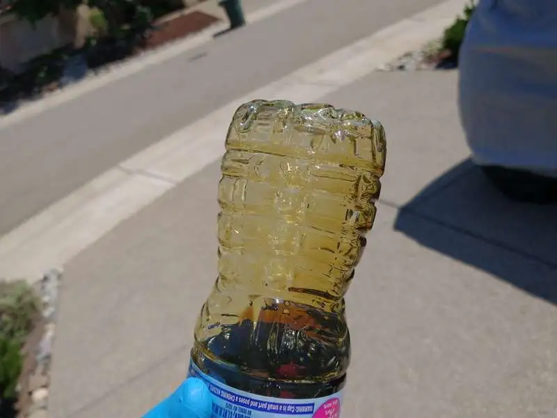

The remaining I poured in a empty water bottle so you all can see it is very clean and new oil with only 15 miles sine that oil was changed and filled in the engine 13(not 12) years ago. The down side is I can't find the information on the oil filter which is a canister type was changed then. Oh well I am not sure that would matter because the canister is at the top of the motor and any oil would have drain back into the sump in a few years if not 13 years. I am going to guess that I did change it because that's the way I am and I have minus one in a 6 pack of filter that only fits that engine.

@Tribe&TrueRacin , it'll be interesting to see the results. Out of curiosity, did you run the engine any before you drained a sample out?
