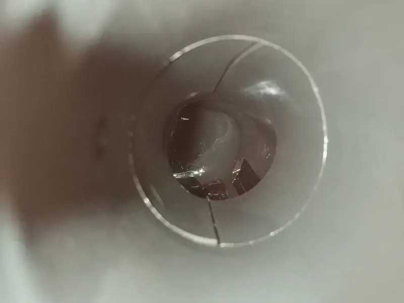

Yes, I watched the video, but it does not really show the extent of intake puddling. I also went hmmmm the condition of the engine and also that was an extreme amount of just oil carbon and gunk at only 18k miles... that's just bad.
Here is mine at about 30k miles. First time to service a causal clean by wiping the inside of intake only. No chemical cleaners.
You will notice that the PCV port at the 3 o-clock and the puddling at the 6 o-clock position.
I do a few things that keep a control on the carbon and there is only a slight amount of carbon on the back of my intake valves that is just starting to form. I did a compression and a leak down and the engine is perfect for compression across all cylinders and the leak-down barely bumped the gauge at .3 %. I think had I installed the catch can sooner on the PCV side I may have had less oil puddling. IDK. Will see next time I pull the TB to clean it? I have had a catch can on the breather side since the engine had about 4k miles and no even a hint of oil film in the hoses.
