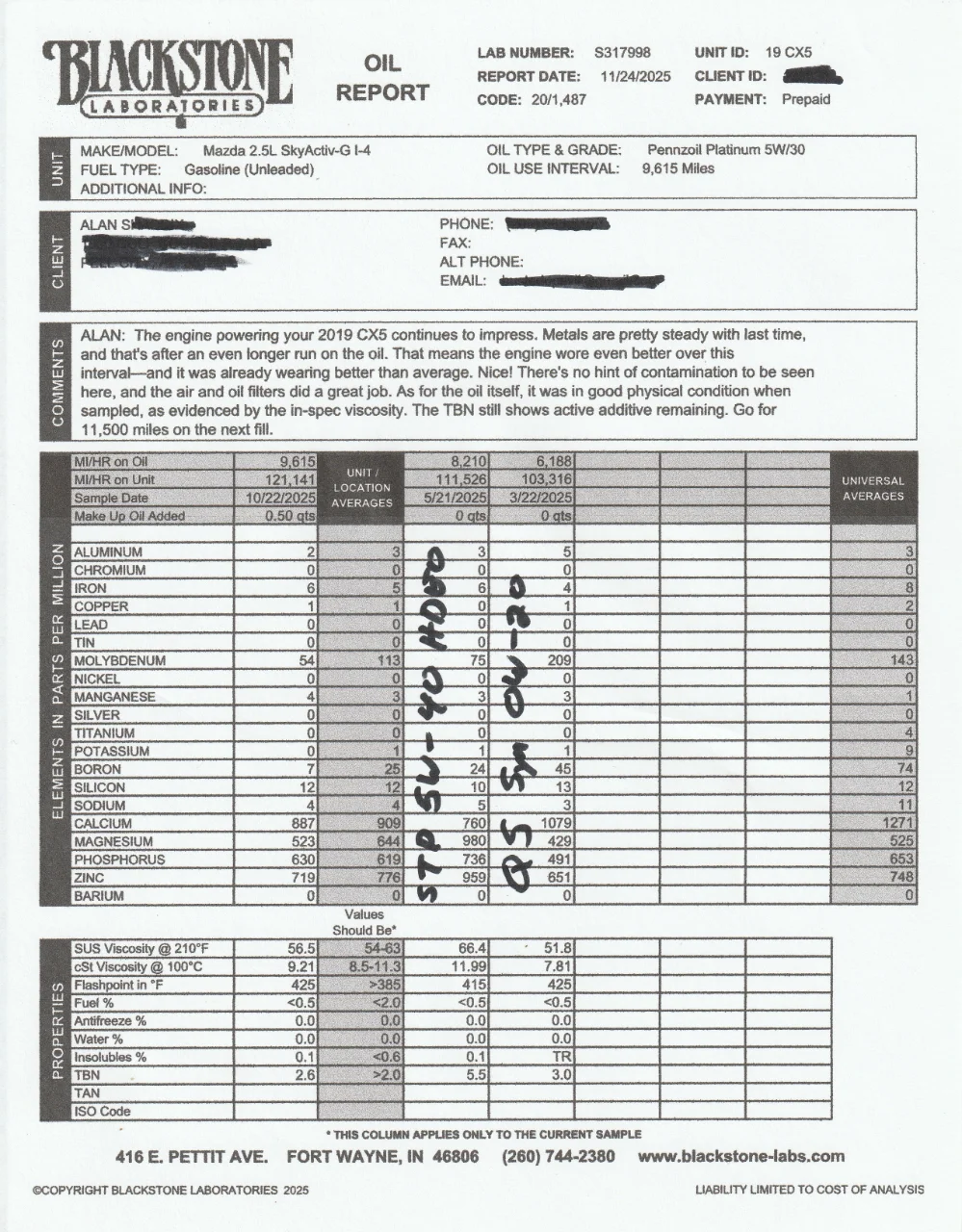

I finally got my result today.
I'm happy to see that the wear metals are down despite the higher mileage this interval. Looks like I've cleared the last of the silicon out from assembly. And fuel dilution has continued to reduce on a per-mile basis, a sign that the rings are nearly fully broken in.
One big curiosity stands out to me. The amount of boron (friction modifier) is down 25%, and calcium (detergent) is down 10%. ZDDP (anti-wear) is also down slightly. Did Pennzoil alter their formula? Just to be sure, I shake up my oil jugs every few months, and vigorously before the oil change, to ensure the additives are all going into the engine.

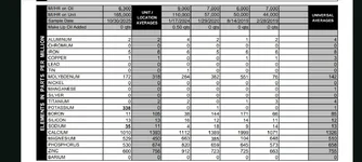

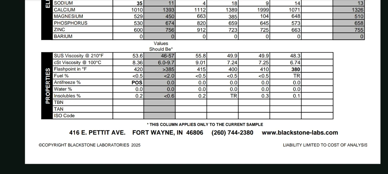

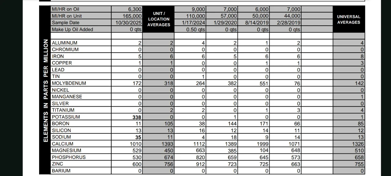

Latest report on my 2017 CX-3 Skyactiv 2.0 with 165,550 miles. 6,300 miles on Royal Purple 0w20 with LM Motor Oil Saver and RP filter.
The next sample is Idemitsu 5w30, Mazda Thailand filter, and LM moly. 2K more miles to go so maybe mid January.
***Comments: Liqui Moly Oil Saver is fine to use, and it doesn't tend to skew the results much, if at all. There's a different reason potassium and sodium spiked. These elements together show coolant
contamination. The good news is, the contamination doesn't seem to have interfered with lubrication; the wear metals are about as low as they were in past samples. There aren't any other contaminants like excess dirt or fuel dilution to deal with. If coolant is disappearing, seek inspection. If no coolant loss is seen, check back on contamination in 5K-6K miles.***
I have not detected any coolant loss and I am looking under the hood more than twice a week. Pretty sure that the sample had not been contaminated during collection. Will wait and see!
Edit: Kept reading last night and confirmed that potassium and sodium are in the Peak formula that I used at the time. I did only one round of drain & fill, which means the old-new mix is perhaps 33/67 (judging by how much is left in the first jug). The hike in potassium coincides with the introduction of new formula. What else is there to blame? I of course blame myself for the choice. I can feel Gandalf staring at me.
Followed up with Brian at the lab and he didn't think the new formula did it. I will do two more rounds of drain & fill with Peak OET Asian Green 50/50.

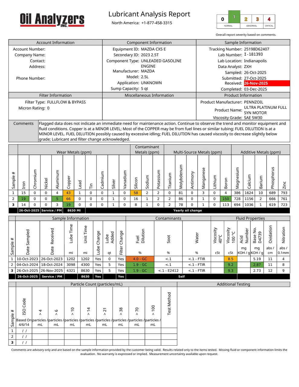

I just did a 10K run on the Pennz Non-Ultra Platinum and the Boron was way low compared to the previous oils I have used. Everything was fine but WHOA that is a BIG difference in Boron from the other oils.
From my reading, I think the Ultra got the extra boron while the the Platinum oil did not. It was one thing that differentiated them.
When I did the math and found the difference in boron and ZDDP between the old and new oil is 25% and 10%, I thought those looked like numbers that a human would intentionally target so it must be a formula change.
I know LSPI prevention is a big theme these days and is why calcium has been cut and magnesium has increased to fill some of that role, but I'm not sure what role boron would play in that.

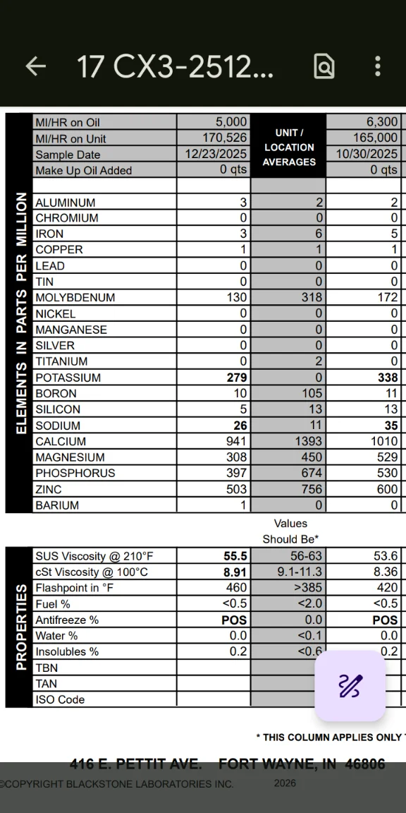

UOA from 5K OCI on 12/23/25.
Comments: "Potassium and sodium went down, but that doesn't mean the coolant leak is going away. The decreases are probably thanks to the shorter oil change interval. That said, the coolant leak doesn't appear to be getting worse, either; potassium & sodium are about the same as last time in terms of ppm-per-mile. Engine wear continues to look good. The viscosity is just a touch thin for 5W/30, and that's no problem. Insolubles are low at 0.2%, showing the oil filter worked well. Keep watching for coolant loss, and stick with 5K-mile intervals."
The viscosity was impacted by the residual 0w20 from the previous OCI (which N7turbo already told me so.) If anyone is curious about the oil filter for this OCI, the cut-open video was posted on 2/6. 😬

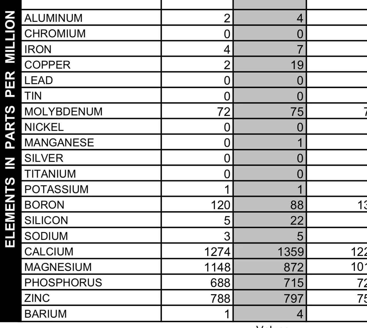

the small amounts are nothing to worry and could also be from the oil you use.
see the grey column thats some baseline that blackstone provides on averages they see.
see mine

Yes it points to a leak on that other report.
for your numbers its not a leak and nothing to worry.
When the values indicate a concern, they'd address it in the comments.
