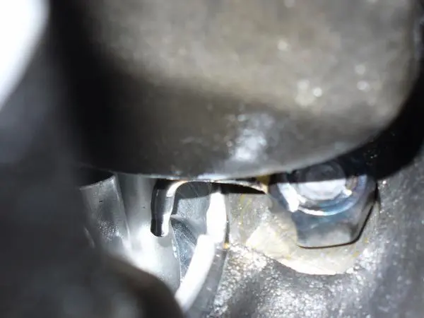

They were notched deep enough but too wide at the lower skirt wall. I had 2 sets of the old design pistons stock and .020 overbore and 2 different machine shops did both. Picture shows the comparison between a stock cutout vs modified and unmodified old design.
Another thing you can't TAP them in too deep when you are not using a press!

So, I want to bring this thread back from the dead. Not the attitudes expressed in this thread, but this the facts. Now, someone correct me if I'm wrong, but it is my understanding that the first run or so of Arias pistons were not machined with an adequate oil squirter notch in them, and Sam had one set of these. Since then, this has been remedied (I've had 3 sets of Arias pistons in the last 2 years, and all 3 have had a really predominant oil notch actually.)
Now my question is this. What clearance are we looking for exactly? Back many pages, dana took a paperclip and measured the clearance to be 1.1mm. If I recall correctly, that was my engine he did that on. And since then, I've had no problems choppping squirters in the 2 times it's been rebuilt since then. So, I put my overbore motor together last night, and I have about the same clearance. Basically, I bent the squirters (they are new btw, the block was bored 20 over) as far down as I could before they hit the crank. I'm super paranoid here, but I'm still dying to know how much clearance is enough. Arias reccomends piston to wall clearance of 4 thou, that leads me to believe that they don't expand too much at all when hot. They're 2031 alloy IIRC. So how much clearance we lookin for here?

Just compare them to stock. The notch should look like the stock.
LIKE THESE:
http://www.mazdas247.com/forum/attachment.php?attachmentid=118614
If it looks like this then you're good.

Can the squirters be clocked once fully pressed in?
Yes. That's why they have a hex head. If you clock them correctly you can pick up a lot of clearance.
I only barely bent mine to be positive last night, I didn't want to break them...
Yeah, don't bend them much, or you may break them.

I don't even need to go to my Dad's house to look, I had pics up here all along. This is one of the original Arias pistons installed in my engine by dana himself, not any of the two sets I've recieved since. Dana is right, there is a good sized oil squirter cutout, it can be seen clear as day.
That being said, the new pistons I have have a much LARGER cutout for the squirter, as Dana has also said. The one thing I can agree with Sam on though is that the edges around the valve lands, etc were sharp on my first and second set of pistons. It's hard to tell from those pics, but the pistons I JUST got like 3 weeks ago had the sharp edges shaved down which better prevents hotspots. I don't know if this was intentional on Arias' behalf, but I'm not complaining.
It's hard to tell from Sam's pics (namely the one comparing his original Arias to to stocker, it was taken at an oblique angle and doesn't really show if the cutout is deep enough) what's going on here, but I put forth some evidence from my own experience.

The oil jets were installed correctly by me and by the machine shop on both sets! You want to argue with a machinist who has seen more engines than everyone here? Go for it the link is up there.
I had the said machine shop assemble the .020 overbore set to prove that it wasn't just my set and they grinded the width of the cutout because there wasn't enough clearance from being too wide and would hit! We used new OEM Mazda oil jets in both sets! Your pistons don't come balanced from the factory either!
Look at where it hit the edge in the picture! If your pistons were designed correctly, the oil jet cut out would resemble the stock pistons and why you change the design!? hmmm?!?

I had the said machine shop assemble the .020 overbore set to prove that it wasn't just my set and they grinded the width of the cutout because it was too wide!
Like I said, they are tricky. With the original skirt design, it was probably less work to cut it deeper than it was to fiddle with the squirters, which is why I had them cut them super deep after that. That way no one had to tinker with the jets so much.

We can agree to disagree all day, and I will stand in my position and assert it was not installer error. However, we can both agree that there are variances in the OEM oil jet where it is welded as an assembly which could have been the issue. This thread is a moot point as the piston design has changed. No one new will will see that design again since its no longer made. Attacking each other's credibility is useless as it is going no where. The best solution is to lock this thread as is. If anyone has an issue or concern about oil jet clearance, don't drag my name into the fray as I want nothing with it.
^Yup. I gave Sam a call earlier, and we decided that this is a pointless battle since the part in question no longer exists.
The issue with sam's personal motor may very well have been a variance in the oil squirters. We both agreed that he did in fact have the same notch in his pistons as everyone else did with the old design, but it was a close fit, and the variance in the oil squirter tubes alone could have been the culprit. Any Arias pistons I've sold in the past 10 months and in the future have a far larger notch cut in them. so like Sam said, it's a moot point.
