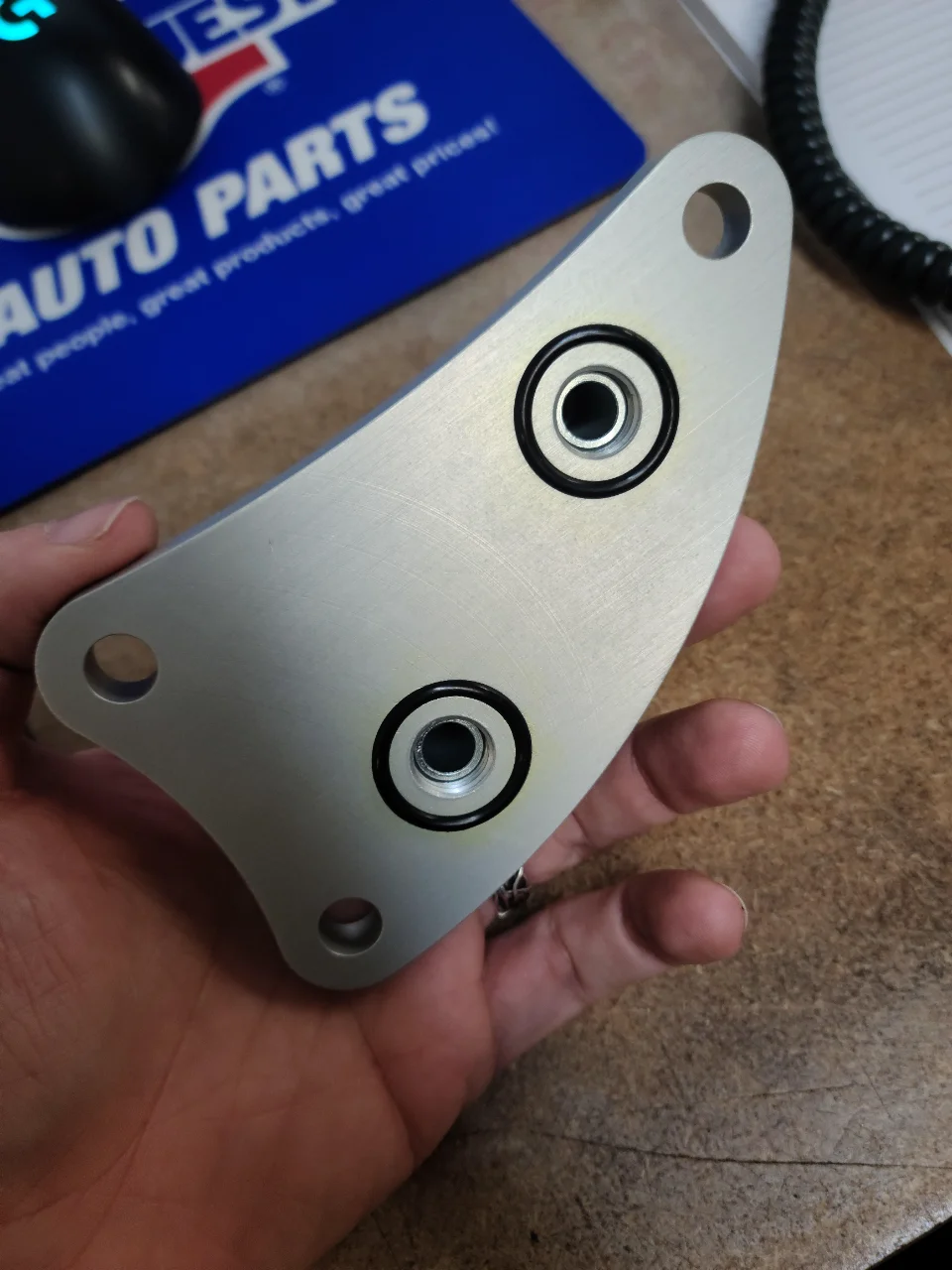

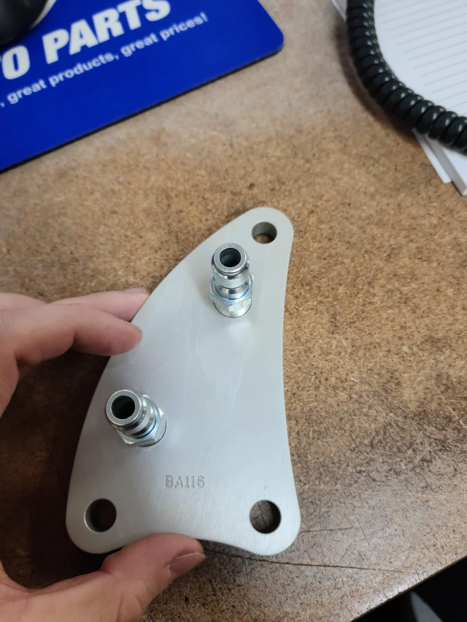

You’re in Japan and things could be different. In the US MNAO (Mazda North American Operations) have never approved their dealers who can use an “after-market” ATF cooler adapter to hook up a commercial ATF flush machine to change the ATF. Any promise of an ATF “flush” service on CX-5 I’d ask to see the special ATF cooler adapter designed only for Mazda’s SkyActiv-Drive AT.
BG makes an excellent adapter specifically for the Skyactiv that works great with their machine. This is what it looks like and what we use when someone wants a full exchange.
