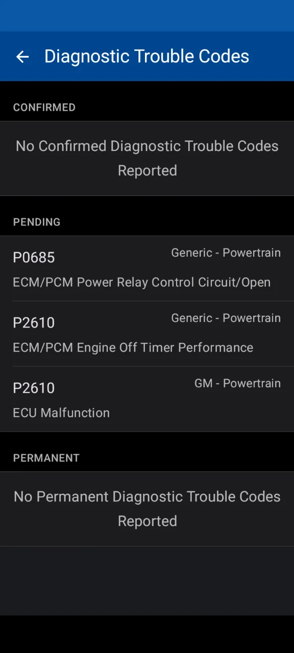

Before the transmission started acting weird, I had an electrical problem in May, the car would stall out randomly while driving at low speeds. It would start back up and run ok enough for me to limp home. One of the fault codes was about a ECM/PCM relay. I started throwing darts in the dark by cleaning the terminals, changing the battery, and replacing a ROOM fuse. I wasn't able to identify which relay was responsible. I got lucky that the codes and symptoms went away at that point. It doesn't make sense.
Didn't think about the connection until now.
I was getting a P0600 code over this winter. My battery, though aging, apparently still held a normal voltage, but was probably failing under load. Replacing it with a new one got rid of that code and it never came back.
It's likely the new battery resolved your code
This is too high tech for me, weak battery throwing scary codes! 😭 Everything was fine before this though, nothing wrong with shifting. It's like saying my upset stomach is somehow related to my not wearing shades in the sun.

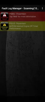

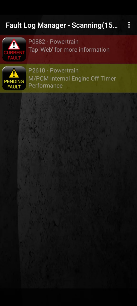

Yep, that's likely to be a weak battery. When the voltage is weak, especially under load, it can mess around with communication.
How many years and KM on your OG battery?

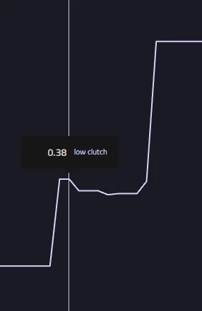

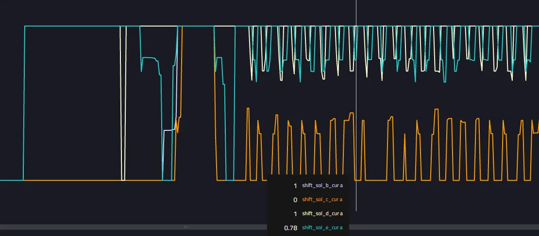

You've likely got some wear happening that the TCM has learned to compensate for. Part of the relearn procedure is relearning the touchpoint of each clutch set and that does change over time. The TCM is constantly monitoring that but sometimes it needs a little kick to really 'look' at it.
When you log the learn process it looks like this.
That is each linear solenoid responsible for each clutch set minus the TCC solenoid which wont relearn until you start to drive it. For those that feel it in the brake pedal during the relearn what you are feeling is each solenoid moving the clutch sets to the touchpoint and then pulling back and rapidly cycling it.
If we look closer we can see what that looks like based on amperage command. For my personal car it takes .38 amps to bring my Low Clutch to its touchpoint. It brings it to the point, backs off a little then applies a full amp to give a full engagement.
When you log the learn process it looks like this.View attachment 343646
