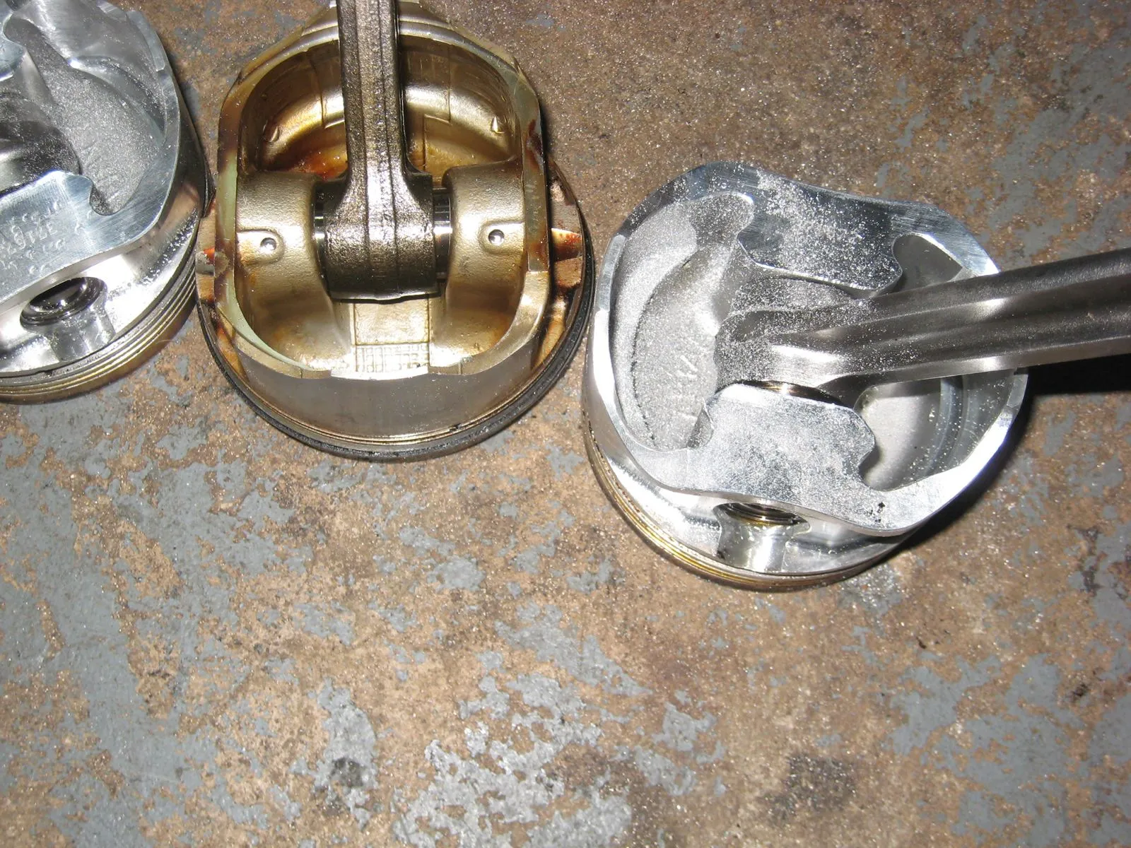

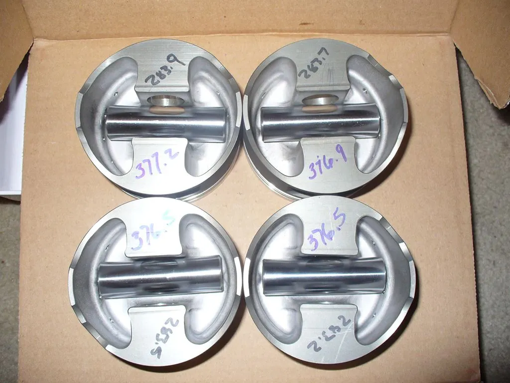

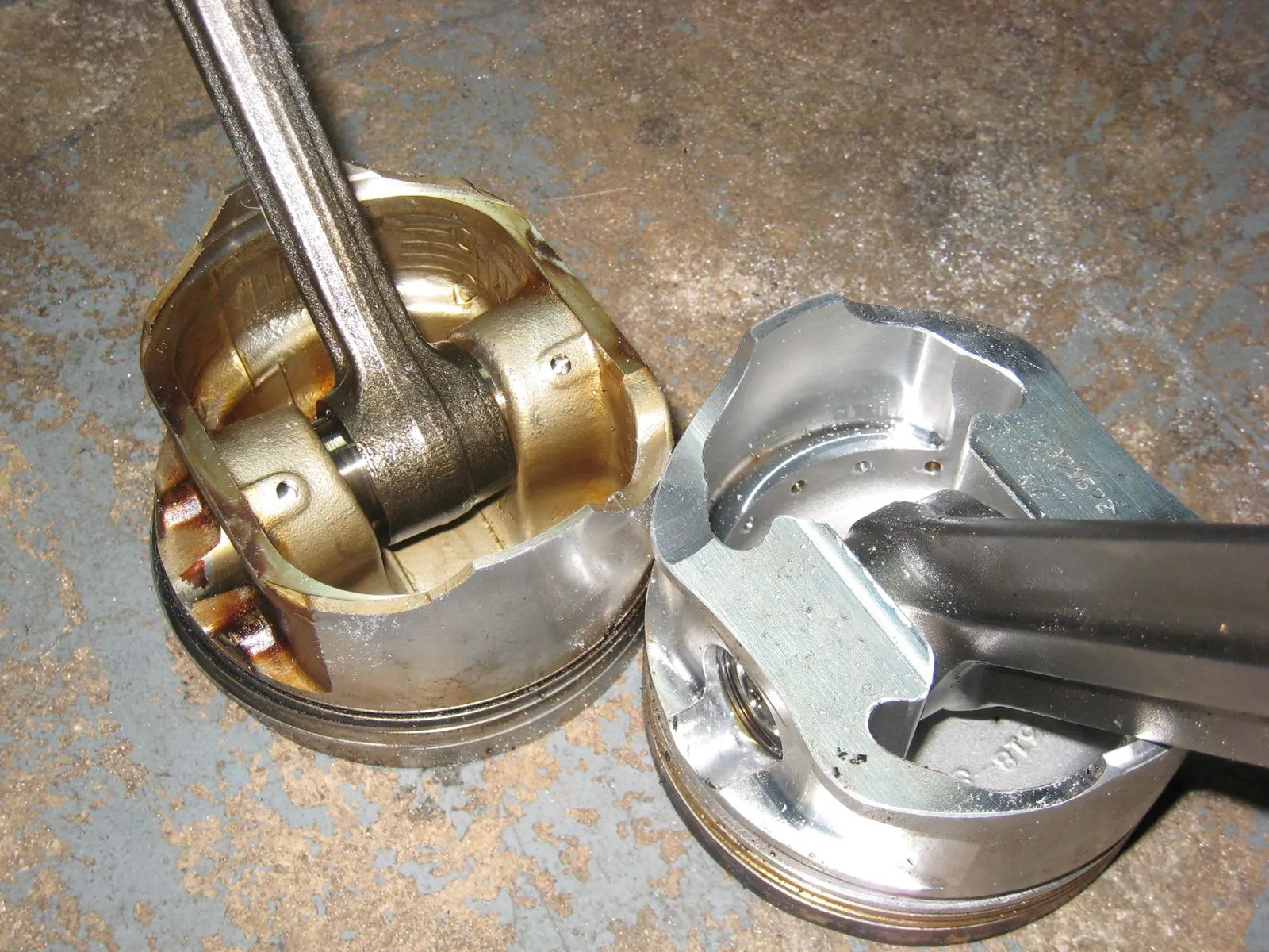

Wisecos by far have had the most clearance for oil jets from any piston I have seen and have the skirt coating. Here are pictures from my oil jet fix months ago.
1st Pic AFTER grinding of Arias compared to the stock piston.
2nd Pic BEFORE grinding of Arias compared to the stock piston.
3rd Pic are Wiseco pistons for comparison.

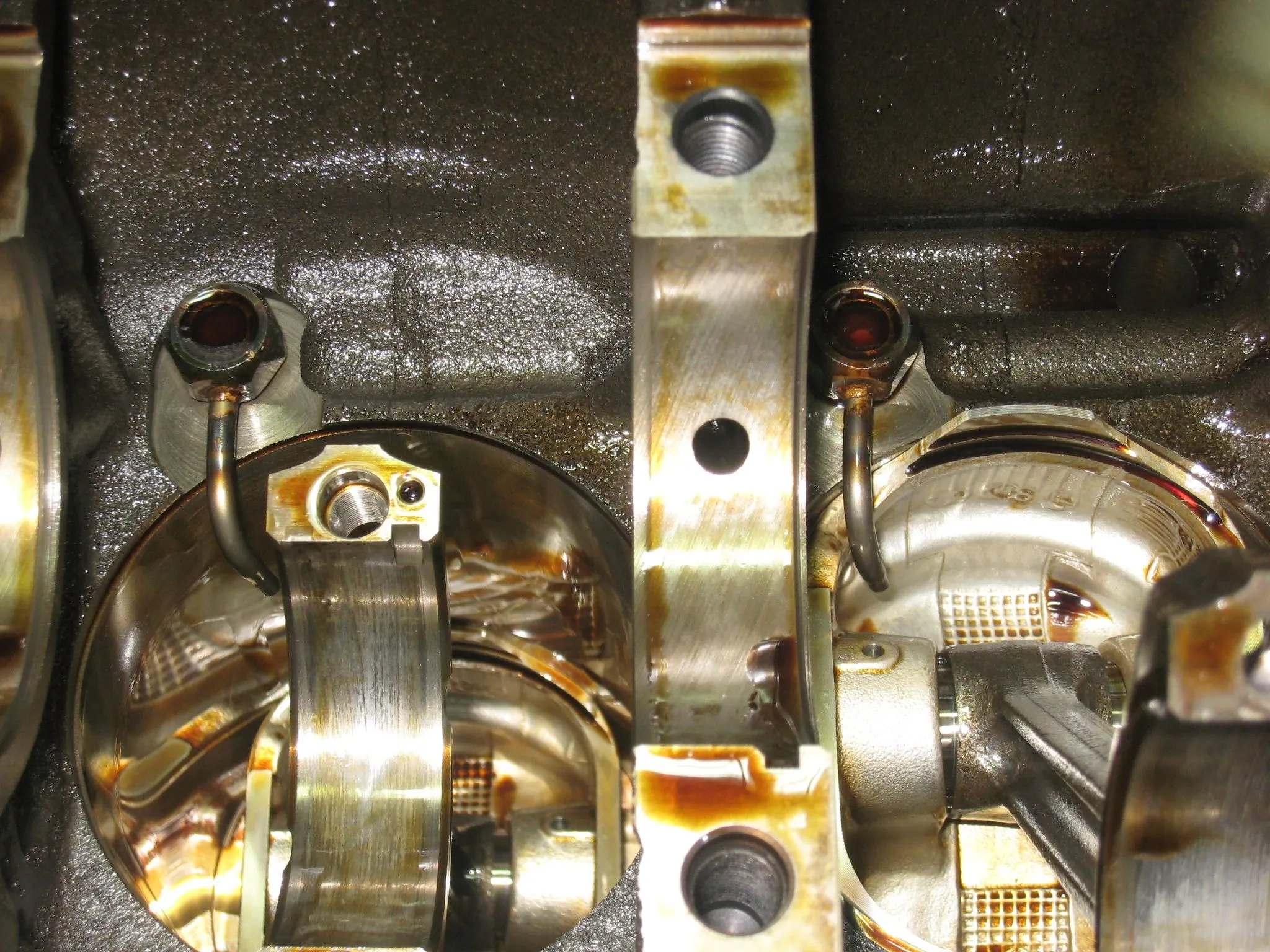

4th Pic completely stock short block oil jet position from the factory.
The relief was grinded to mimic the contour and size of the OEM piston.
Everything was sent to be rebalanced after.
