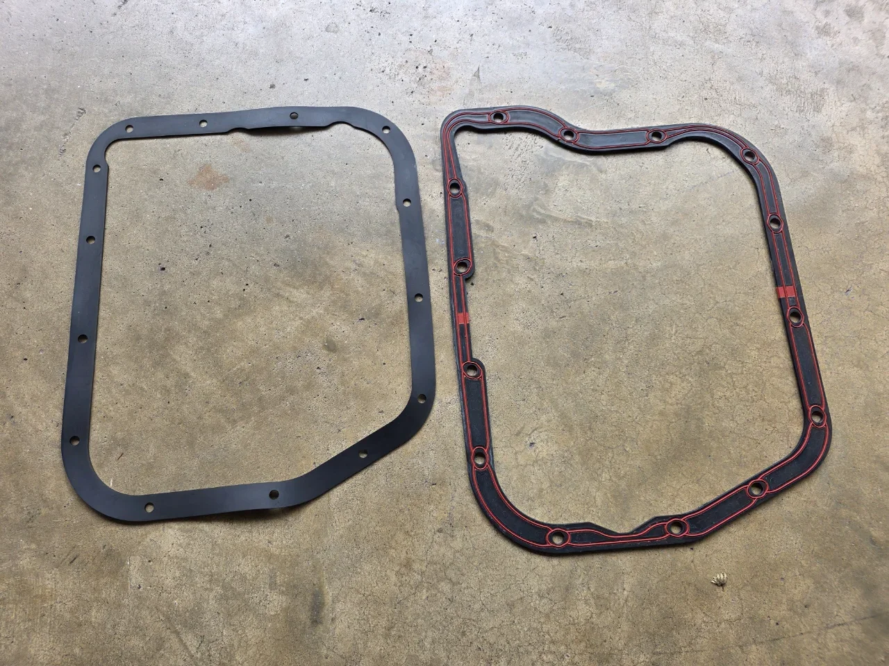

Here are two trans gaskets I use. The one on the left is for a 48re. It has NEVER leakes. The reusable gasket on the right fits a Nag1 transmission pan. It does not leak.
My 48re is due for a 30K mi ATF change this week. I will be using the gasket on the left without any RTV. I'll torque to 120 in lbs. These bolts are easy to strip....
I found to torque to 71 to 97 INCH #s for Mazda pans. These maybe smaller bolts than the Domestic 48re. I'll do 80 in lbs, go for a drive, get the trans warm and go for +90 INCH lbs.

The gasket on the left, on post #47, came with the Wix trans filter. I forget who made the reusable on the right. You are right, 48re is a heavy duty trans to go behind high torque Cummins diesels.

For me, I'm not stressing on the gasket manufacturer. I'll stress more about getting two surfaces free of RTV. A small amount of RTV left on either surface could provide a leak path. I might spring for a new trans pan. We will see how flush and lazy I feel at the 30k mi mark.

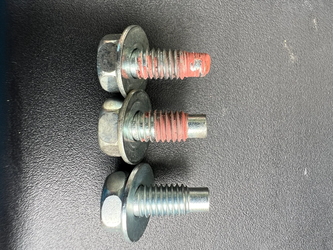

IF anyone knows the trans pan bolt size, please post. McMaster Carr is our friend! Amazon "suggests" these bolts are M8 1.25 x 20mm. The threads in the pic look like poor quality. I'll buy from McMaster Carr.

Here’s a pic of the old pan bolts. I held onto them for some reason for a rainy day. Two on the top were original and the one on the bottom is a new spare. Old me would’ve saved a few bucks and cleaned them with a wire wheel on a dremel, current me said eff it buy new bolts.

YEP as suspected, the threads are full of RTV. They might go back in without harming the trans threads or not. Like you, I buy more parts now than in the past. I don't hold my stuff together with bandaids and bubble gum any more.

Would you be kind enough to measure the diameter and length? I'll add this info to my Mazda log for in the future.

No problem! I don’t have calipers handy so these are rough measurements with an old metric ruler. The diameter of the hex head is 10mm. Length of the bolt is 15mm from bottom of head to end of body. Theres 2mm of body length between the head and thread for the washer. The threaded section is about 8mm long. 5mm of body after the thread until you hit the end. Roughest measurement is ~5mm diameter, wish I had calipers for that.
These are from a ‘13, not sure if they kept using the same bolts for ‘17+ or for the turbo flavor.
