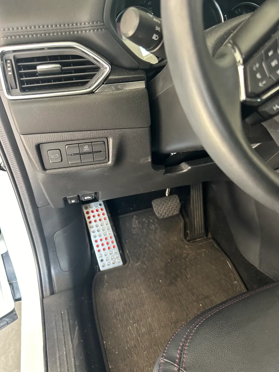

It seems that some later model CX-5's have i-Stop and some don't. The only way to tell for sure is to go to your dealer and look at the buttons on the dash below and to the left of the steering wheel. If you see an "i-Stop OFF" button there, then it does.

what my 2023 cx5 turbo looks like...

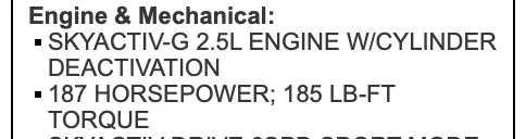

Beginning two or three weeks ago, while checking the Mazda inventory I started seeing 2025 S Preferred CX-5s with a VIN where the eighth digit is M. (L = without CD; M = with CD) So, that motivated me to pull the trigger and buy a CX-5 without CD while they're still available.
So, it looks like Mazda is phasing out the non-CD engine, even in the trims where CD is not in the specification. If anyone else is mulling the purchase of a new CX-5 without CD, the window you have to do so is apparently closing.

A simple way to find out if your CX-5 has cylinder deactivation is to look at the eighth character of the VIN. If it's M, it has CD; if it's L, it doesn't have CD.
For the 2025 model year, some S Preferred trim CX-5s have CD and some don't. At the time I was shopping (I bought mine at the end of May. Its build date is 4/25.) Mazda's "Compare Trims & Specs" web page indicated the S Preferred trim did not have CD. The local inventory reflected that. The eighth's character of the VIN of all the S Preferred CX-5s was L. Around the last week of May, I started seeing VINs of cars "in transit" to the local dealers with an M as the eighth character.
Until today, I hadn't looked at the "Compare Trims & Specs" web page for a while, but I see it now says the S Preferred trim has cylinder deactivation.
