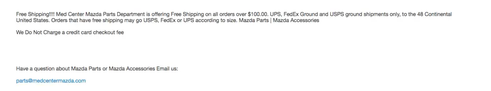

I wonder if Med Center Mazda (mazdaparts.org) still offers free shipping with orders over $100? And if they still ship fluids such as Mazda moly oil、FZ ATF、and SG1 gear lube?

They still claim they will

I did order from them few months ago and it was free over 100. Dont know nowadays but you can always email them.

I had inquired today with Mazdaparts.org (Med Center Mazda) about AT fluid pricing and they sent me the link but saw they were charging for shipping regardless on checkout over $100... so sent another inquiry whether that shipping policy was now gone as it is listed on their home page. I will update as I hear back.
