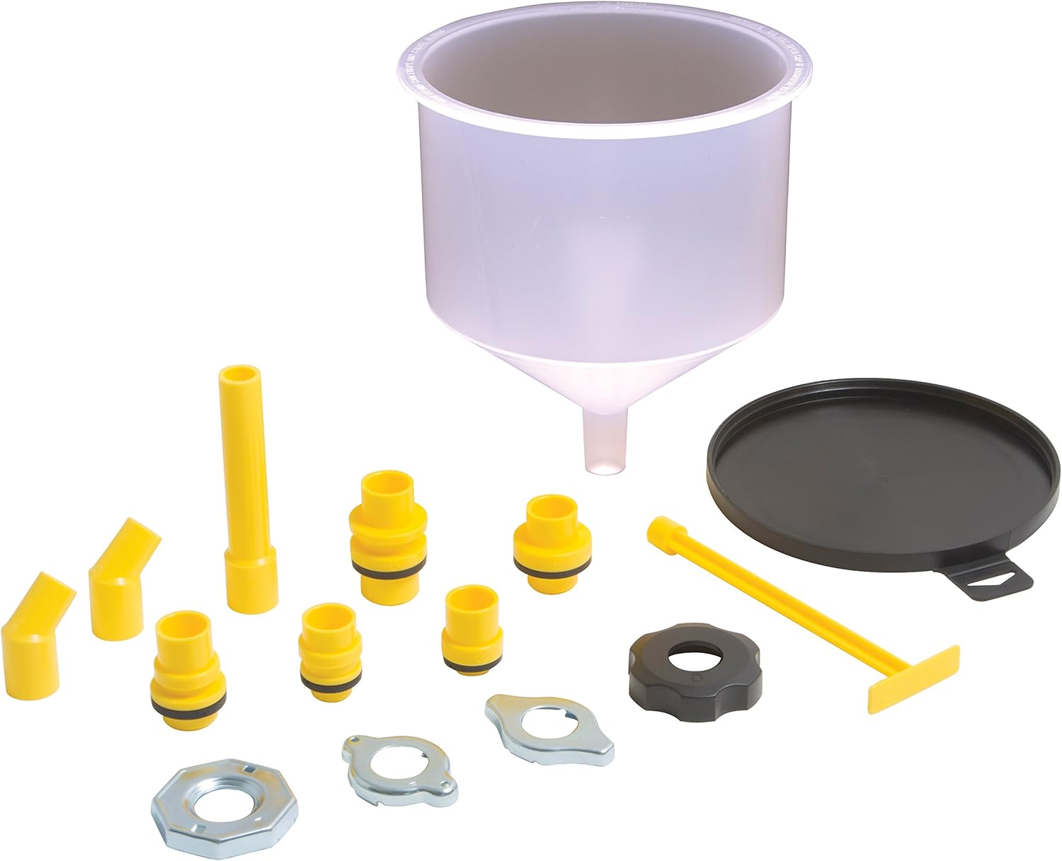

On coolant... I find these so much easier for refill and bleeding air on coolant service.

I bought one of those kits from Azon.
How does it work? I haven't tried it ( or read the instructions).
2013 Mazda CX-5 Sport FWD Auto
I just bought one too, thanks for the share!

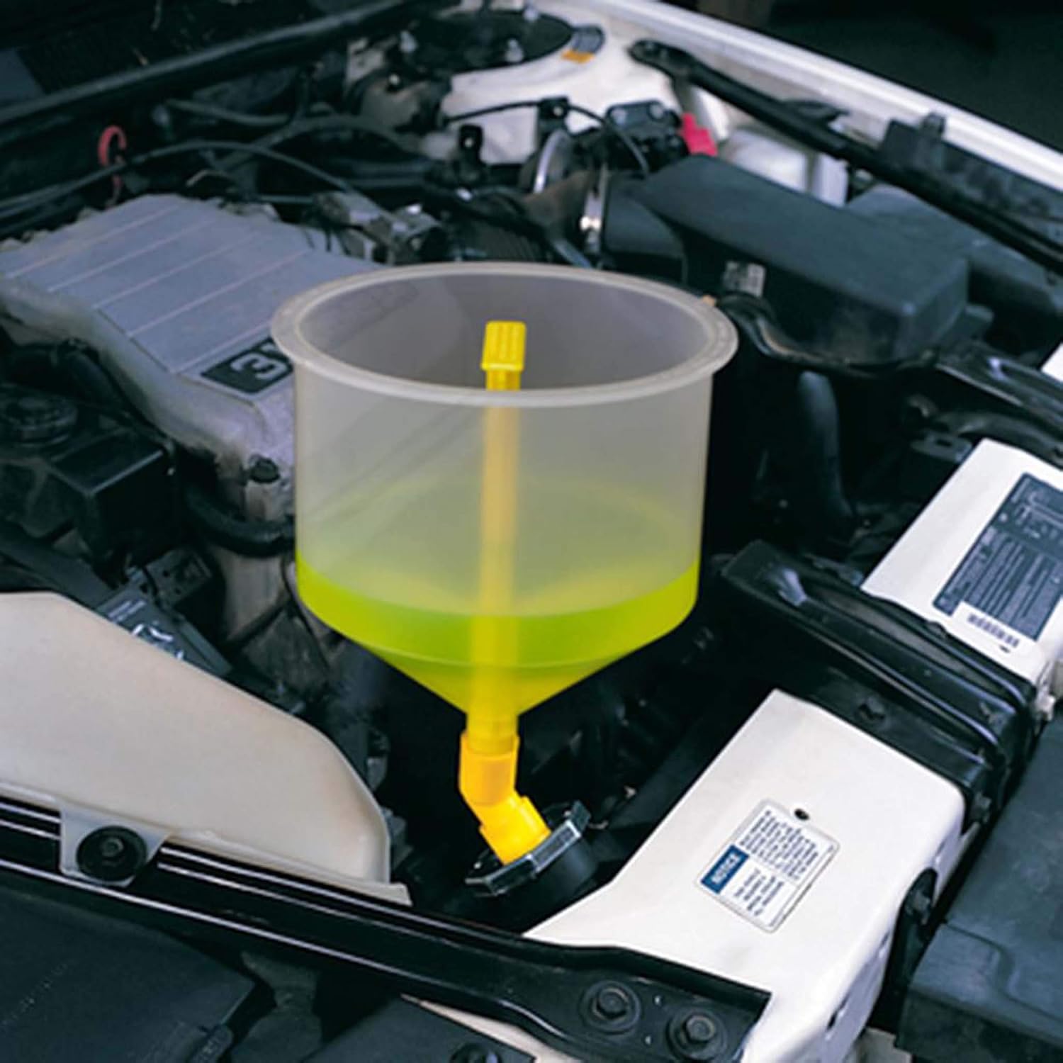

The top rated review sold me. In a nutshell, you fill the radiator with coolant. Instead of replacing the cap and running the car to cycle the coolant, put that kit where the cap is supposed to go and keep it 1/4 of the way filled with coolant. When you run the car, air bubbles can escape and coolant will fill the radiator in its place.
2014 CX-5 Touring
yeah, it basically makes that open top container of coolant become the highest point in the system, which makes it much more effective at getting any air pockets out. It also lets you run the engine with the coolant open, with plenty of room to expand. I used to HATE filling up and bleeding coolant in my Integra, when I would just run it with the cap off, because the level kept rising and spilling over and I'd use an entire paper towel roll trying to mop up the spilled coolant. That special funnel makes it super easy and way cleaner.

A tip listed in instructions.
To prevent spilling any coolant before removing device. Squeeze top radiator hose a little bit before putting in that plug in the middle. You shouldn't spill anything on removal.
