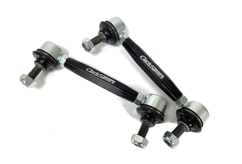

I will be installing Corksport Springs soon. Browsing around their site I came across adjustable end links. Here's how they describe them:
"The ability to change the length of your end links help reduce unwanted sway bar preload or binding that may be a result of lowering your Mazda."
Has anyone installed these?
Now that I'm lowered I'm interested in checking for preload. @AL Cx5 do you have experience with this?
Here's a video I found:
Presumably, if we're unable to achieve zero preload, the adjustable endlinks would solve the problem.

That said, I'm finding it hard to determine whether I really need them just based on the drive. The car feels fine—in fact, this car is handling dramatically better than my 2020 FWD model did, so I'm pretty happy so far. But I'd hate to spend $280 and a few hours to not get any improvement out of this. I guess the only way to tell is to do the work to undo my end links and find out, but I'm not crazy about that.
Someone convince me that I do or do not need them :D

If it tracks straight without having to constantly steer, it's good.
The front links are difficult to adjust with the wheels on blocks. The front SB has more room to swing in the front so having the links perfect length is not as critical as the rear.
If you have a sway bar with 4 holes, put the end link in the inboard hole and go for a drive. If the links are not neutral the car sorta dances going down the road. Been there.
I put my links in the OEM location on the SB. Our goals for the CX 5 is fun, not harsh, handling.
