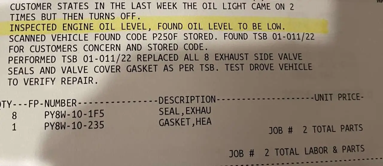

Post a copy of the "fix" when they replace the exhaust valve stem seals. I don't even trust that they replace those. That's probably another lie
They said they did. You're right. They prob didn't hence why nothing changed. Do you mean take a pic of the engine right now? Sorry if I am a moron. Clearly ya'll are dealing with a novice.
I am just curious how the valve seal replacement was documented buy the technician. I have the 53 page mazda r&r instructions on this procedure. If I was the tech, (and this is how we do it in the aviation world), I would just state, "replaced all exhaust valve stem seals in accordance with mazda document bla bla bla." I have done this job on similar import car engines. Its hard to do it incorrectly. But its time consuming. If they replaced the seals with the correct ones, any oil consumption should not be from those new seals.
This was the fix. When that didn’t work and it still burned too much oil they literally changed the oil light sensor.

Interesting. The tech was issued 8 seals, gotta expect they were installed. Very strange.
