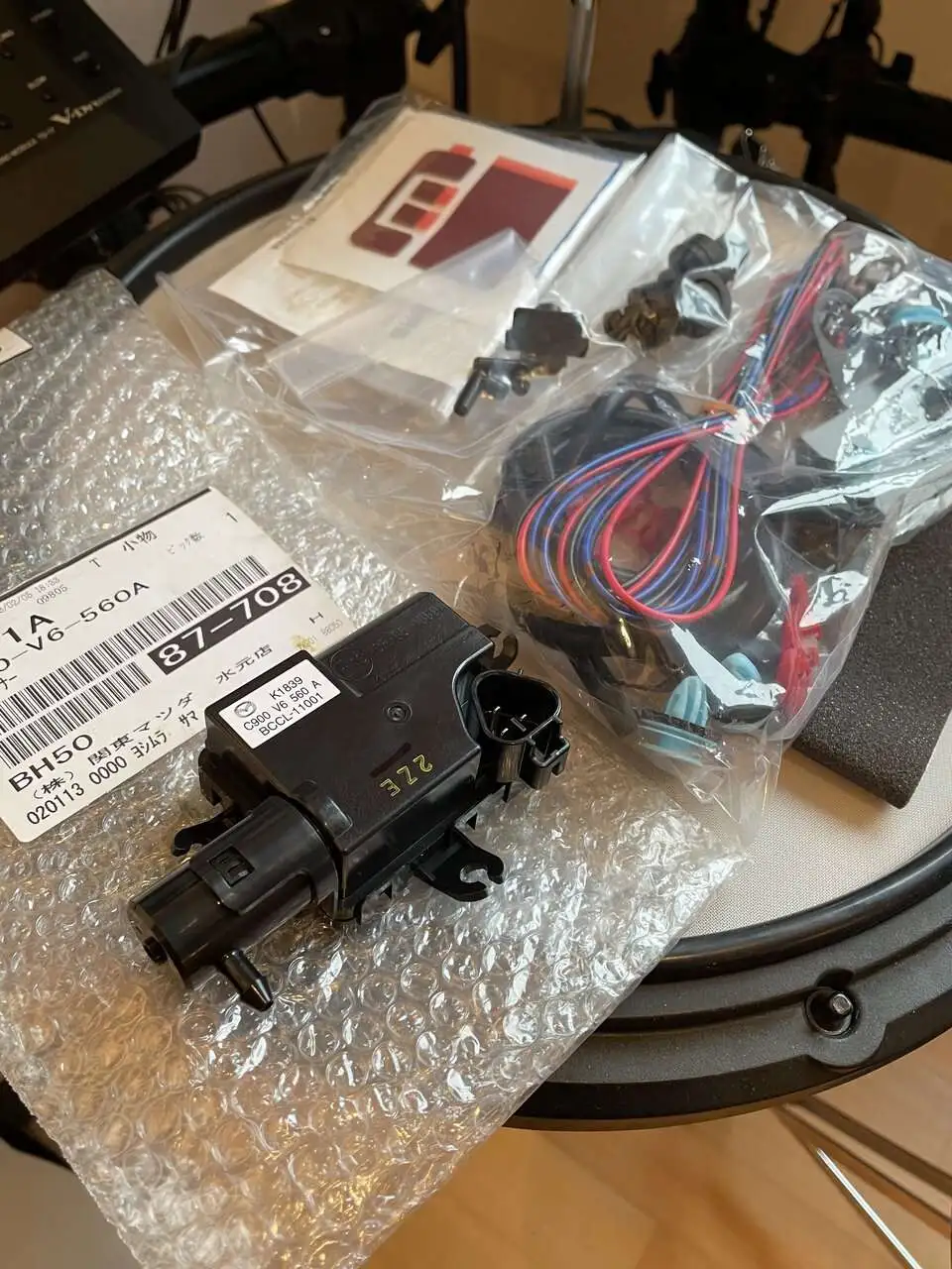

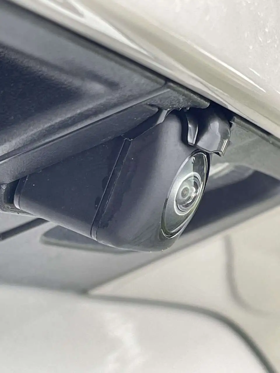

OK, it's installed and it WORKS in European models as well, although meant for the Japanese market! The installation does involve some drilling and connecting wires inside the rear door, so unless you are a DIY guru, best left to a garage. I have the full scan of the installation manual (in Japanese) and happy to share if anyone needs. I don't have a translation, though, I translated it in real time for the mechanic who was doing the install.
The accessory can be ordered from a number of Japanese online stores, e.g. Nengun. You need both parts, the camera cleaner (C900 V6 560A) and the wiring kit (K31V V6 565).
