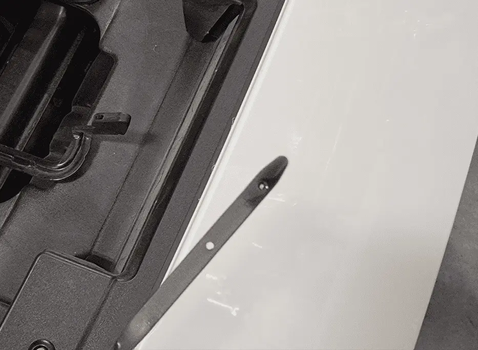

Hello! Long time lurker here. I have a 2021 CX-9 Signature and absolutely love it! I'm currently @ 9000mi and the low oil warning light came on a few days ago, confirmed by the dipstick. I did my last oil change @ 5000mi and by my estimate the car consumed around 1qt of oil in the last 4000mi. I use KNN oil filter and Castrol Edge Max Performance 5w30. No blue smoke from the exhaust so I'm suspecting the PCV valve. Any thoughts?

Yes the oil level was a tad above middle of the low/high indicators of the dipstick. It was the entire 5qt jug. The pic i posted was when the car sat for 10-15 mins. When I checked the level right after driving, the oil level was actually right below the LOW indicator.

I am having a similar issue. When the car was new, the low oil light came on at about 5500 miles. It was the day before my scheduled oil change. The level was exactly as you show and I added a quart and took it in. Dealer said it was ok and first oil change should be done at around 3-5K miles. Next 5K miles was fine and I checked it every 1000 miles or so till the clock hit ~10,000 miles. Just recently, at close to 14,500 miles, the low oil light came on again and the level looks just like you show.

Change the oil. Get the oil level right to the hi line. Track the mileage and photograph the level on the stick each 1000 miles. Be sure the oil is at the same temperature each time. It may help to see the oil level on the stick by laying the stick on a clean white paper towel and see where the oil soaks into the paper.

MY reality: I changed my oil + filter, poured in 5qt, ran for 10 mins, sat for 10 mins, and got a reading of 1/4 above the low mark. I added additional 6oz (essentially 5.2qt) and checked the level to be a touch under 1/2 above the low mark.
My guestimate is you are at 5QT and you did not burn 1QT. I reckon if you add 6oz in right, it'll bring the level to roughly the half mark.

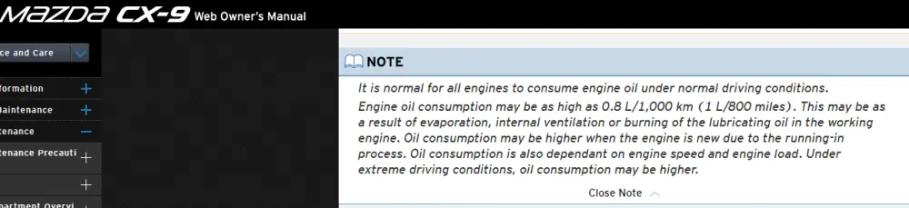

Looks like we have two factions here. I setup an appointment with my local stealership to see what they will have to say. What's odd is that if pouring in 5.1qt puts the level right in the middle of high and low on the dipstick, why would mazda give the option of a 7500mile interval if (in my case) the system would already give a low oil level warning after driving only 4000 miles? Suffice it to say, this is the first oil burner car I've ever owned.

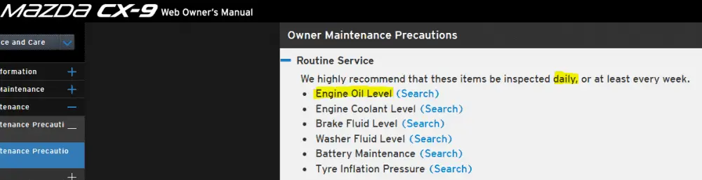

Mazda DOES recommend inspecting the oil level DAILY. But who the hell does this on a daily basis?
jean-luc
2021 CX-9 Signature
After much research, the answer is actually right there in the owner's manual. Now I'm thinking to just cancel my appointment and do my own monitoring for now.
