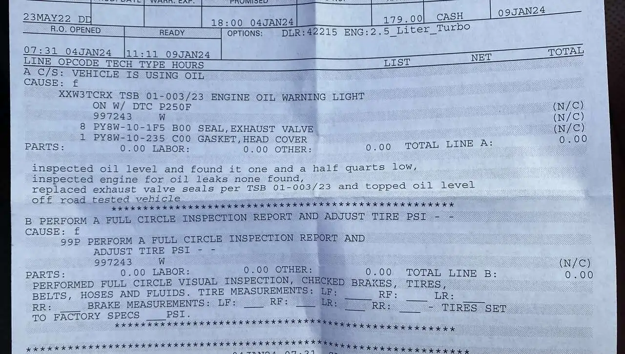

This thread has been a godsend. I'm contemplating buying my lease soon -- a solid car, new cars are stupid $. Is the TSB under the powertrain warranty or the bumper to bumper new vehicle warranty? There's a reason I'm asking since the TSB requires the engine light to be on with the right code in order to get the fix:
I had the light come on first time summer of 22. Dealer saw no leaks, replaced oil. Since then if the light came on I topped off the oil, but more often than not topped it off well before then as I check the oil religiously now. Just took a 1,000 mile trip and that should have tripped the trigger, but nope, the oil is at the same level pre and post trip! WTH? At about 900-1,100 miles I ALWAYS have to add oil.
So what do I do approaching lease end? Drain oil to trigger the code for the TSB? If this issue is under the powertrain warranty maybe I just wait until it naturally trips again?
