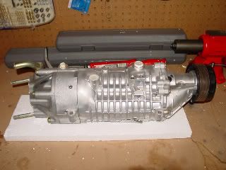

8 hours of installation effort later, with a buddy showing me how to do it, it was in the car...and proved to be bad, sucking as much or more oil than my original. The upstanding gent who sold it to me professed great consternation and also refused to refund any money. Hard lesson No. 1.

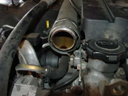

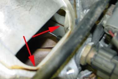

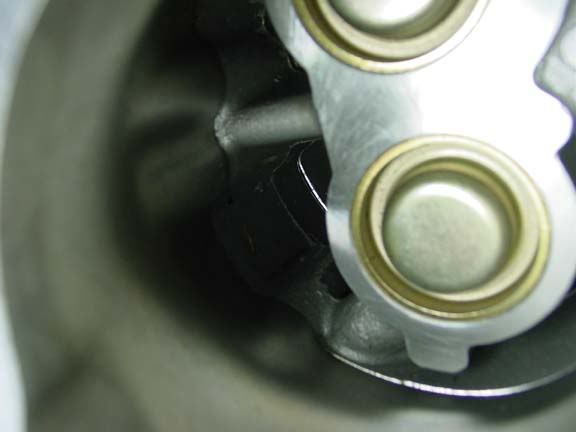

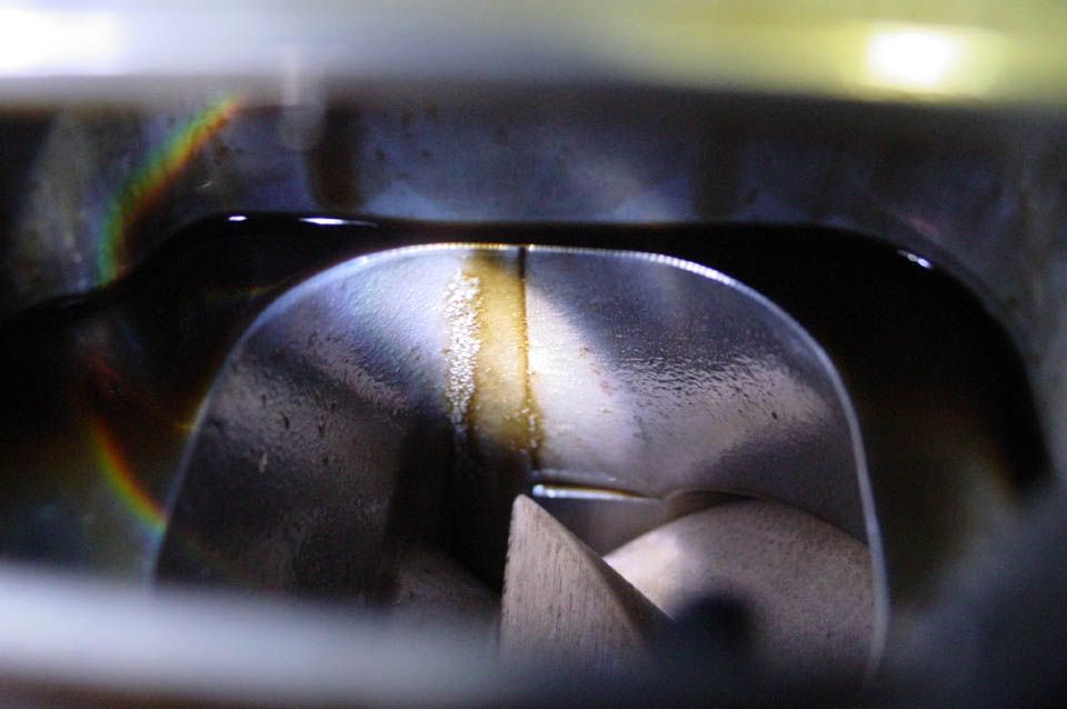

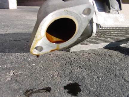

OK, so you think you might be sucking oil into your motor through the blower? Sure fire way to find out quick is to take off the plastic Miller Cycle cover from the engine and open the inspection hatch on the top of the intake plumbing. Four or five bolts if I recall. Once open you will be able to see right down into the compressor housing. If the lobes are wet and/or there is oil pooling in there anywhere...you have bad compressor seals. Sort of like this...
and this...
Easy as that. If you want to be double sure, pull your front intercooler and tip it up. If oil runs out...you're a winnah! as they say. Only, this horse race definitely ain't no fun.

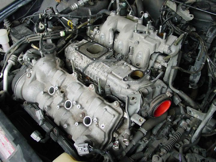

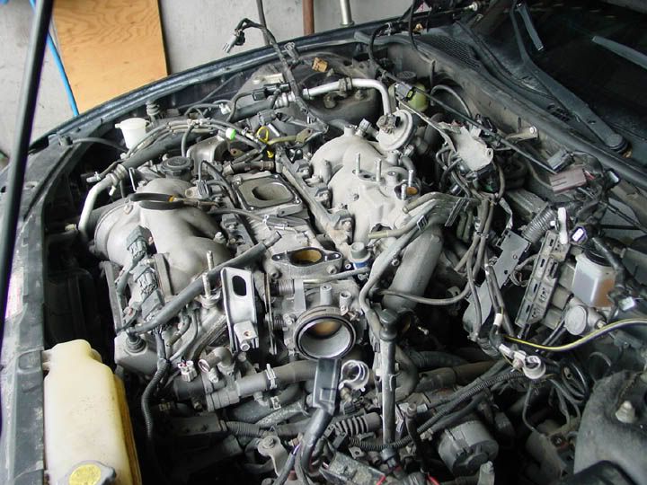

As for the procedure itself, I belive the manual calls for the removal of the intake manifolds front and back. Actually you can get away without doing that. If you remove the fuel rails you can just squeak the compressor out between them. Careful, though, it's awkward as all get out and if you don't pull straight up you will bend a compressor stud. In this shot below the front manifold is removed because of leaking valve cover gaskets (info to come). Also take note of that delicate-looking wire draped over the compressor. That's the knock sensor harness, which runs under the compressor. Be careful not to yank on that.
Other things to consider.
Get replacement copper washers for the high pressure fuel rails before tackling the job. There are three or four required when replacing the fuel system. Don't risk a fire due to leaks from reused washers.
It's also not a bad time to replace your plugs as they will probably be fouled and you have so much off the top of the motor it's much easier to find them.
Oh, and label your vacuum lines VERY carefully! Also be wary not to install any check valves backwards or you will be kicking yourself. They have faint embossed arrows indicating direction of vacuum flow.
It's also a great opportunity to inspect all your vacuum lines for cracks or wear. The vacuum Ts also should be inspected. I repaced a couple of mine and a few feet of line. (There is, I believe, about 20 feet of vacuum line under there.) It gets cooked by the heat as much of itis sandwiched between the motor and other plumbing.
Lotsa plumbing!
Other items to label carefully are the wiring harnesses on the solenoids fastened to the rear valve covers.
You will probably be able to reuse the metal gaskets above and below the compressor if this is the first time it has been pulled. As I'm on number three, I will probably opt for new ones.

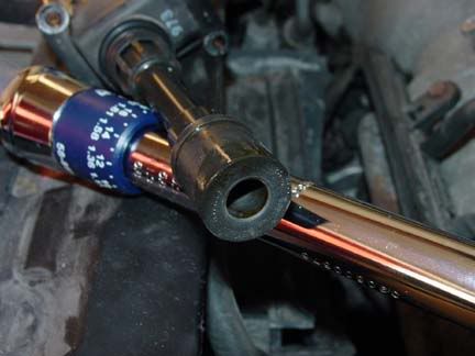

It's also possible your valve cover gaskets may be leaking. Check for oil on the plug boots when you pull the coil packs. Now's the perfect time to pull those covers if you have leaks. I did. A lot like this...
which led to this...
Check the condition of your serpentine belt. Another item worth replacing at this point since you are this far into it.
You will also need to get a couple or five cans of brake cleaner to flush the oil out of your intercooler plumbing. Spray in one side, slosh around the air exchangers until they run clear. Also, dispose of the stuff properly -- not down the sewers!
Finally, get a torque wrench and pay attention to the bolt patterns for the induction plumbing when buttoning everything back up.

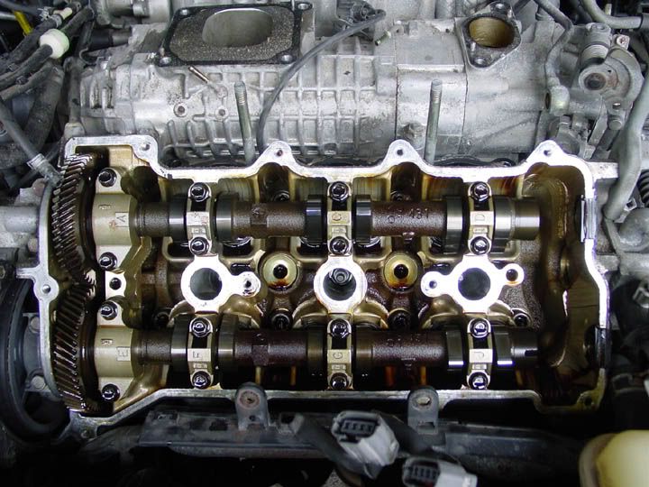

hey sweet pics, can you by chance tell me what the camshaft codes are?
The intake one is probably something like KJXX 431..
