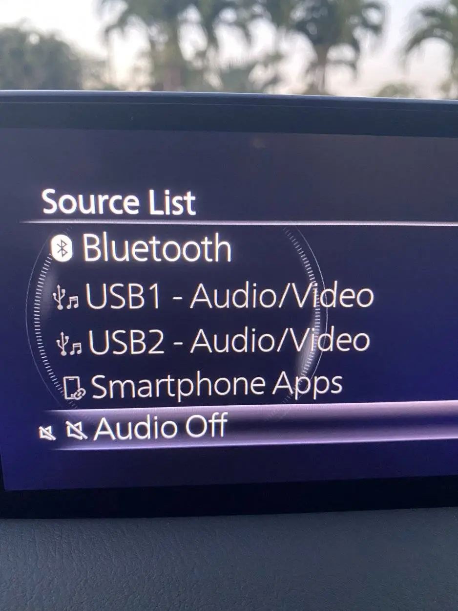

Hi, barely 24 hrs in my 2021 Touring CX-5 and the audio system stopped working. I connected apple play for less than an hour and the audio suddenly stopped. I can see the song in the infotainment screen but no sound. I toggled the volume and it doesn’t even display the volume meter.
After disconnecting apple play, trying Bluetooth, doing a hard reset, still nothing. I can’t even select the radio, I tried selecting FM and nothing happens.
I took a picture of this audio off display, I’m not sure if this is normal?
I called my service center, and they said it was related to the most recent iOS update. I am dubious, but will try again later today without connecting to my phone
The Mazda service center is blaming the lack of sound from your infotainment system on your phone update?

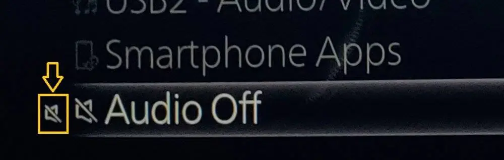

Happened again for me today (no audio). Seems like it happens more often when running errands and restarting the car after it has only sat for just a little bit, vs when it has sat overnight or something. Still intermittent where I can't pin down the exact scenario, but just seems more likely to occur when running errands where it recently ran and you're hopping back in the car and starting back up.
It will show the muted like extra icon below (this was taken while it was doing it) but no unmuting via the knob, nor changing source, nor any other function I've tried gets the audio back. The volume knob as mentioned before doesn't display on the screen when using it, and you cannot get it to change to FM or AM for example (cursor just blinks on it, but just sits on the source screen rather than going into FM or AM). Most of the time the audio works fine, but absolutely annoying when it does happen.

Have this same problem on my 2021 CX5 Sig.
I don't know what triggers it. It doesn't happen often. I have about 5k miles on it and it happened 3 times.
- screen display of the double muted speaker icon is the same as in the OP photo
