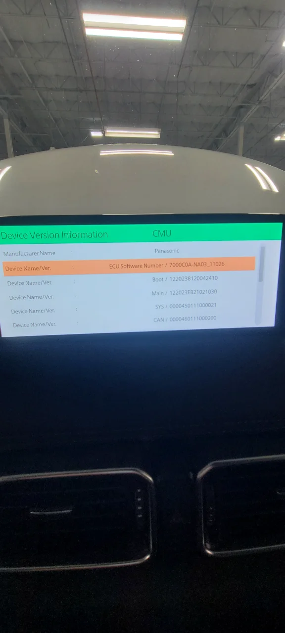

I hope you are doing well. I own a Mazda CX-5 2022 imported from the USA, and I would like to change the system language to Polish. I understand that this requires updating the firmware to a European version.
My current firmware version is: system software 11038 gracenote databese 1.1.102071
Could you please help me obtain the latest European firmware version compatible with my vehicle? I would really appreciate your assistance.

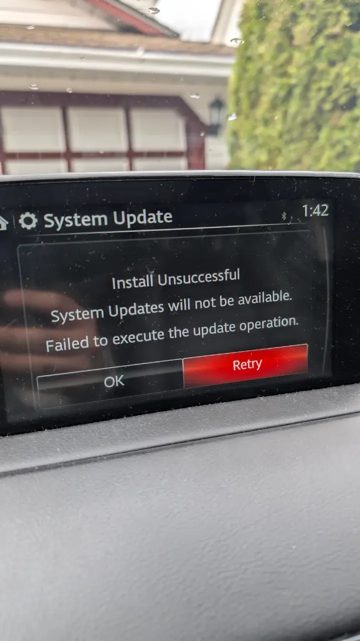

Anyone seen this error B4? I have a 21 CX-5 and need to update it. Previous owner apparently tried and failed OTA
