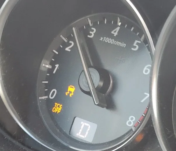

I have a 2013 Mazda CX-5 that is showing TCS Off and a Sliding Car Icon on the dashboard. The car has NO TCS Off button.
Please assist with how to turn it OFF?

That seems to be a fault then.

I have two suggestions, won't cost you anything:
1. Turn the engine on. Turn the steering wheel fully clockwise, then turn it fully counter clockwise then back to the centre. Turn the engine off, give it few seconds and turn the engine back on. The lights should disappear. If nothing changes, try no.2 .
2. Press the start button without turning the engine on, just the ACC mode. While pressing the start button, simultaneously press and hold for at least 5 seconds the panel illumination knob or until the master warning light flashes. Once the light flashes for few seconds, the ECU resets and hopefully it will make your problem go away.
