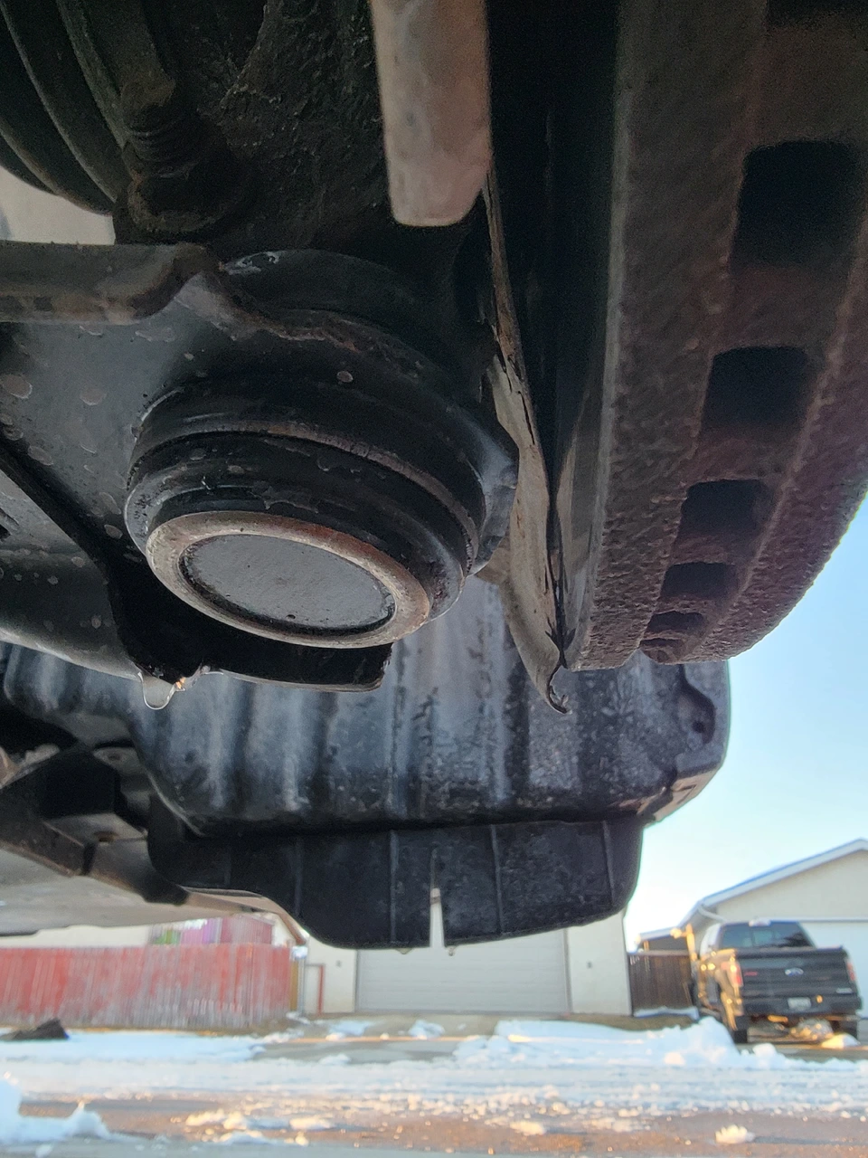

Front passenger side LCA bushings are shot. The front passenger strut has also started leaking and making noise. I guess the suspension had finally had enough after 3 years on Corksport springs and the multitude of pothole hits over the last 2 years.

Initially I thought it was my balljoint going bad. I jacked the car up and pushed/pulled the wheel at 12 and 6 to check for play, and there was a tiny bit. When I tried to move the whole wheel by pushing/pulling at 9 and 3, I noticed that the movement was happening at the LCA's bushings.

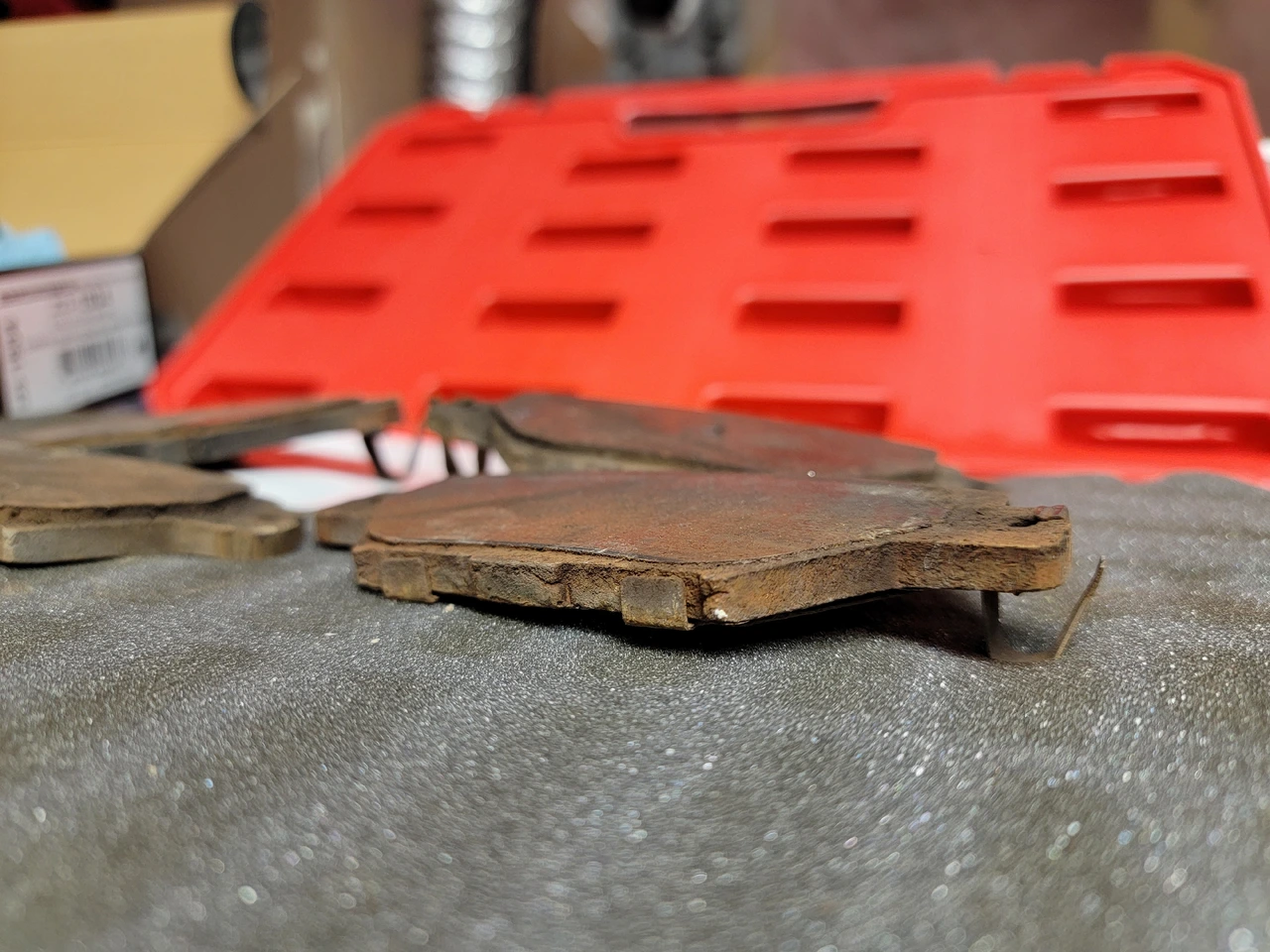

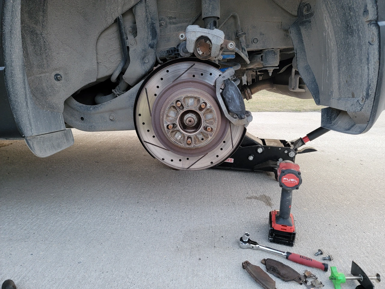

Changed the rear pads yesterday. There's a bit of scoring from the pad wear indicator, but nothing major. It was quite a simple job overall, but I did have two time-consuming hiccups. The first was getting the pads into the clips, and I also had some trouble getting the car out of maintenance mode. What finally ended up working for me was going slower on the last three Start/Stop button presses. Those two things added an extra 40 mins to the job :cautious:
Anyway, I went for a drive to bed the pads and all is good now. At least until the rear shocks give out, lol
One of the pads wore a bit quicker than the rest, and almost went down to bare metal. It's a good thing I took care of this right away.
Changed the rear pads yesterday. It was quite a simple job overall ...
That pad was down to its last breath, that's for sure. Surprised it was still doing the job.

I too struggled to get the pads into the clips. Had to walk away, maybe why it's easy to get frustrated and get it in bent. Once it goes in it's clear that it's in.
Are you reusing the rotors, new pads?
Did you machine finish or just simple replacement?
... but I did have two time-consuming hiccups. The first was getting the pads into the clips, ...
... I too struggled to get the pads into the clips ...
Could you be experiencing some rust jacking of the caliper bracket metal under the clips? Do you replace the little metal clips or reuse the old ones?
My routine is pop the clips out, (mechanically) wire brush the bracket where the clips reside and then a light file to remove any remaining corrosion. Coat the fresh metal with some anti-seize or grease and install new clips (or your old ones if your kit doesn't supply new hardware)
