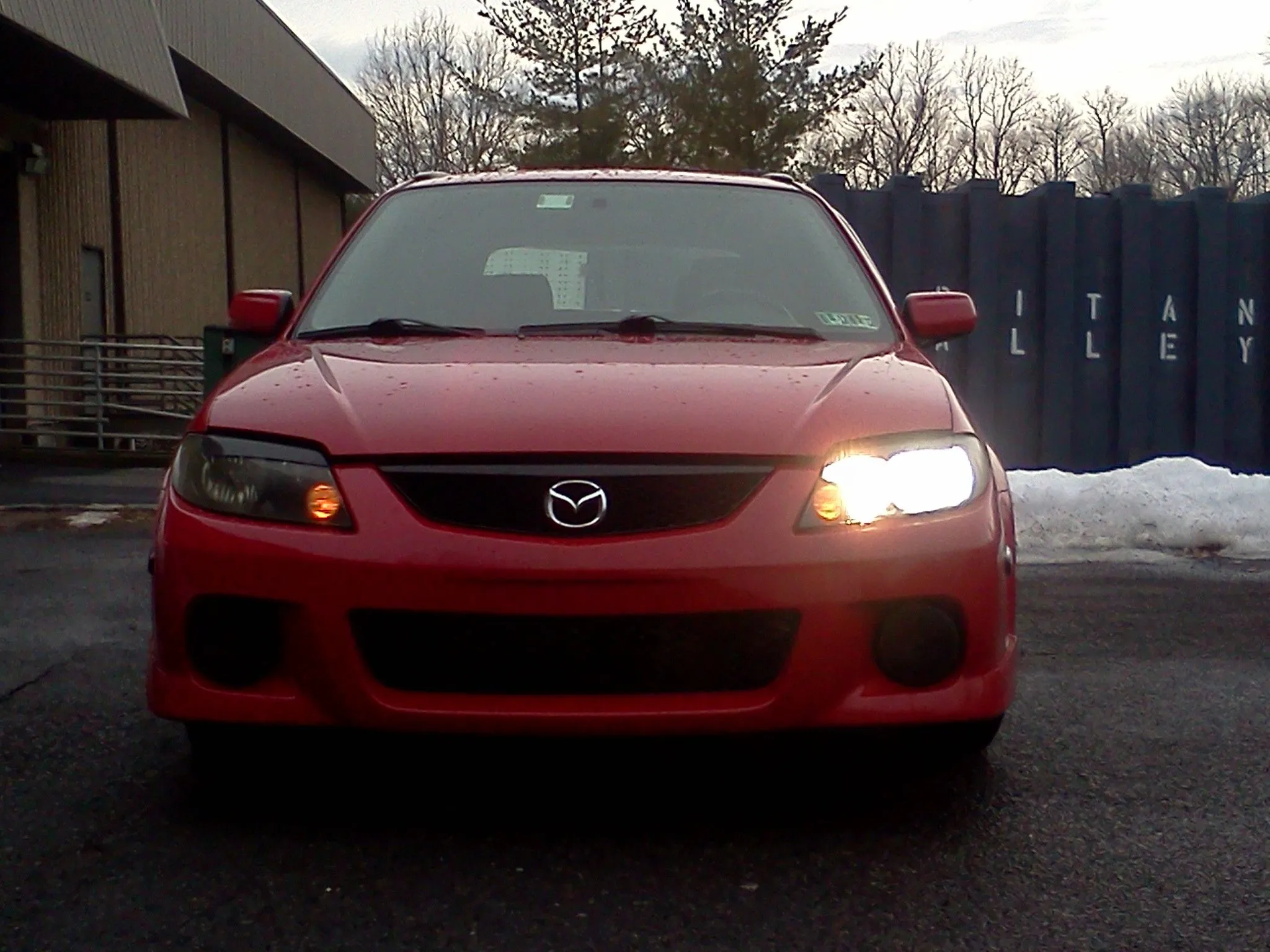

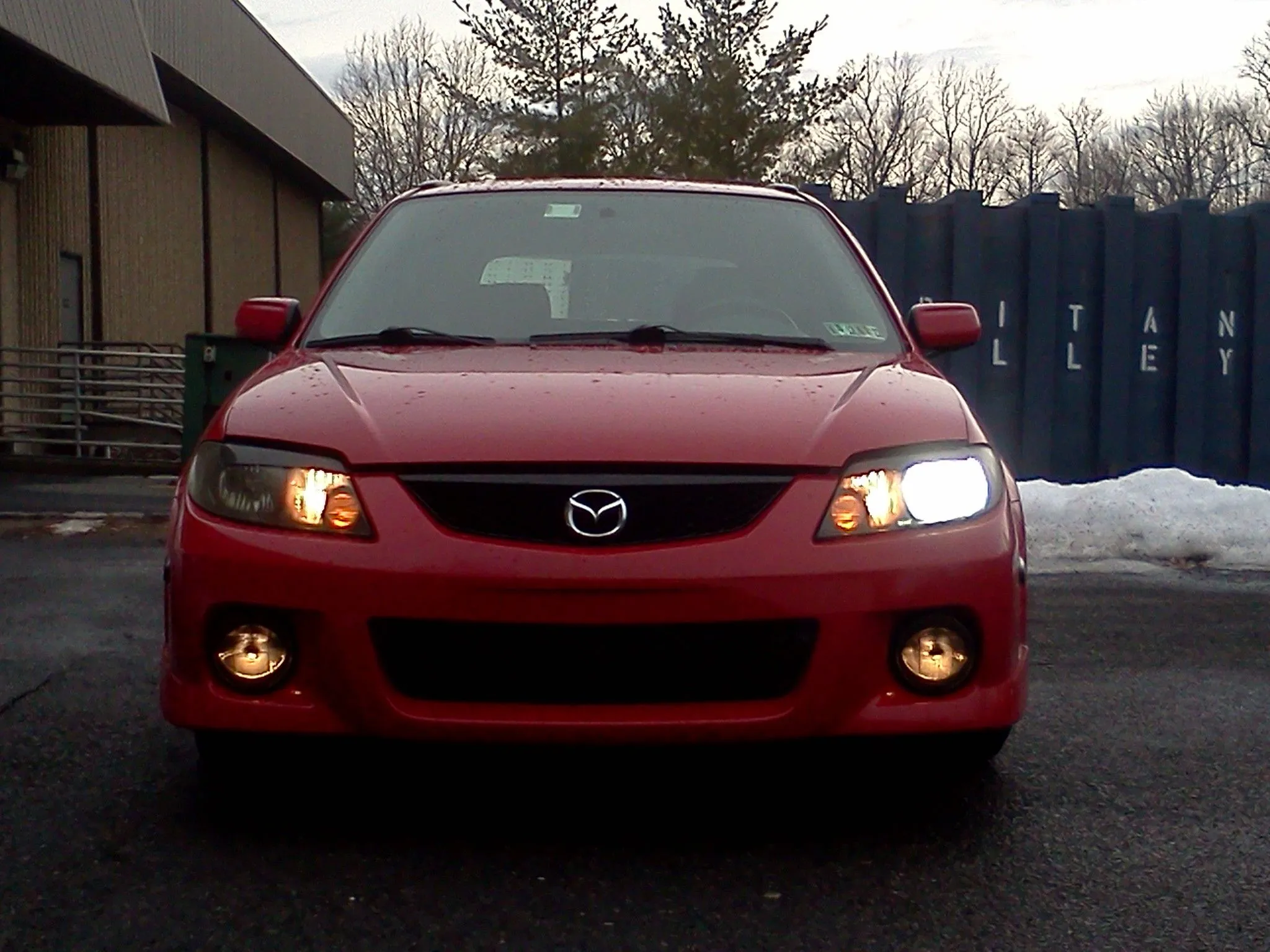

Couple of pics I took yesterday of my current light issue. Didn't fix it last night as I didn't have time and I have the wife's car today so tonight or tomorrow I'll be swapping parts. First pic is with hi-beams on and second is with them off....
