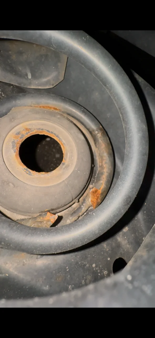

Thanks for the responses guys. Well after taking a harder look today it seems I have found the source. Turns out the rear driver side coil spring broke at some point.
Now there is a TSB out on this very specific issue for my vehicle (TSB: 02-015/18). Since it failed in the exact way the TSB describes and it is a safety hazard, do you believe a Mazda dealer might cover the cost through goodwill assistance? Would they cover the cost of replacing both rear coils as I’m sure the rear passenger side coil is part of the same potential failure batch.
Not to mention, the updated designs are different than the old, so fixing one side would mean the car might sit weird with the updated design only on one side. Anyone have experience with this scenario, am I SOL?

In this case, the TSB clearly admits a design defect, with a solution that replaces the defective part with a redesigned part. You can try to make the case that this is a safety hazard. If I were you I'd be pushing for replacement of both coil springs since you wouldn't want to risk the other coil spring breaking while driving.
If they don't want to provide any assistance, I would buy only the springs, then get a quote for replacement and compare quotes from an independent shop.
TSB's aren't federal recalls. The OEM (Mazda) is saying, on the record, there's something wrong, but they are not legally obligated to fix it or help financially. Recalls are, by law, required to be fixed by the OEM. Recalls by nature mean that the defect has a high probability to cause bodily harm or death to passengers inside the vehicle and or other drivers on the road. TSB's are still very helpful as they allow the local dealers to quickly identify common issues and have Mazda approved fixes for those problems. But the cost of parts+labour are on us (the consumer). IF you have a really great relationship with your local Mazda dealer they may cut you a deal, possibly use a warranty labour rate instead of their standard labour rate. But yeah. The more you know! :)

Little update here. So our local dealer has no interest in providing any type of coverage or discount. Originally they said because it’s over 10 years old they can’t and then I let them known it’ll be 10 years old actually this August. They proceeded to find another reason not to lol. I also asked the labor time since the TSB shows 0.4 hrs for replacing just one side coil. He told me their dealer books say 1.2 hrs for coil replacement for one side.
Mazda USA was of no help either; they made a claim that Goodwill assistance even has a deadline like 125,000 miles or something. Regardless, thanks for helping me narrow this problem down guys. Cheers!
