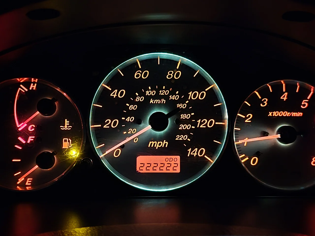

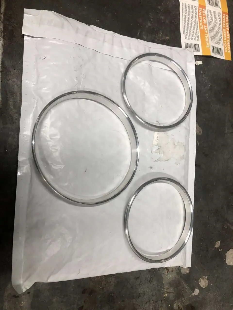

IMO, those gauge rings are the best aesthetic interior mod for the P5! It hurt me to remove mine, even though I was trading the P5 in. lol
Looking forward to installing them. Wondering if there is a video/image link for the gauge cluster removal, and access to the gauges/bulbs?

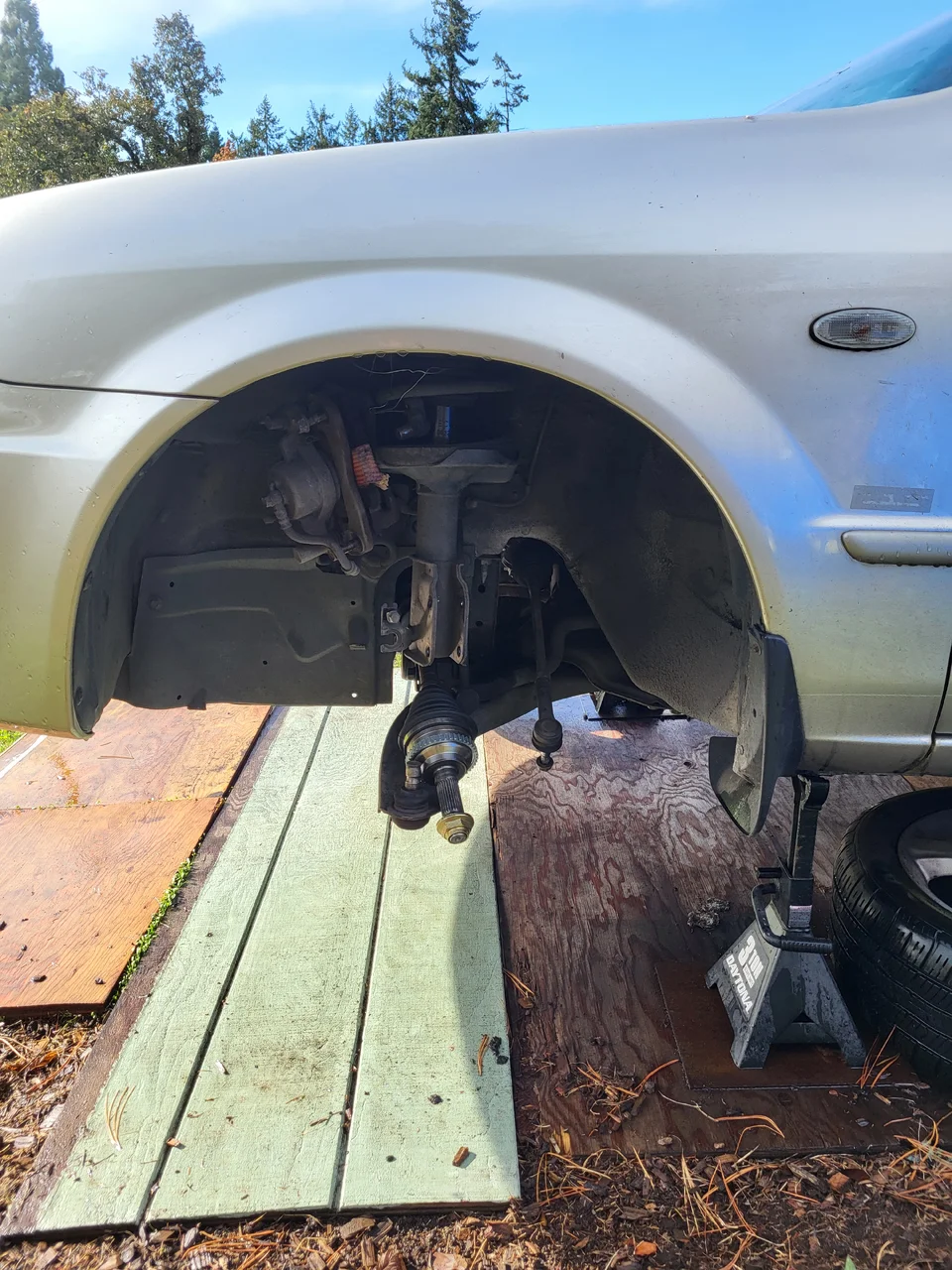

It sat for like a month while I tried to replace a siezed axle that was making an obnoxious clicking noise. The axle was stuck in the hub. Ended up getting a used spindle/hub and putting a new axle in. After all of that, still makes the clicking noise. Guessing it's the diff or a trans bearing. Car just hit 230k, runs and drives well. I just ignore the noise now.

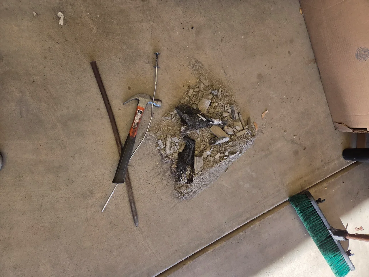

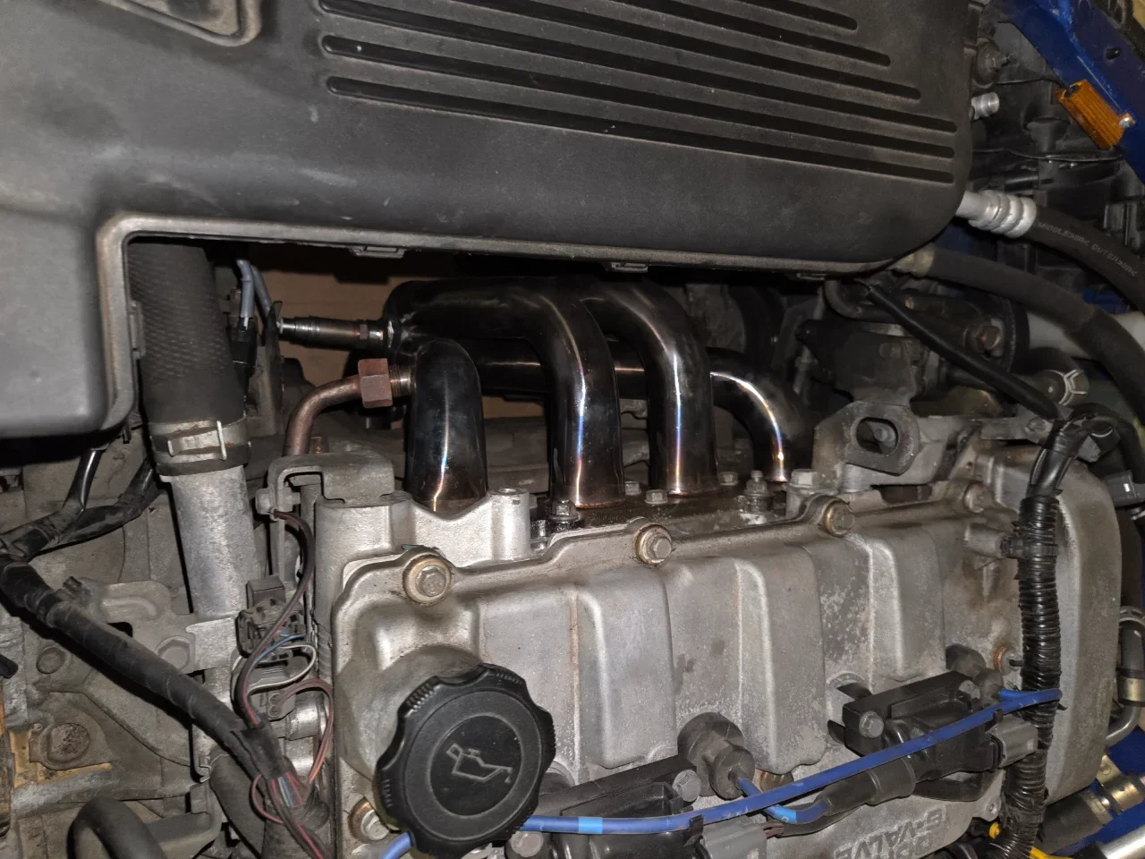

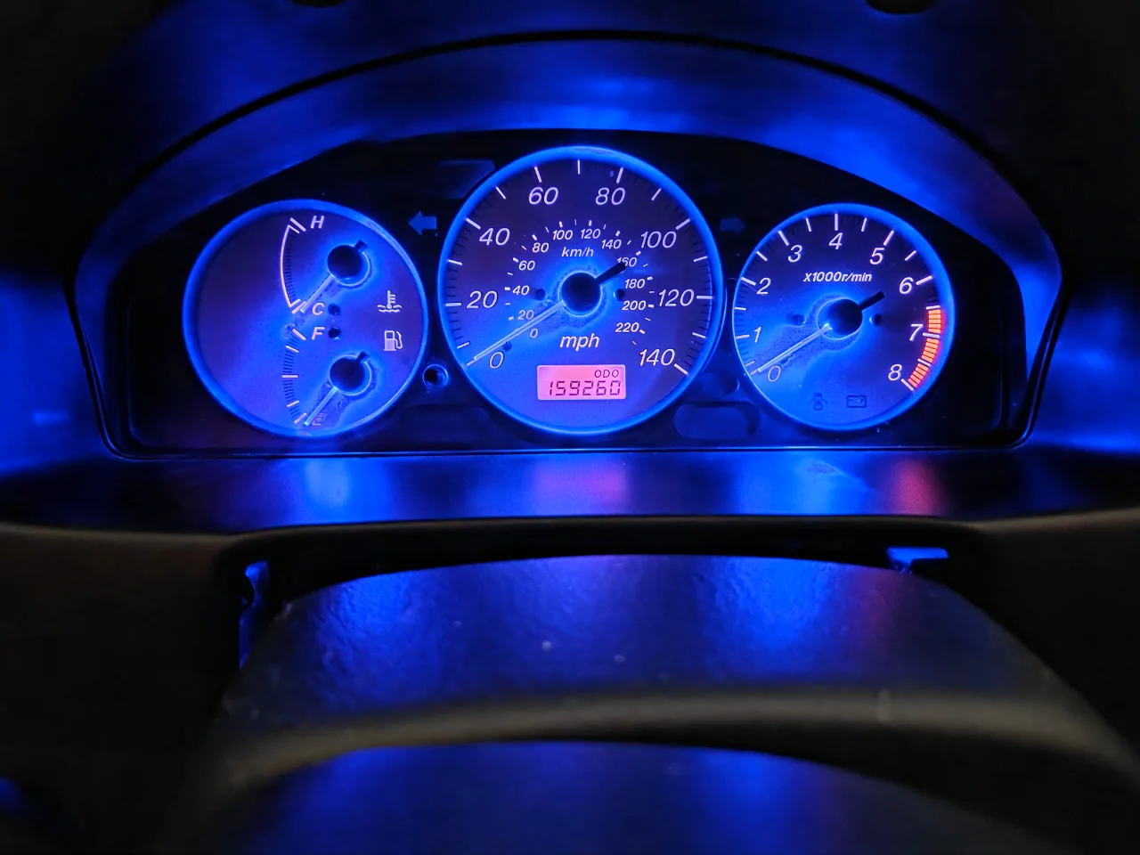

Put these in a few days ago. Blue LEDs for a consistent look. Also gutted second (only one now) cat, allowing less restriction in the "almost" stock exhaust. Pile on floor is what's left of the catalyst.
I'm doing the same as you with header to the stick exhaust albeit sans cat guts.
Let me know how you like it and how it changed the driveability of the car as well.
Are you running OEM muffler?
How's the tone now?
How's the tone now?
Car seems to have gained a very slight bit in torque as it's seat of the pants feel is that it pulls easier up through the gears and higher RPMs seem to be attained more fluidly. The resonator behind the second cat gained a small "resonance" (vibration) at 3500 RPM, but mostly when cold and I don't hang out at that point long. Will most likely go away if I put a cat-back system on.
Good to know and thanks.
That's exactly what I'm seeking with my Protege.
Nothing noisy, not racing, but a sweet running car setup for longevity. 👍

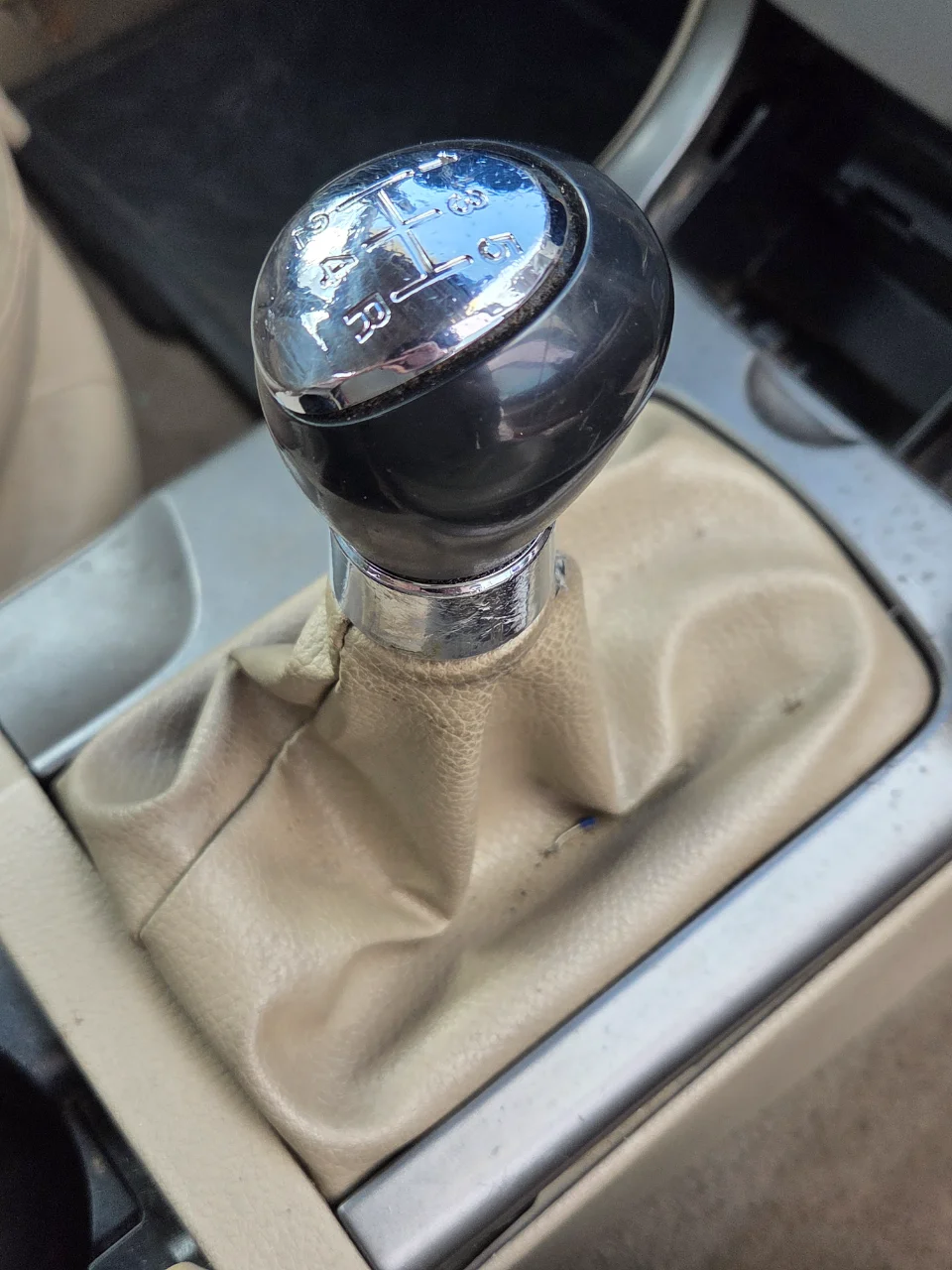

YES! Would not have bought one without the 5 speed. Now if it only had a 6 speed and a 2.3 Speed motor. This will do though.

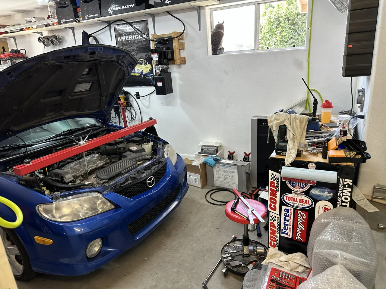

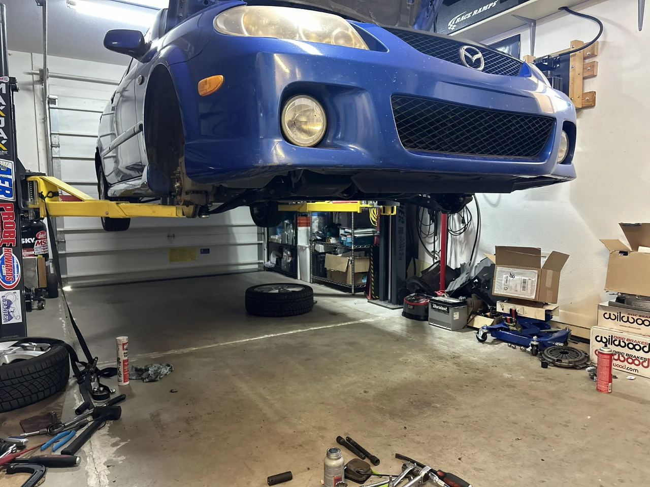

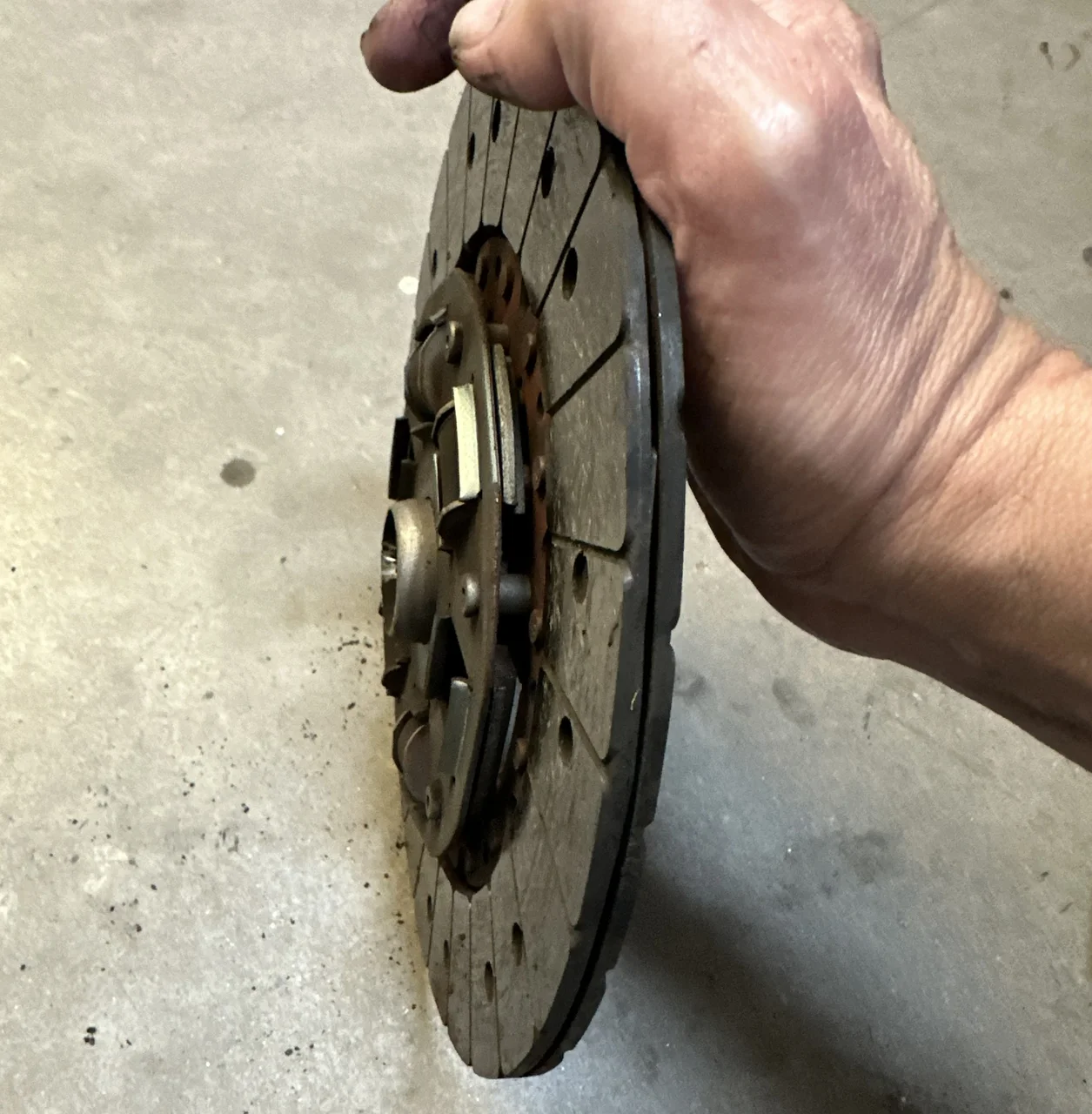

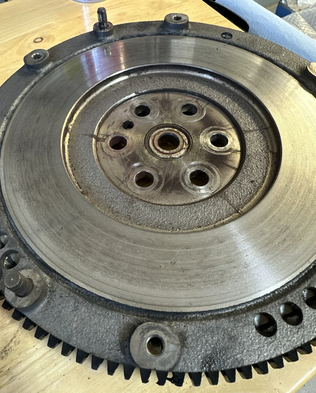

It's been a long while since I had posted anything of substance. I decided to finally attack the rear main seal replacement job. I added in several other "while I'm here" things to that list.
Rear main seal, clutch replacement, oil pan reseal, plugs, wires, oil change, trans oil change, axle rebuilds, valve cover gaskets, etc, etc.
For having 225k miles on it, my OE clutch was in great condition. I'm sure it could have lasted many more miles with my driving habits. Either way, everything is completed and the Mazda made it back to being my daily transportation this morning without complaint. There are still a couple of very minor things that I want to do before I put a bow on this and call it done, but I'll likely take a weekend off before getting back to it.

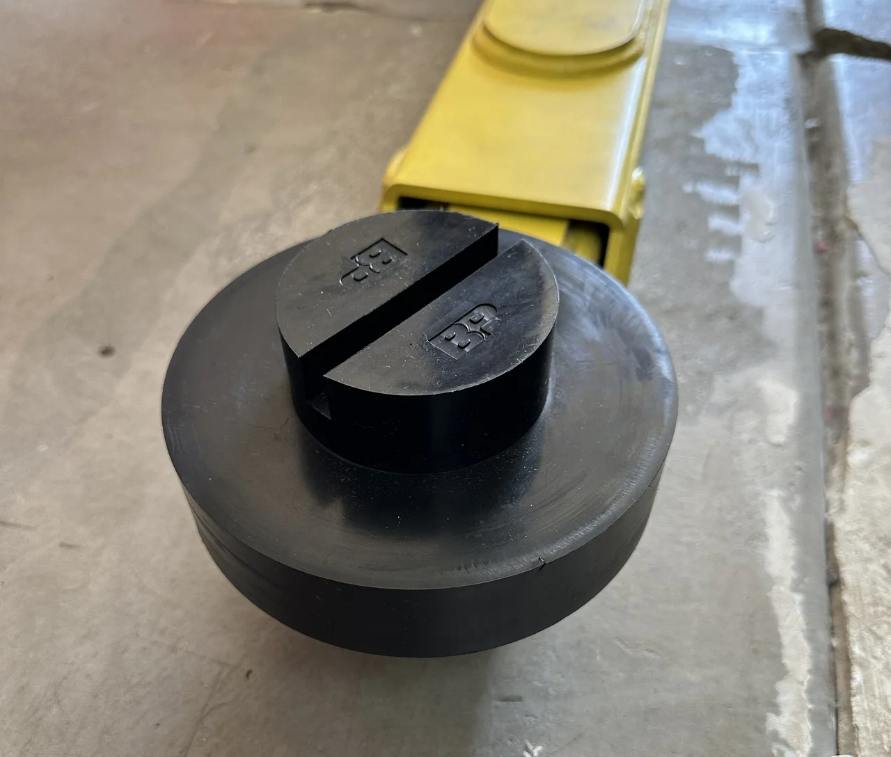

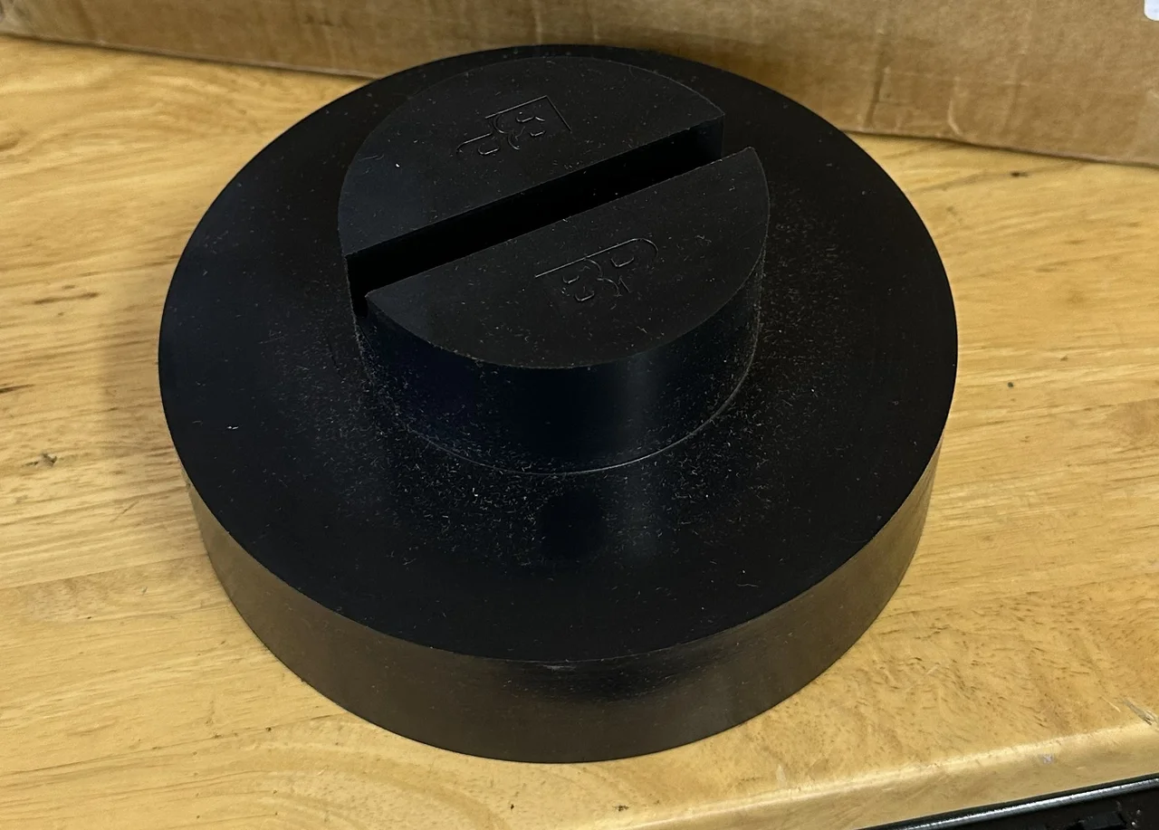

I also finally got the pinch weld pucks that I've been wanting for my lift. I know that there are varying opinions on their usefulness. Either way, I have some now and use them to prevent damage to my lifting points.
