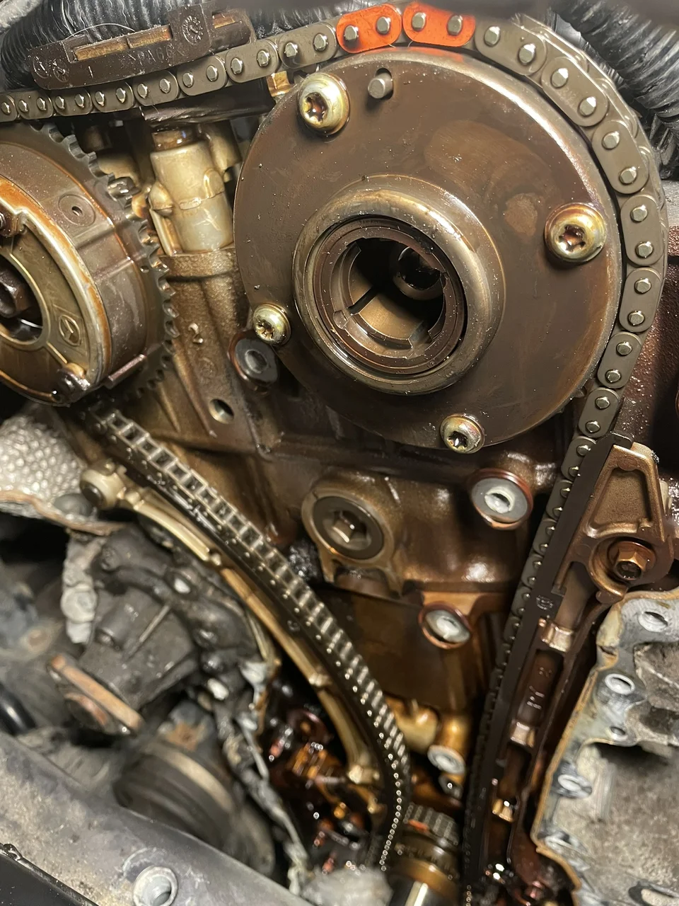

Tonight's progress: Got the engine supported from below, removed the engine mount, alternator. water pump pully, crank pully finally the timing chain cover!!! There are a TON of bolts on that cover. I'm sure I removed a couple I didn't need to.

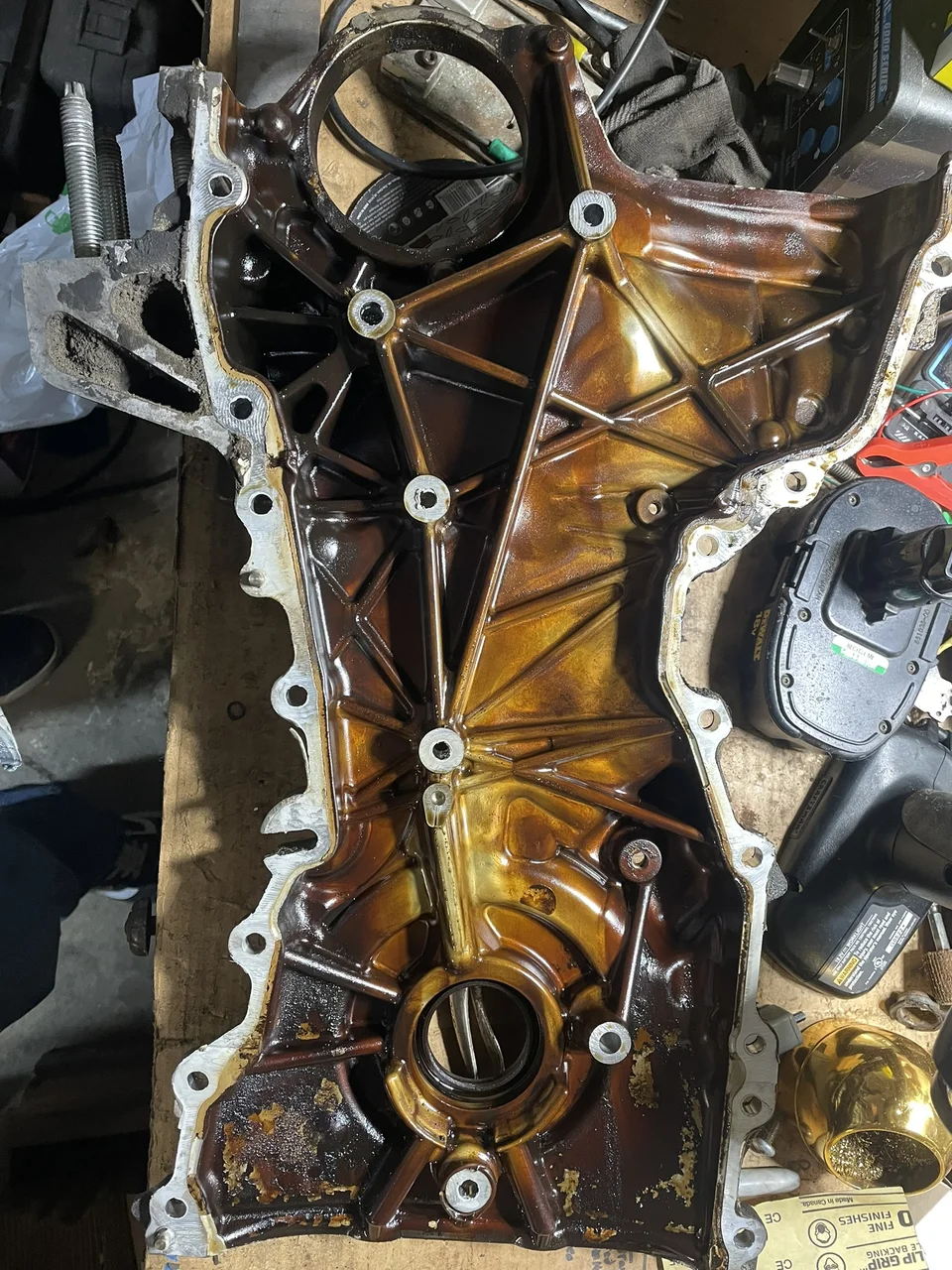

I'm attaching a couple of pictures in case you'd like to see what the inside of the timing chain cover looks like aft 300k miles. Found a couple spots of sludge, but so far nothing too shocking.

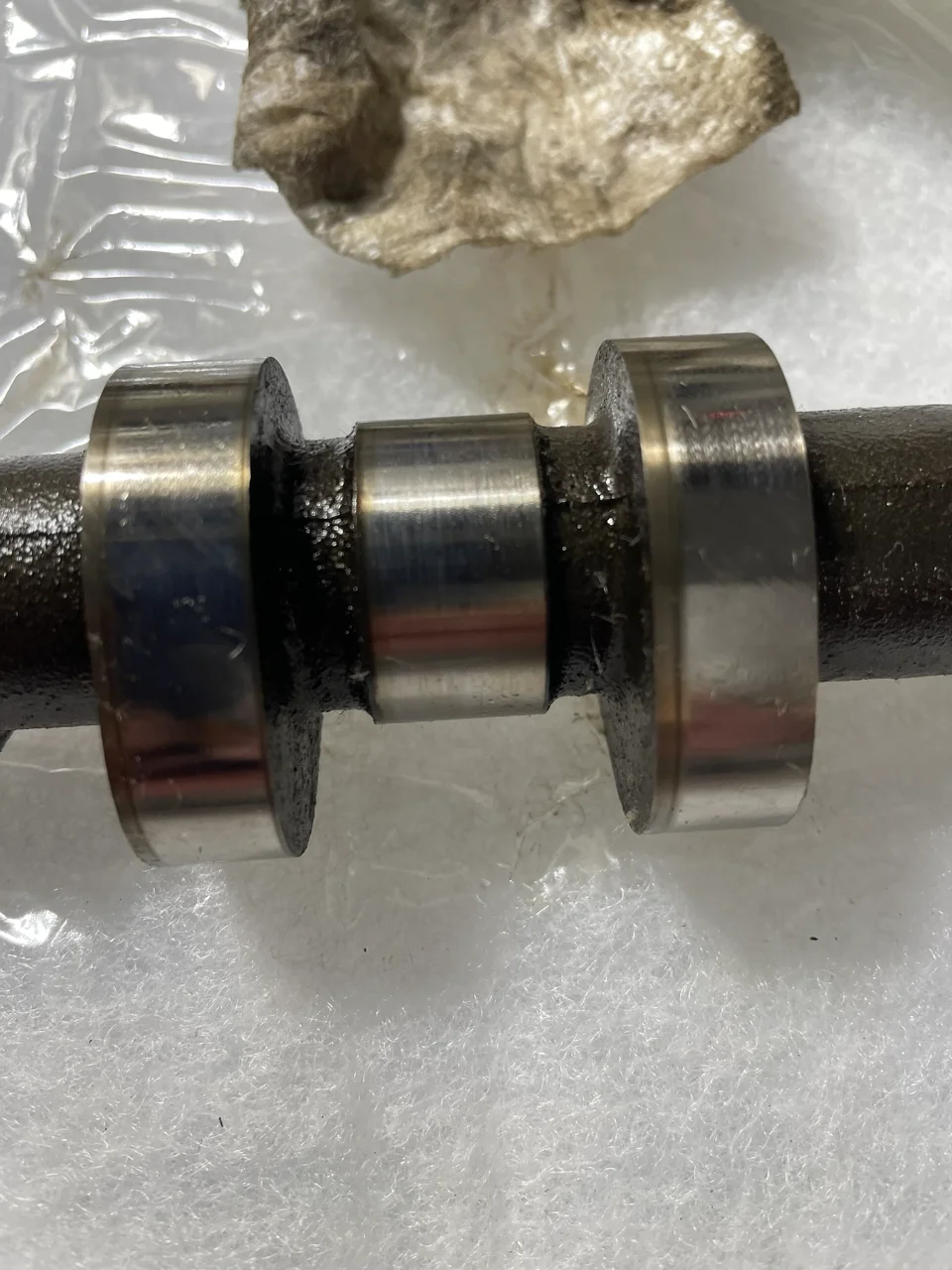

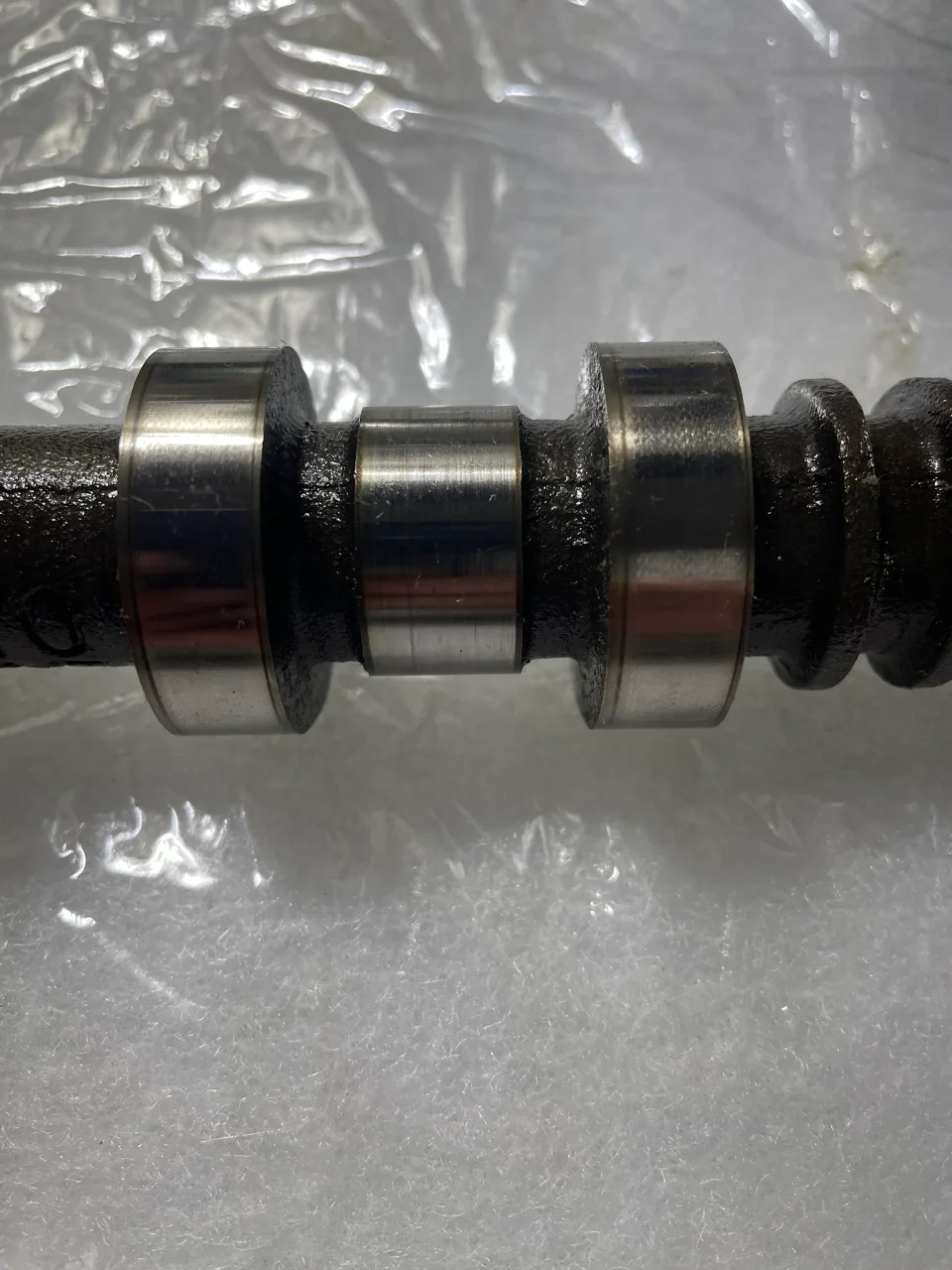

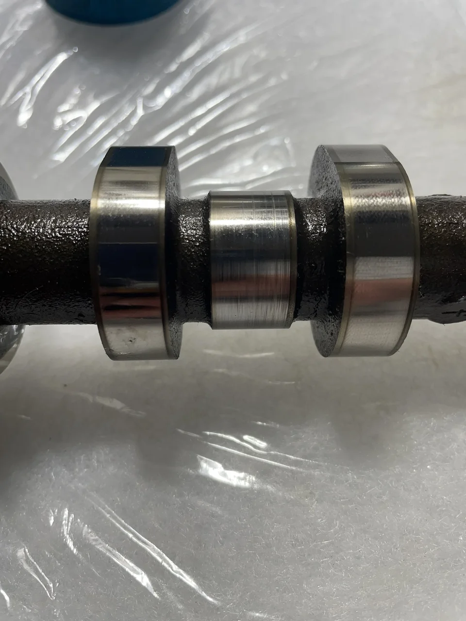

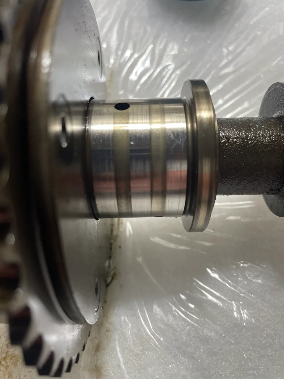

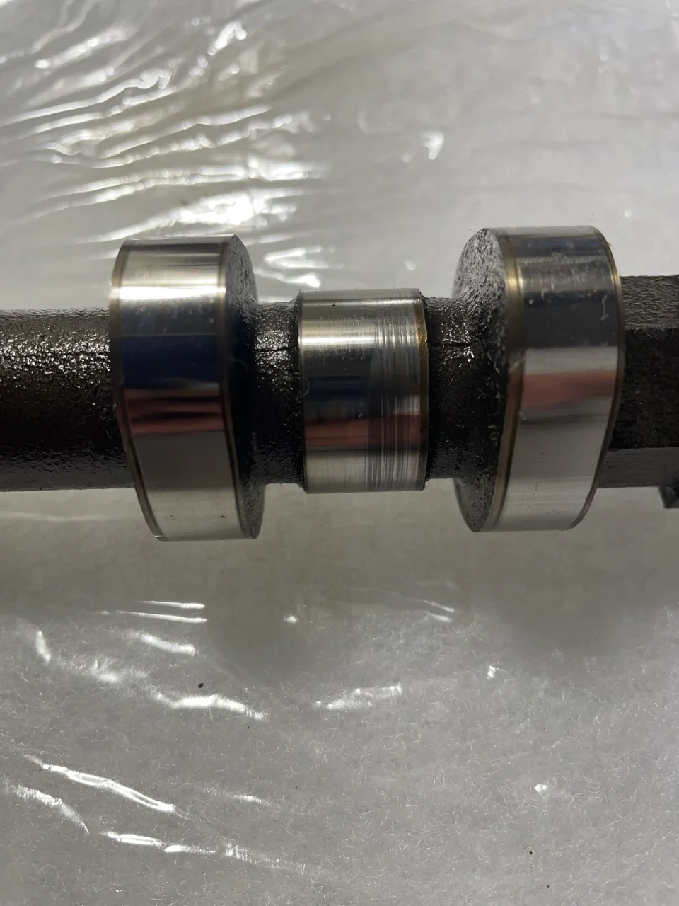

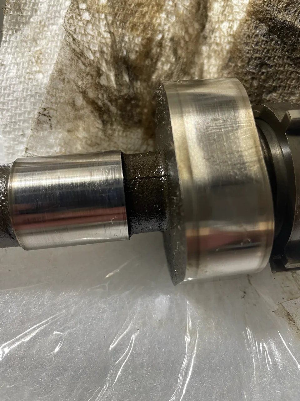

Saturday I got the timing chain off and cams out. There seems to be a good bit of wear on the rockers, but nothing really bad on the cam lobes. I found one cam journal that has the slightest ring on it that just barely catches my fingernail. I hope it can be polished out.

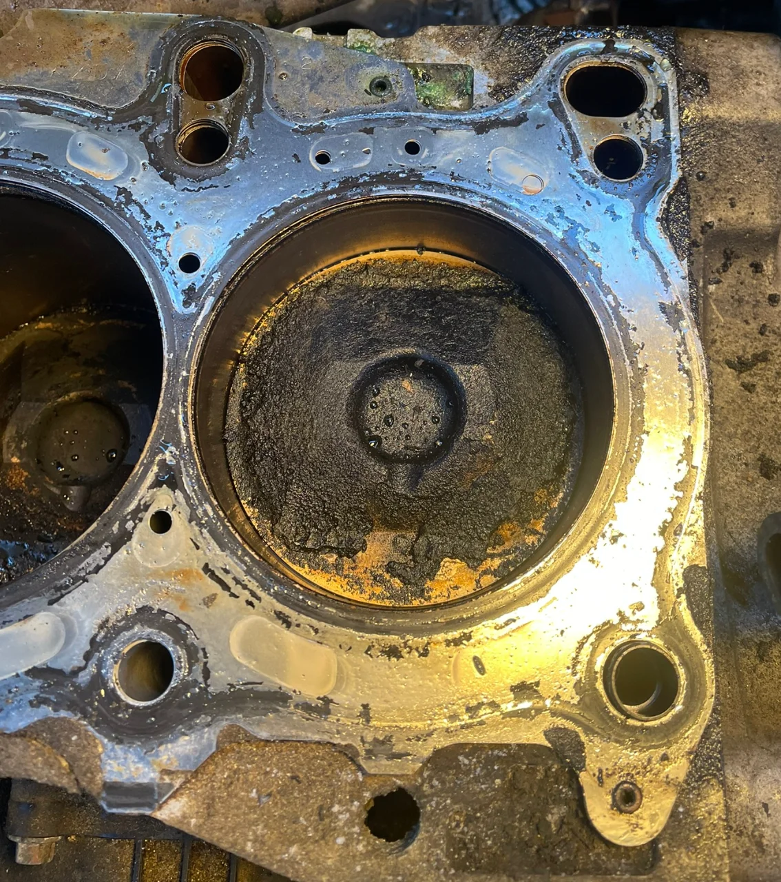

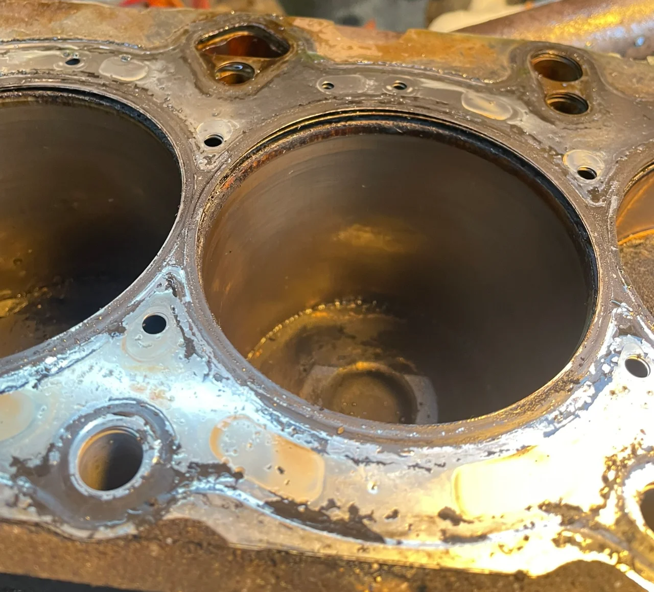

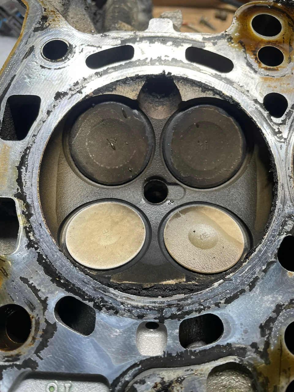

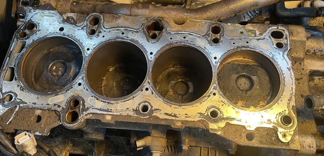

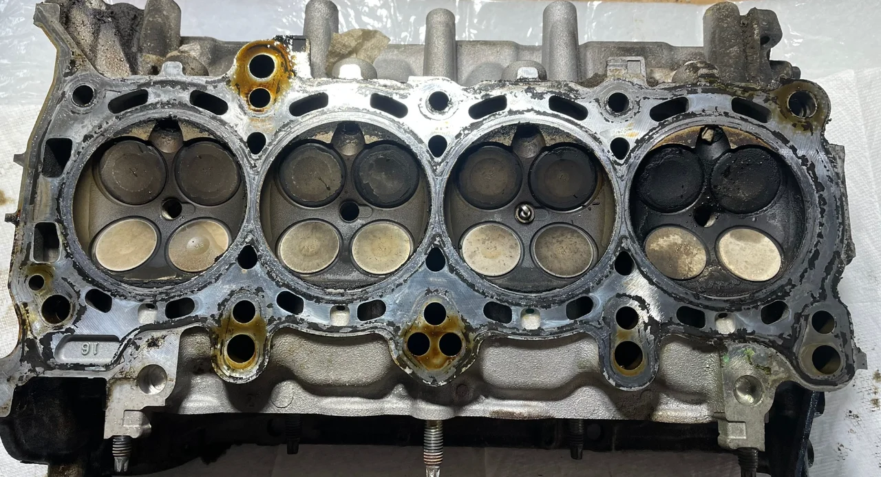

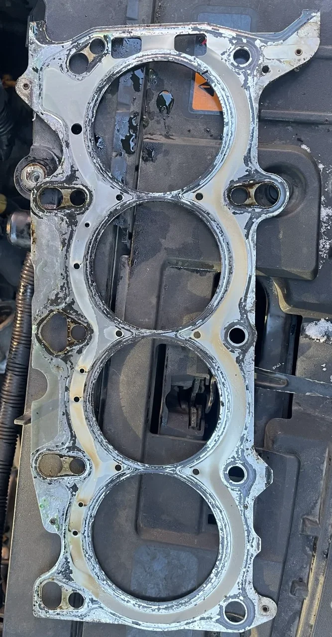

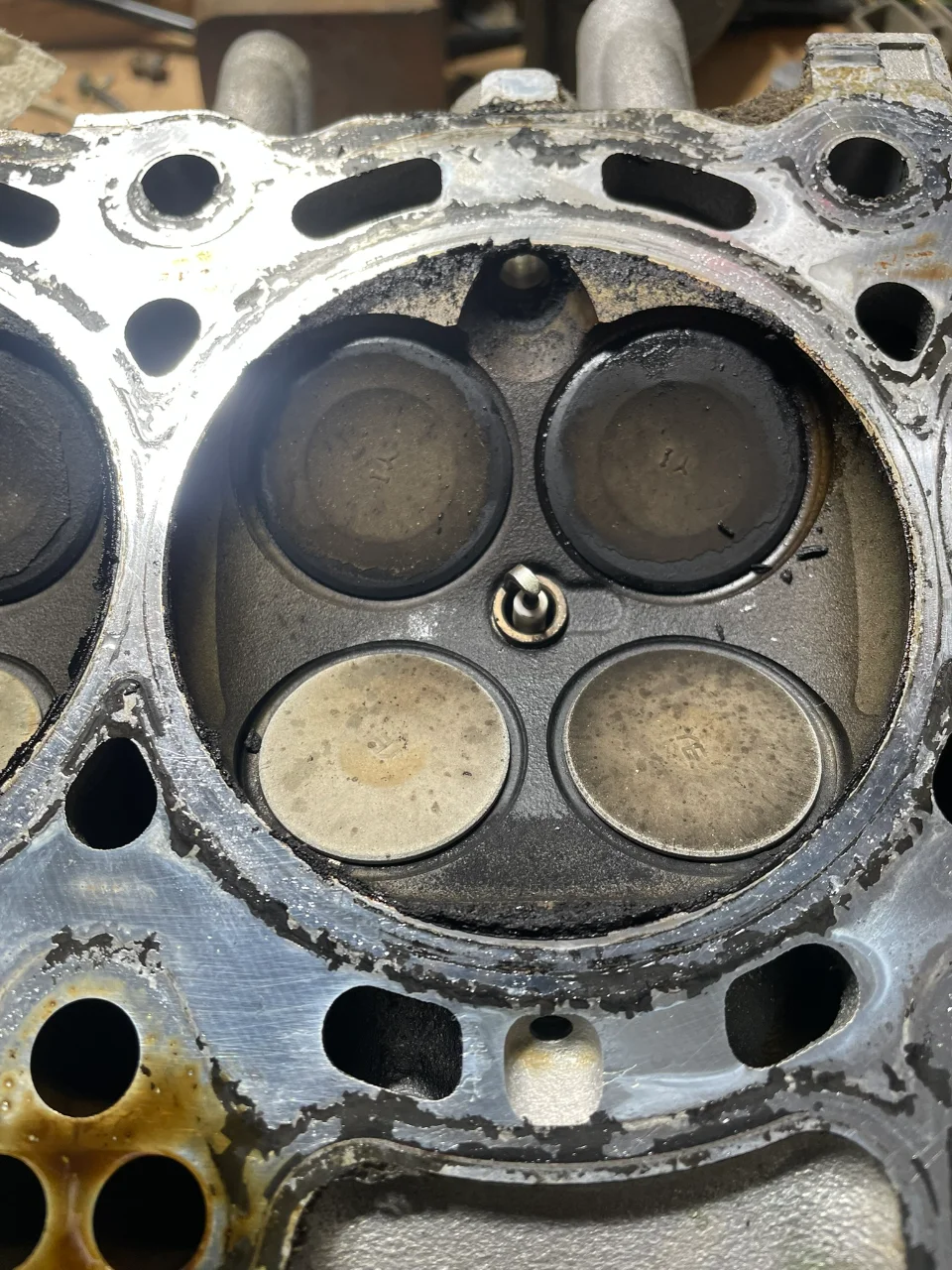

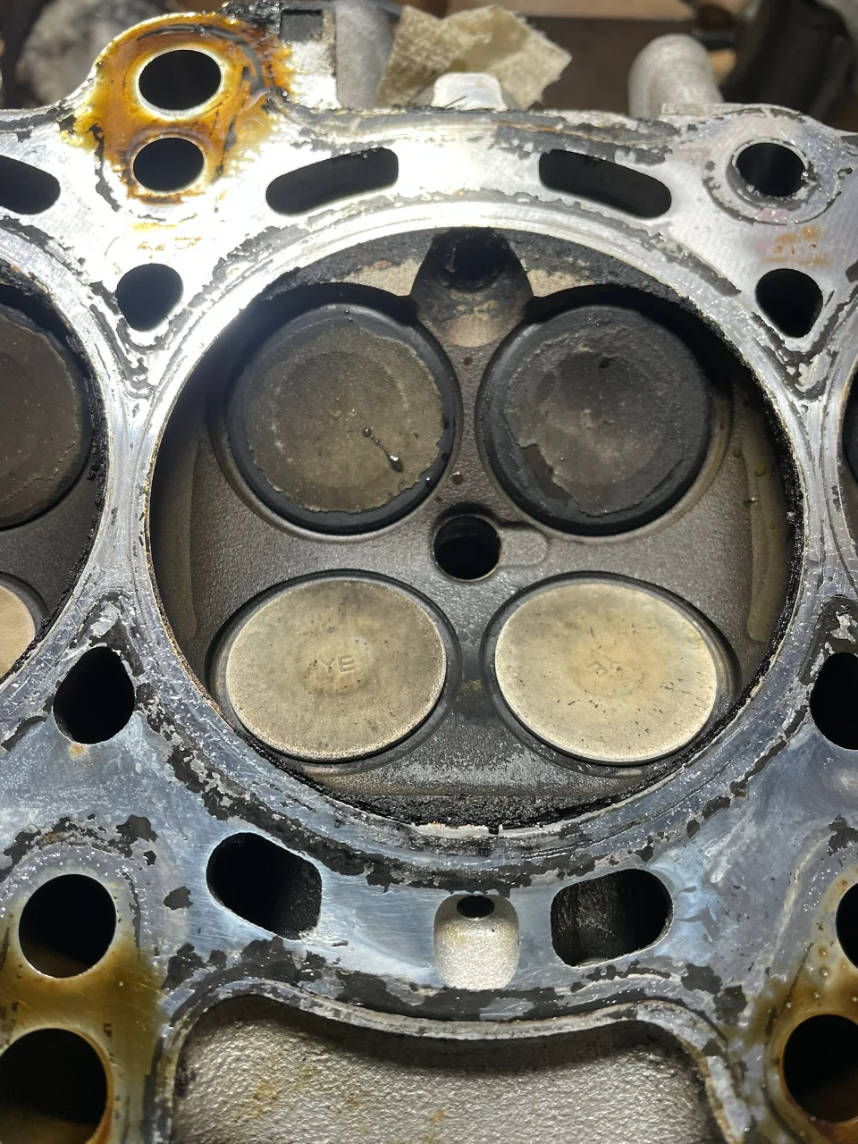

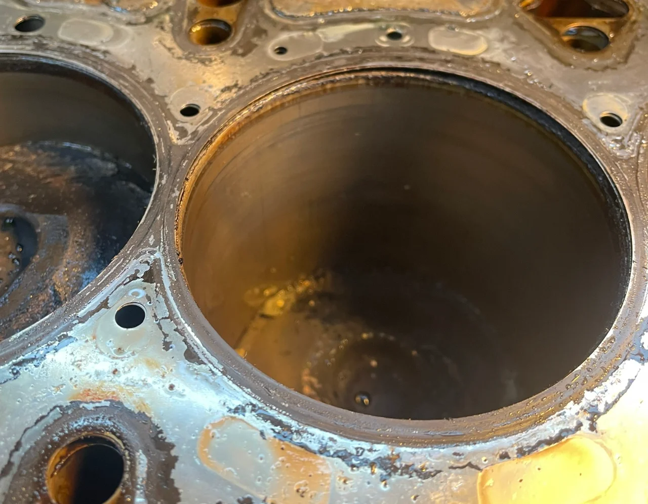

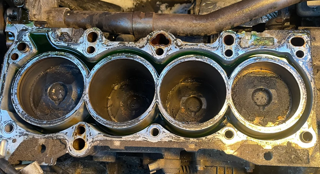

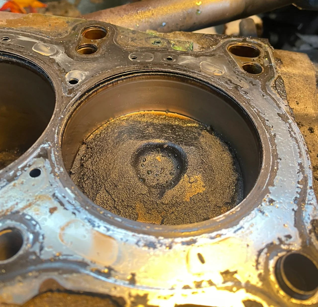

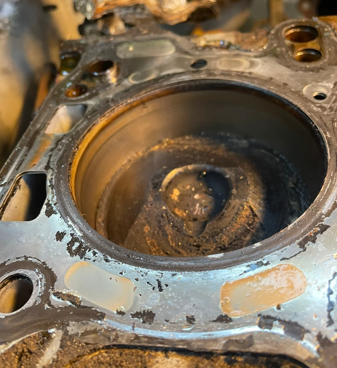

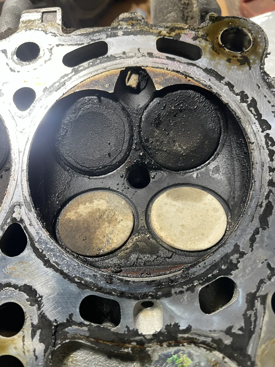

And today I removed the Head. I checked all over as best as possible and can't find any cracks. Head Gasket didn't seem to be blown out, and the cylinder walls look okay to me. Sure, they've lost their cross-hatching, but there is no ring ridge, or scoring that my fingernails can catch on.
You can pretty easily see which cylinder was burning oil For that one I did spray some Penetrating oil down on top of the exhaust valves, and one did leak. The intake valves amazingly didn't!
Please let me know if anyone sees anything I should be alarmed at. I hope to take the head to a machine shop to get thoroughly checked out this week.

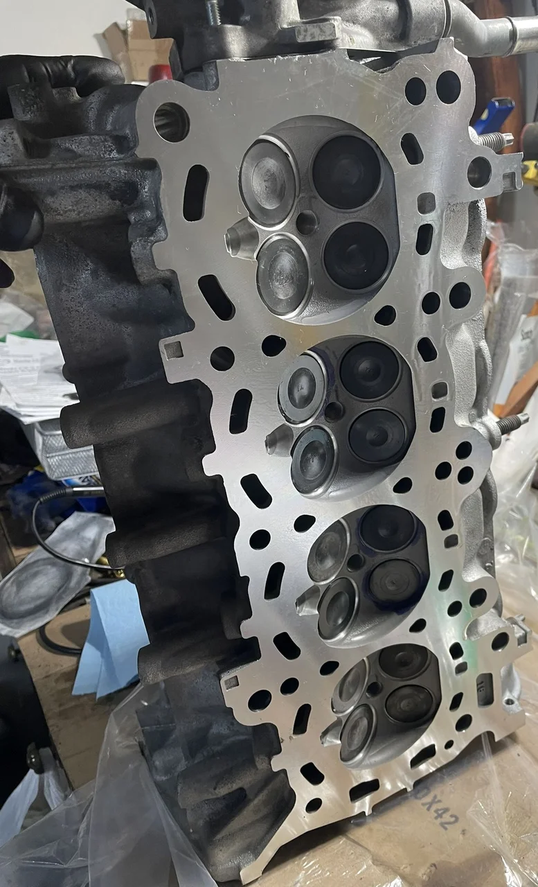

Just an update. The machine shop verified that the head has no cracks, and did find pitting in the valve seat. They are doing a valve job, decking the surface and will replace valve seals. Hope to have it back next week sometime and will start the rebuild process.

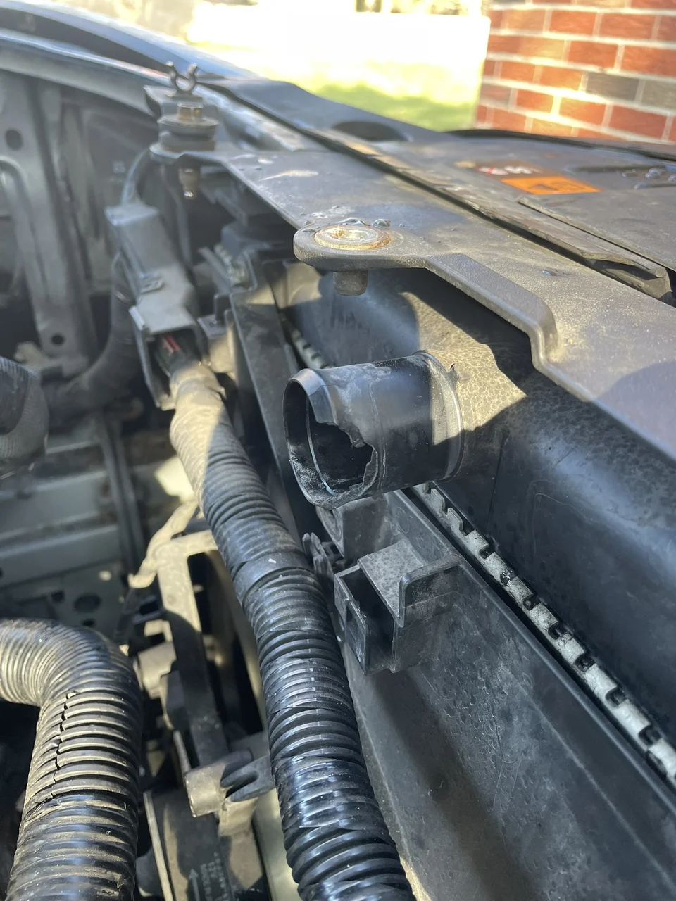

Radiator -- Dang plastic neck broke when I was loosening the hose. And hose tore!

Also, be careful out there if you're using pliers to grip and rotate stuck hoses on old, brittle plastic!
Bummer. Thanks for the heads- up. It's probably going to be real joy replacing the radiator. Plastic. I remember when doing the job on my aforementioned 3800-2, the plastic coolant elbow crumbled and I had to dig pieces out of the lower intake and the connecting belt tensioner bracket that the coolant was routed through.
Good news is the radiator replacement was pretty easy. There are a couple of sneaky clips holding the top posts in. But the instructions are pretty easy.

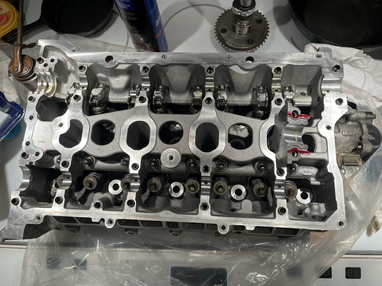

LONG December Update 1: Got the head back from the engine shop. In case anyone is curious it cost $530. That is for pressure check, (to look for cracks) overall inspection, cleaning, valve job, decking, cam journal polish and valve seal replacement. I know I could have probably gotten some Buddy of a Buddy to do a cheaper job, but the shop was clean, professional, and was easy to work with. So I'm ok with it. Happy to know I have a good solid head.
Also! I had a great idea, and just contacted Permatex Product support to ask about RTV and recommended temperatures. They said that RTV can be applied at any temperature, the cold will just require a longer cure time. Which is fine. I can let it set as long as needed. Planning for maybe a week.
So now time for re-assembly! Since the head was out of the way, I went ahead and installed the new water pump, replaced the water pipe o-ring.

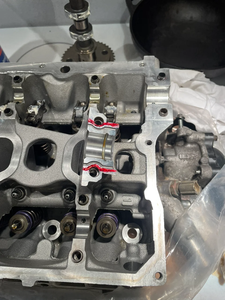

Next, I had an issue that was bugging me: the workshop manual says that when re-assembling the head, that you need to apply some Loctite "962T" on the cam journal #6 on the exhaust side. One problem, they don't make 962T anymore. After a lot of searching I found a published update on the NHTSA site that says Loctite 518 can be used instead. Link to Article
Since my wife is out of town, I took the opportunity to bring the head inside and go ahead and install the exhaust cam inside, off the vehicle and apply the Loctite adhesive. Thought this would be easier, and give the loctite the best chance to set up. The exhaust cam can be installed and you'll still be able to get to the head bolts. (Except one that is under Exhaust Cam cap #1, no biggie) Just a note, this isn't the normal "Red Loctite" you see everywhere. It is a different product. Kind of sucks that it cost $25 for a tube when I only need bout 2 inches of bead. But oh well.

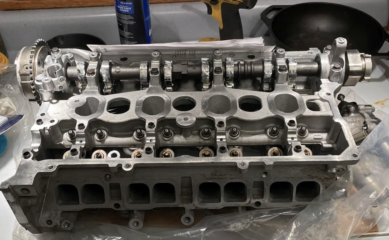

Took my time, lubed everything up per instructions and carefully torqued in phases. To end the night I installed the new head gasket and just placed the head back on the engine block. Will continue with assembly over the next two days. We're going to have a heat wave and temps will get up to 40! Hope to get the timing components and front cover back in place by end of the night Wed.
Oh, and another note, when you are re-installing the HLA lifters, the manual shows that you need to insert them in an oil bath to remove trapped air. I don't think the instructions are super clear. Here's how I would word what you need to do: Submerge the HLA in the oil bath vertically, resting the bottom of the HLA on the bottom of the container. With one hand, press down on the top of the HLA to depress (or compress) the plunger insert, With the other hand, lightly press in with your 1mm metal rod (I carefully used an upside-down drill bit) to depress the metal check-ball inside. You will NOT feel much movement. Try to do these two actions together until the plunger top feels bottomed out. Then first remove the 1mm metal rod to allow the check ball to return to its normal state, and then allow the plunger to rise. Remove the HLA from the oil bath and check that you can no-longer depress the plunger top. If you can a bit, repeat the procedure until you can't. If you are unable to stop the plunger from being able to be compressed outside of the bath, you've got a bad HLA, or the metal check ball might be having an issue seating itself correctly inside the HLA. Replace it.
