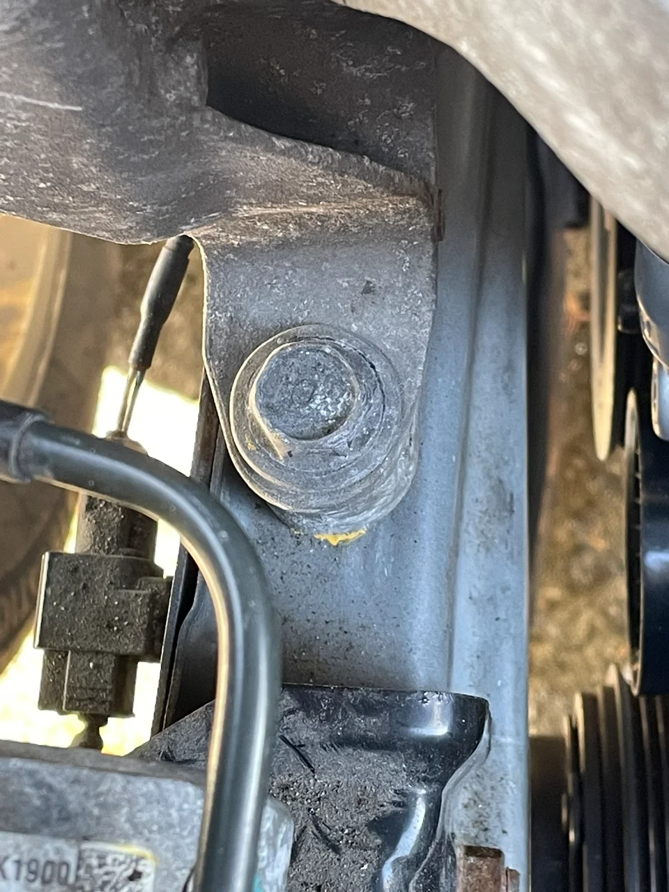

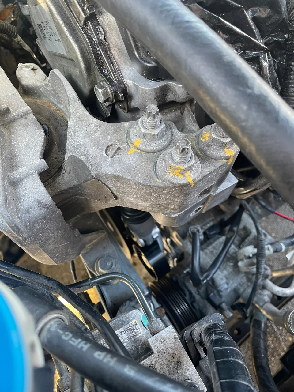

It's been too darn cold to work outside this week! Got a little done last night. Installed a new belt tensioner, water pump pully and the the crank pulley. There was no way I was going to be able to get a torque wrench on that water pump pulley, so I just used the old elbow torque setting. Last thing was re-installing the engine mount so I can work on the oil pan today.
I will just make a note for anyone else working on the engine mount, I did review the instructions before removal, but I don't think the diagrams were that clear. They are VERY adamant that the mount is precisely positioned and it MUST go back exactly to the previous spot or else the engine is going to vibrate and cause havoc! So I used a paint marker and marked where the mounting nuts were positioned on the mount. This ended up being helpful for re-torqueing the nuts, but not what they wanted. You are supposed to mark around the base of the mounting legs on the frame so the legs go back into their original spot. Luckily for me with 300K miles of dirt on the frame I was able to see and then mark the outline of the mount legs with it removed. But word to the wise, do this before removal!

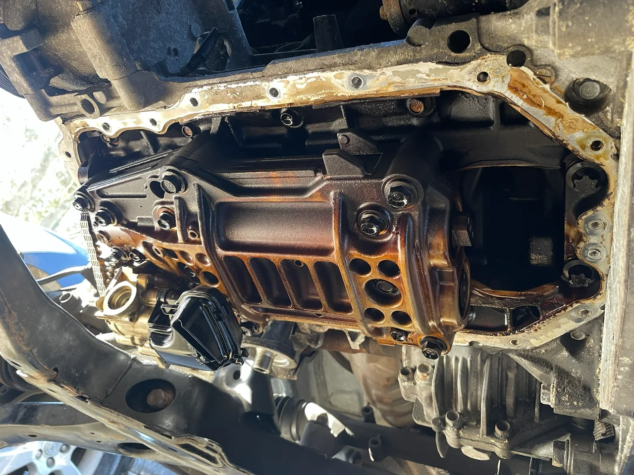

Thanks for the replies. Today's tasks while the sun was out was dropping, cleaning and reinstalling the oil pan. Happy to report no chunks or glitter in the oil pan. Also nothing in the the pick-up screen. Everything got a good cleaning and a re-install. This evening I got the oil shower pipes, OCV and valve cover installed. Small incremental progress! I'm off until after the new year, so I'm hopping to get it buttoned up and started up here in the coming week. Fingers crossed that I don't have fluids leaking everywhere!
Oh, and yes the transmission miles were 90% highway, and knowing my lead footed wife, probably all over 75 mph. So no, not a lot of shifting I would guess. I don't plan to service the transmission anytime soon. Maybe when the weather gets warmer, if the engine repairs I made are holding up.
For today's enjoyment, a look at the bottom end without the pan on.
