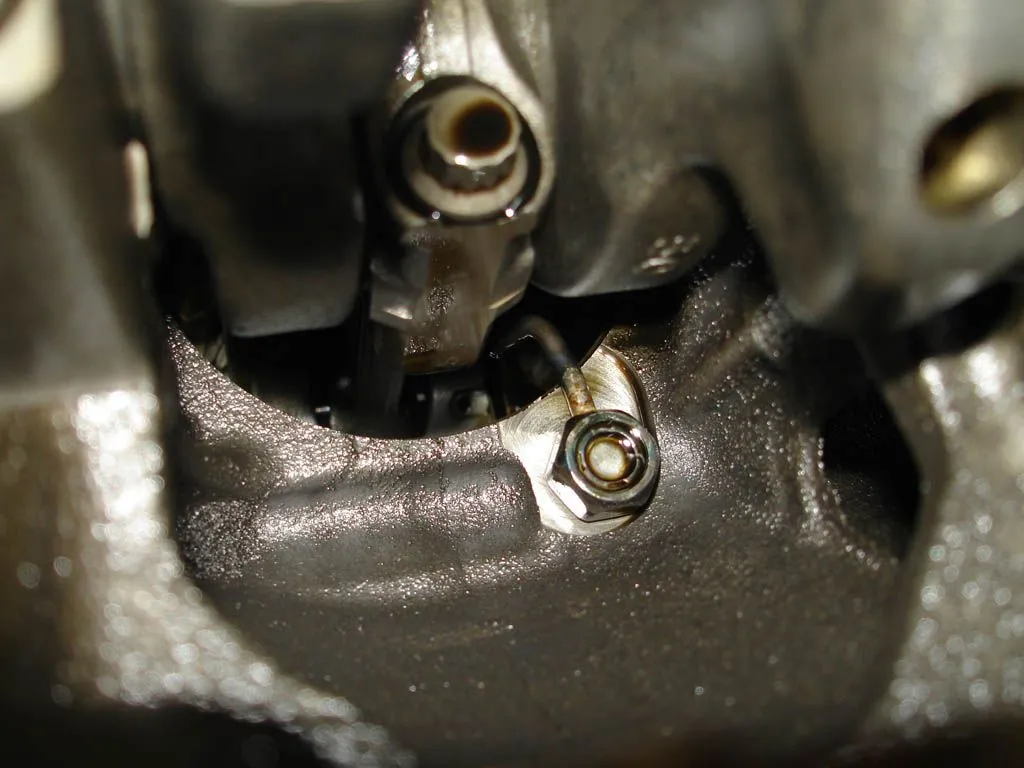

JDM Sam said:
They don't contact the tip. If they did you have the squirter aimed right at the piston crown base.
So where exactly are they hitting? Use pic below if you can. I just went out to my engine and pulled it through, and I could only see them hitting o nthe tip of the squirter. That's on stock pistons though.
