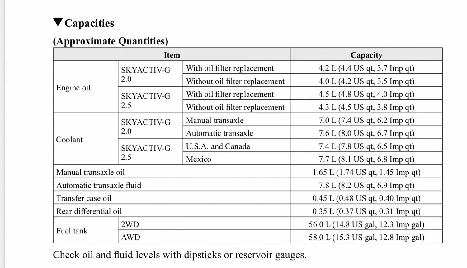

Based on capacity specs the capacity of the OEM oil filter is 0.2 L / 0.2~0.3 US quart. So you used 5.2 quarts on 2.5L and 5.0 quarts of oil on 2.0L to reach the Full mark on dipstick for your oil change.

Just for clarification, I believe you have a 2.0L on your 2016.5 CX-5 Sport 6MT, and the specified oil capacity with oil change is 4.4 quarts, and you put in about 0.2 + 4.75 = 4.95 quarts to get to the Max mark of the dipstick.

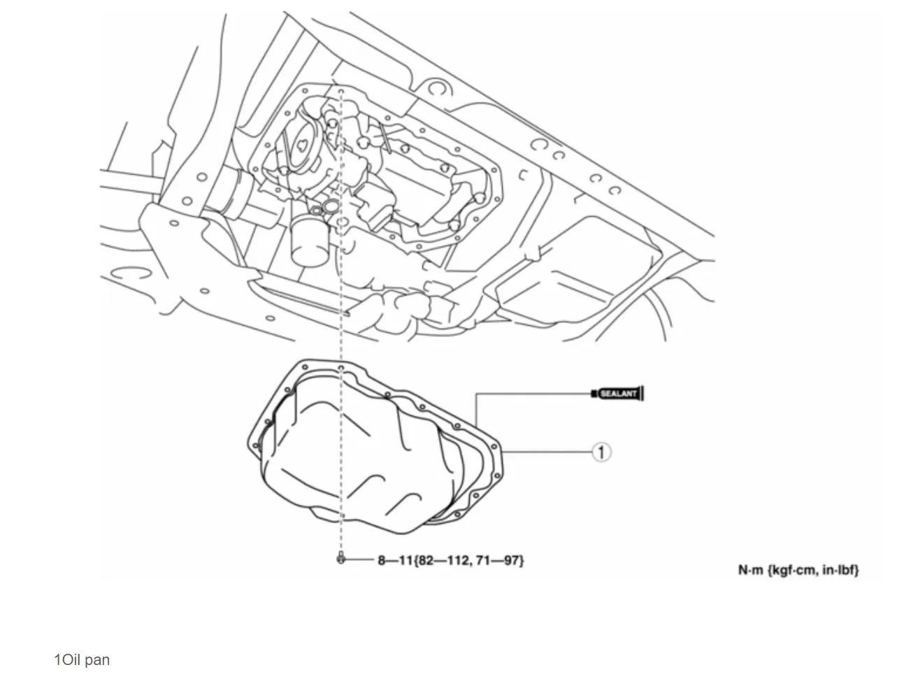

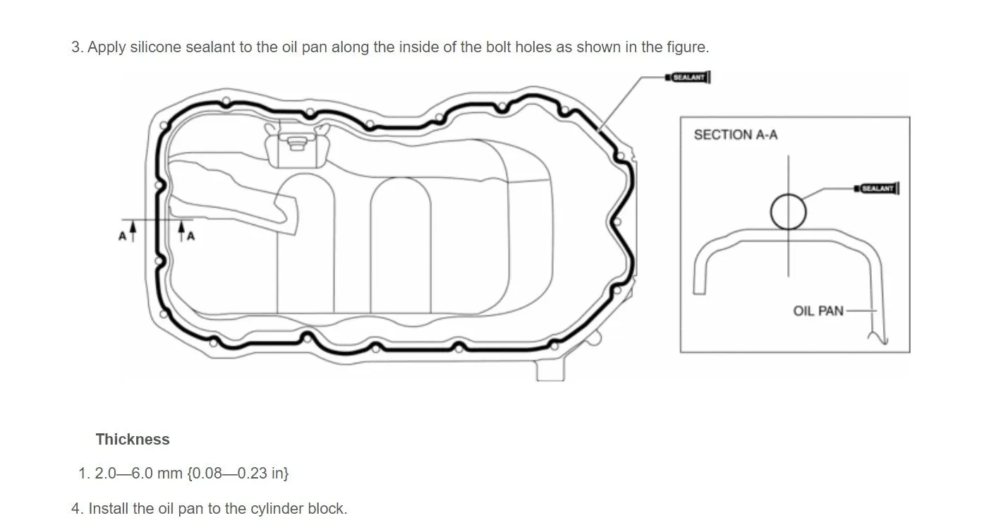

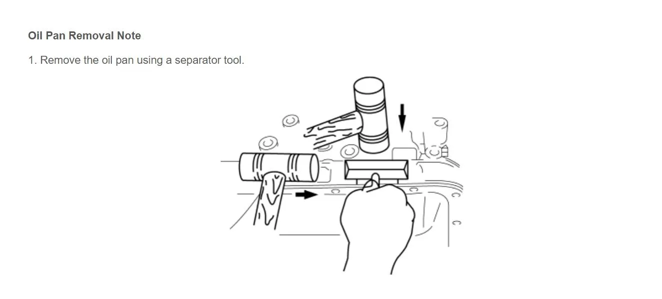

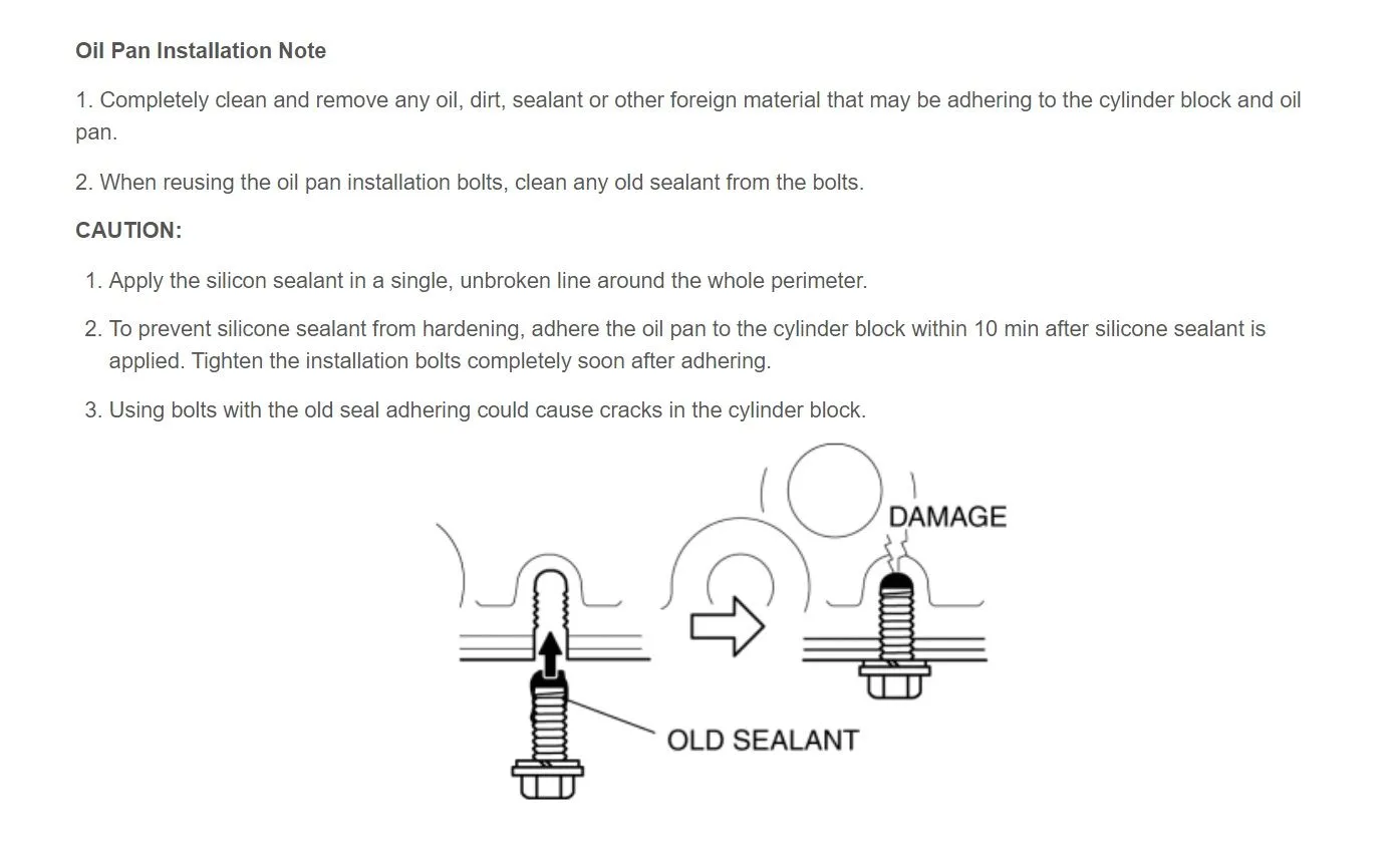

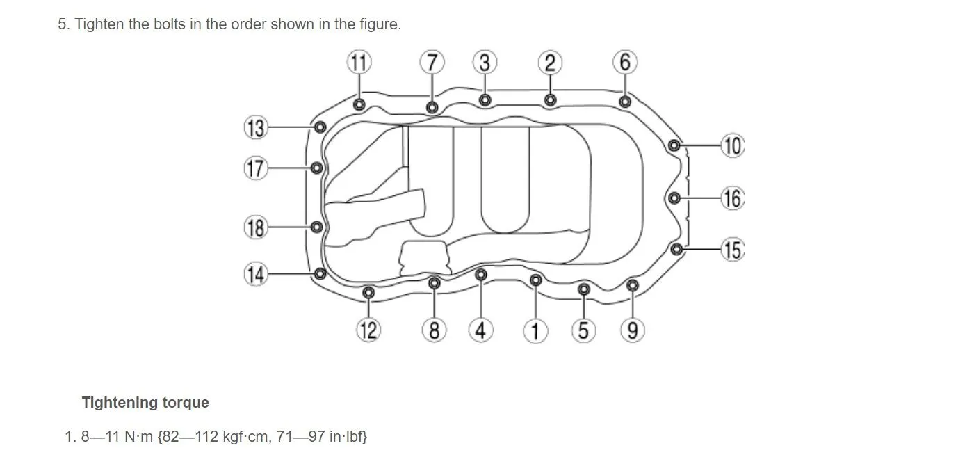

If you haven't seen any oil dripping down to the floor, your oil leak can't be too severe. How much oil did you see on the belly pan? Most oil consumed should be burned. Like Mazdiod2 said, there're more possible oil leak locations than just the oil pan. I'd try to re-torque the bolts on oil pan in proper sequence before trying to re-apply silicon sealant on the oil pan as I believe those bolts most likely are loose. This's something you can do by investing a cheap ¼ torque wrench (74 ~ 97 in-lbf) from Harbor Freight Tools and DIY. Switching to High Mileage 5W-30 oil is also recommended.

Thanks for those spec Yrwei. I do have a torque wrench from Harbor Freight. I used it for spark plugs but also use it to properly torque drain plugs (oil, transmission).
I have been using 5w30, but hadn't tried high mileage version. Since I already bought the oil, will try that next go around.
Shop already redid the pan/gasket. So I guess we'll see going forward what happens.
I'll be monitoring more closely now and am going to check those bolts for proper torque when I pick my car up today.
I’d be careful using a torque wrench suitable for oil drain bolts on oil pan bolts. At best, you’ll be near the lower limit of the torque range where accuracy is poor. To cover most automotive tasks, you really need three torque wrenches.
- Mark
- Mark
Checked specs on those $11.99 (Black Friday sale price) torque wrenches from Harbor Freight Tools. ⅜” torque wrench provides a range from 5 ~ 80 ft-lbs. and ¼” torque wrench provides a range from 20 ~ 200 in-lbs. The torque on oil pan bolt is 74 ~ 97 in-lbf (6.2 ~ 8.1 ft-lbf) which is within the range of HFT’s ⅜” torque wrench. It’s indeed near the lower limit of the ⅜” torque wrench. I agree using a ¼” torque wrench is advised for oil pan bolts because it’s easy to over-torque the oil pan bolts with ⅜” torque wrench which may cross the thread or damage the cylinder block.
