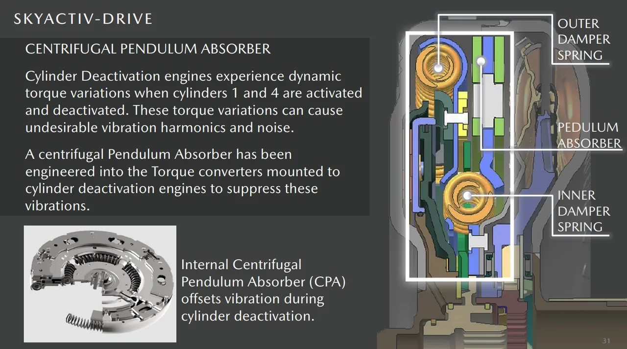

What I mean is, several things happen with cylinder deactivation. I don't believe you can just remove a solenoid and be done with it. You still have the computer instructing the pendulum damper to activate at specific timing, and potentially tuning changes that we aren't aware of. To really know that each thing is prevented would take some diagnostic work.
Believe me, disconnecting one solenoid only turns off cylinder deactivation. The tuner performed the diagnostics. Your fear is unnecessary. Deactivated cylinders destroy the engine.
Something to keep in mind is that there is no control over the pendulum, it is always shifting around each rotation of the converter and functions similarly to a dual mass flywheel.

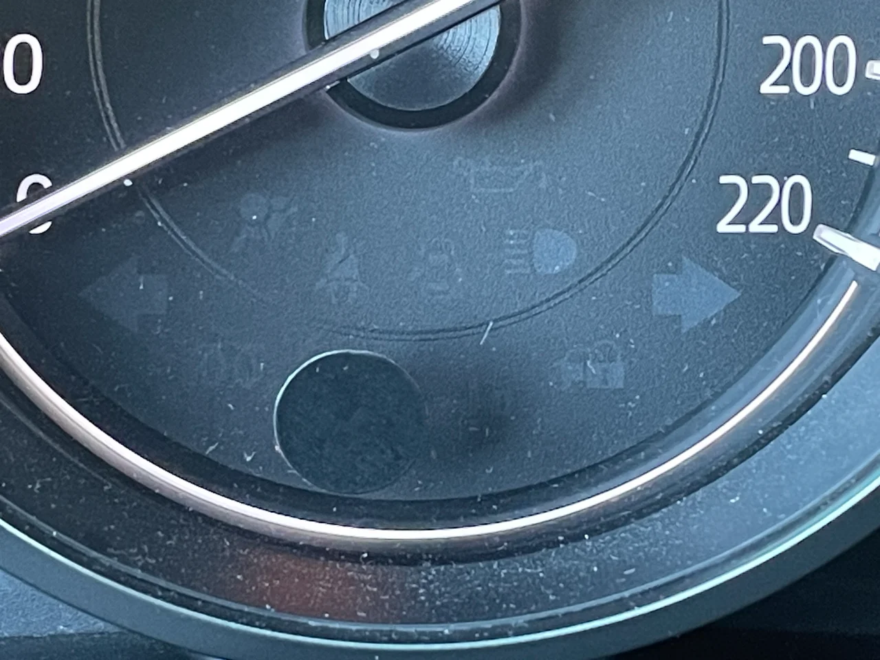

You can tape over the indicator light.
